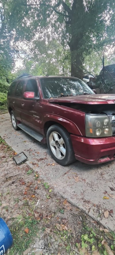

This past weekend I saved a 2003 Cadillac Escalade from being scrapped.
It did cost me a lot because I bought it from the scrap guy. He was going to part it out.
But I had to save it because it's one of the cleanest Escalade I have seen. And 0 rust,
The guy just told me that the engine had a skip. After checking it out for a couple of days, I managed to pull a code p0300 which is random misfire
Which is about 5 cylinders that have misfire when its running.
Today I checked fuel pressure and it's at 49-50 psi with the engine running, is that normal or does it need to be higher

It's ,2003 Cadillac Escalade with 256,000 miles 2WD 5.3 engine vin "T"
I bought it because I have a GMC Yukon Denali with a 6.0 that has a rusty body and frame, but If this 5.3 is repairable I can keep it.
Misfiring cylinders are.
2, 6, 7 and 8

How much is "alot"? Which cylinders are misfiring? Do a compression check of all cylinders. And like said before, which engine?(8th letter of vin). We need pics or it didnt happen!!!!
How much psi compression should It be ok? With vehicle cranking or vehicle running?
