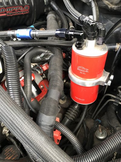

And the final fix. I rerouted some of the lines during the repair so it stays up off the coils. I used some fabric electrical tape to wrap the wire bundle and then split woven loom over that to protect it. 8FA102AB-A49A-47AF-BD68-89A32556B4FA.jpeg

Got it. I found a place on the harness under the hood that was laying on a coil so I used a mirror to look up and saw a worn-off spot with exposed wiring. It was hard to see and even harder to access. There were 2 wires worn through- one was black and one was what looked like it might have been yellow at one point. They both tested as connected in the starter relay socket. According to the schematic the black was ground to the solenoid and one was the crank voltage. I have those wires repaired and it starts right up. Now to put everything back together, just taking a break because my back is killing me. I’ll add some extra protection on the harness as well as tie it back away from the coils.
Well done.
