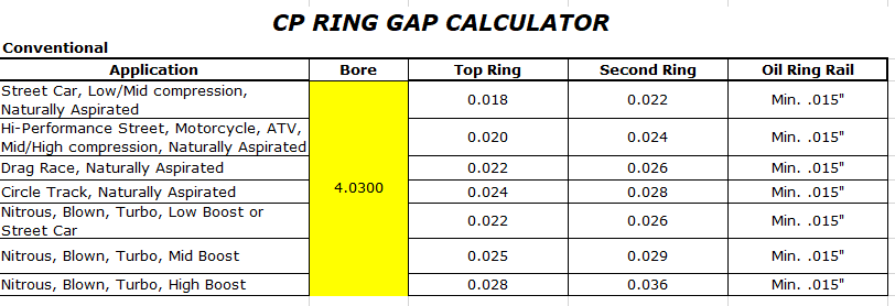

You know what, that might not work for 5.3 pistons. What are the piston diameters?
I’m not sure off the top of my head
I’ve also seen people run 4.8 flat top pistons with boost for people on a budget and it’s held up good
strutaeng
Aug 10, 2023
1,988
4,285
Dallas, Texas
5.3 bore is 3.780" (same as 4.8, but that one has shorter stroke.)
This PDF has pretty good instructions and specs based on bore diameter and application:
Edit: Probably worth printing that PDF for future reference...or at least, I'm going to... :)
Edit 2: https://help.summitracing.com/knowledgebase/article/SR-04734/en-us
