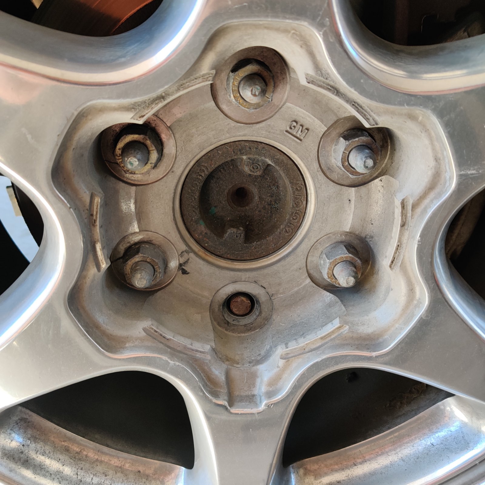

I'll start with a surprise lug stud I had to replace when doing brakes and rotors today!
Found this...
Scary thing is that I think it was probably this way when I got it in January. It drove fine and I checked everything else. I assumed the seller wouldn't let me drive without a lug! I drove my family from Kansas City...to Wyoming and back like this without knowing.

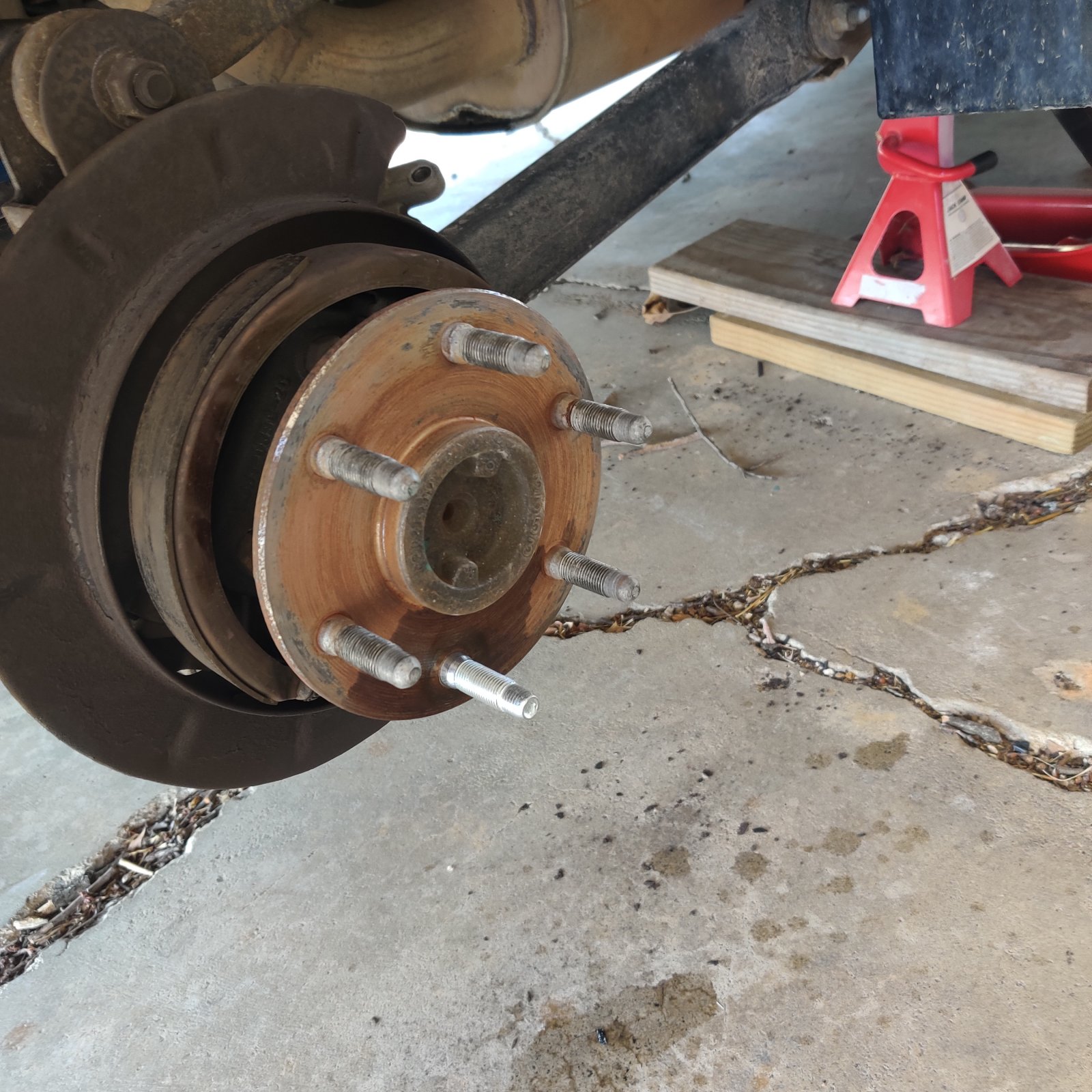

Anyways...I learned how to replace a lug stud today using the following method:
Except I don't have an impact. So I used the old tire iron with the extension tube from my red Daytona jack from harbor freight and cranked that thing in by hand.

so... i'm just wondering, you bought a used vehicle and took it on a family road trip and never bothered to check the brakes first?
the reason I ask is because if the brakes had been checked then the broken lug nut would have been discovered. If not eyeballed beforehand
but those caps hide the fact
