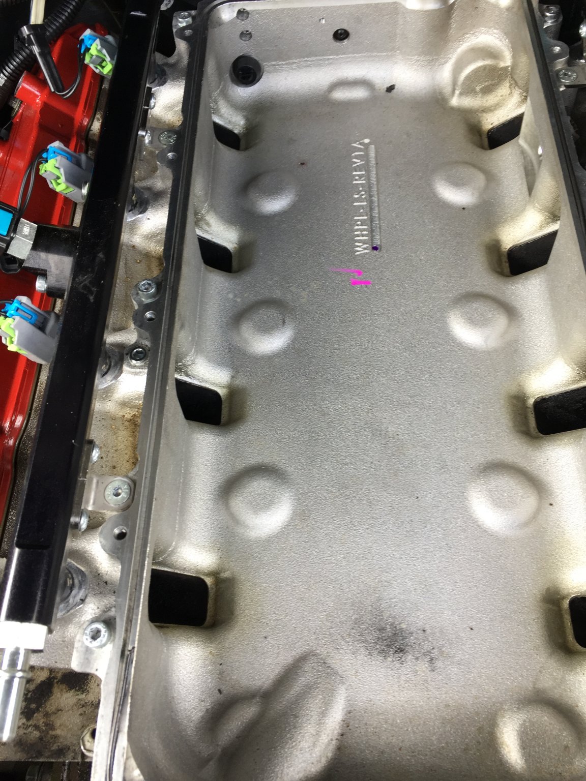

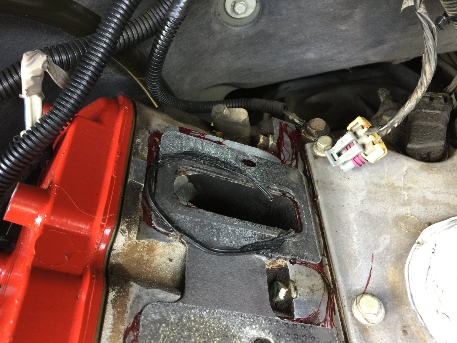

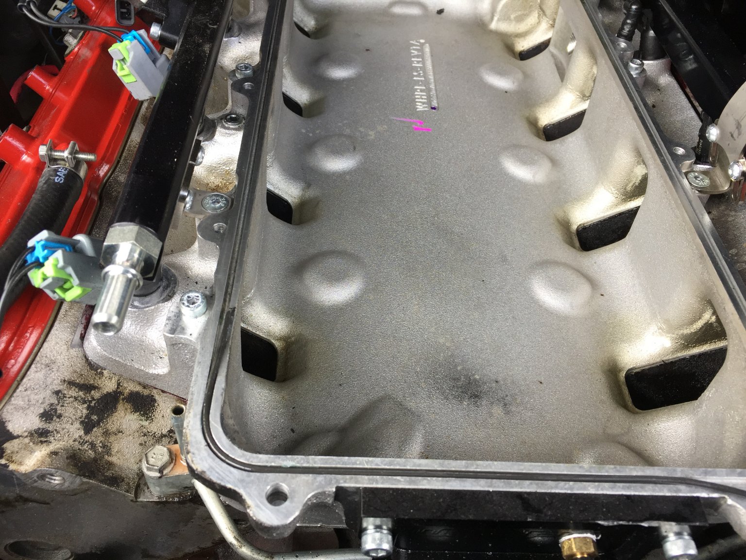

So today I pulled the Whipple to figure out why it had a small intake leak and reinstall with all new gaskets. The last time, which was the second install thanks to missing instructions regarding the included intake manifold gaskets, was a disaster. I had put the gaska-cinch on a wrong surface of the passenger side gasket and had to remove it with a thinner which I believed probably messed up the gasket. As it turns out, it also messed up 2 of the O-Ring gaskets that are in the lower intake manifold where it meets up to the gasket I messed up on. I'm not sure if it dissolved them or what but they were a mess. The large O-Ring that goes between the blower and the lower intake manifold was also half missing. I believe that when I lowered the blower down, which was the second use of that gasket since it was the second install, it somehow slipped out of the groove and then got pinched and was possibly sucked into the intake. Half of it was missing. It was a miracle it was running at all. And weird thing is, I couldn't tell it had a leak. If Justin hadn't told me after looking at a data log, I might have never known except it did throw a lean code at one point. And I won't know if I fixed it until I send Justin another log and he analyzes it. I did get better at the install- complete R&R took me 8 hours today. It's running great so far. Anyway, enjoy these pics. Here's the large O-Ring that's missing half of itself.

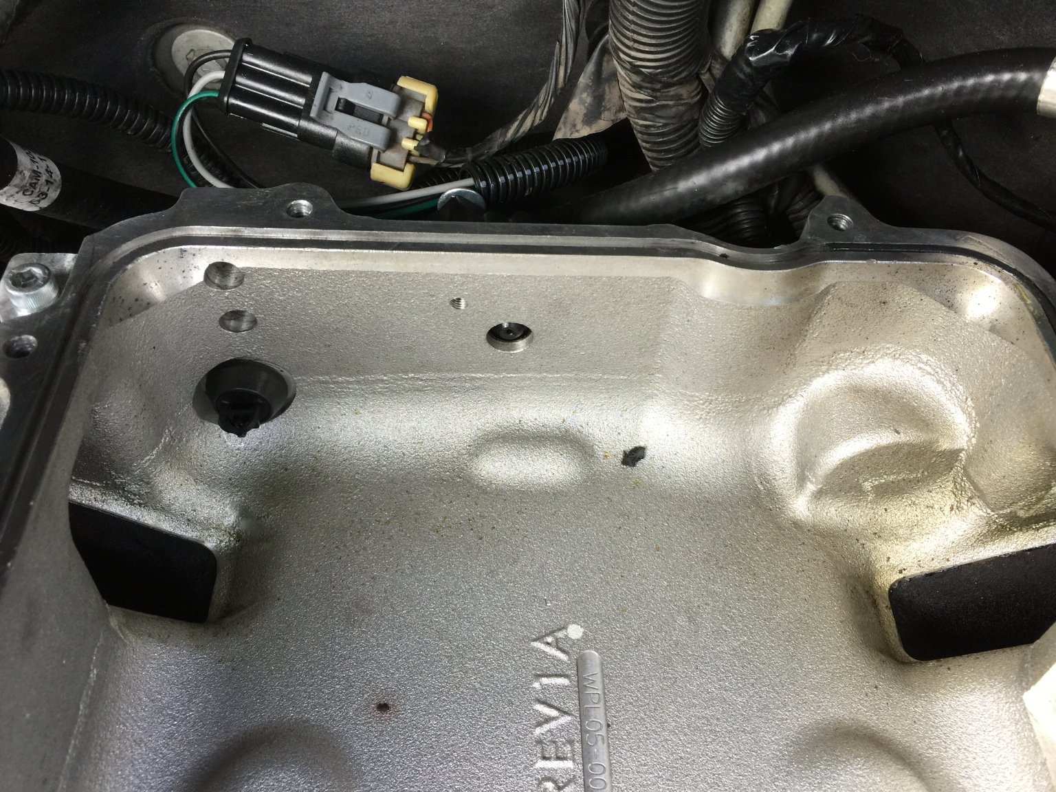

And here's the O-Rings that failed at where the lower intake manifold meets the head. They install into the aluminum lower intake manifold and then seal against the regular intake manifold gasket that I didn't install first time around because there weren't instructions for it. 2 of these on the passenger side were wasted. That's the side I messed up on the gasket.

Ever find that missing piece of gasket? I believe also that the thinner did destroy that rubber o ring gasket.

No never found it. It actually looked like it got pushed back when I lowered the blower in place. If it did, it probably flew out the back of the engine during one of my 100 MPH freeway runs lol. If I remember right, I kinda slipped with the blower when I was lowering it into place. It's a real *****; the intercooler hangs down (and it's fragile - don't want to bang it on anything) and the firewall is in the way. And you have to lower the heavy ass blower onto that thin O-Ring which requires the use of a bit of grease at a front corner or it wants to pop out. It's hard. I'm pretty confident all went well this time. I mean, when I tore it out after my first install, all the O-ring gaskets were in place and good shape, good enough that I re-use them. But that might also be part of the problem. They probably should have been replaced. They were this time.

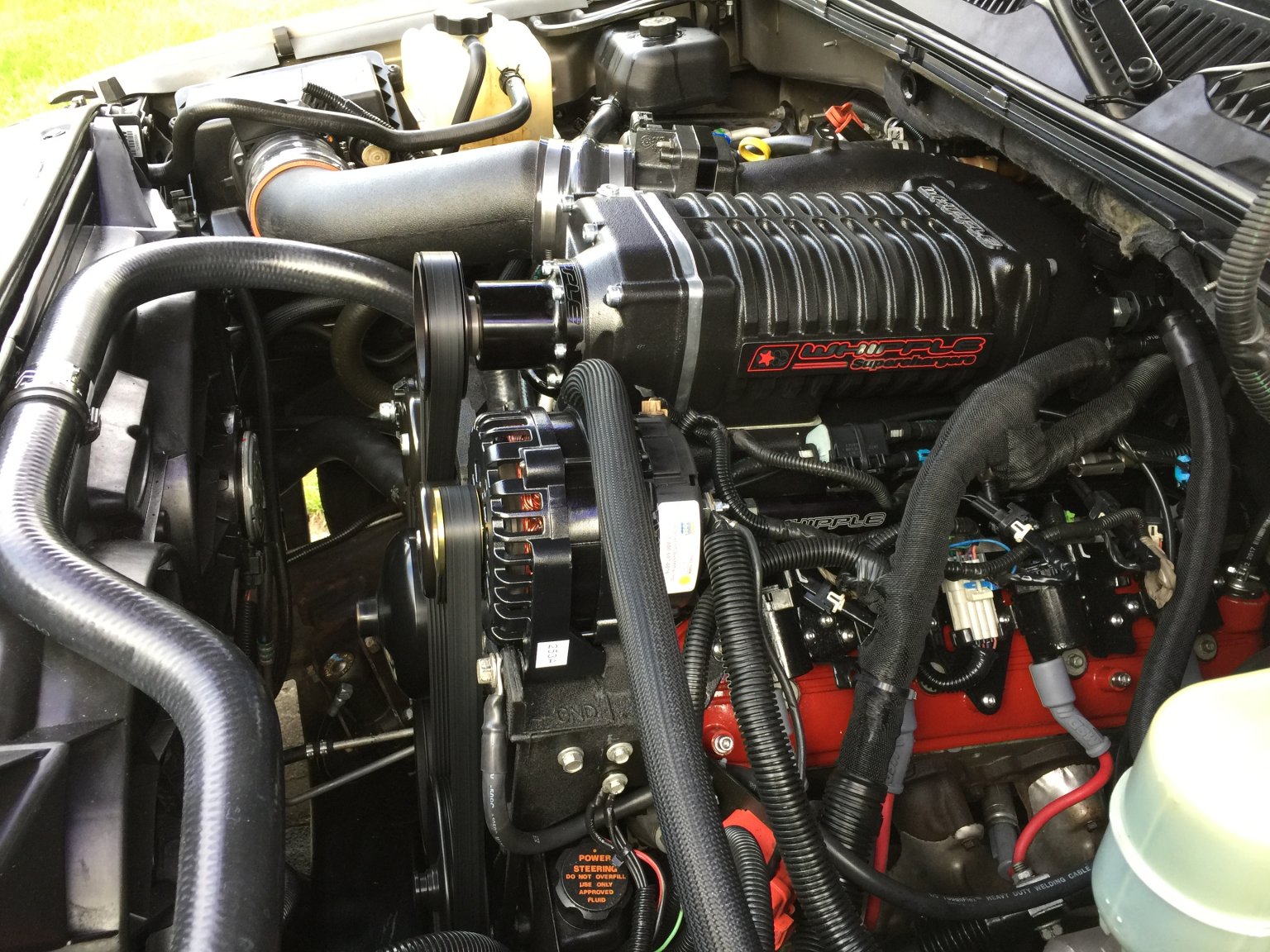

I hope everything goes well with it. Keeping my fingers crossed for ya!
93blkongreenpro
Feb 9, 2016
1,388
1,358
Thst engine bay looks good with the fresh paint and the color scheme!
