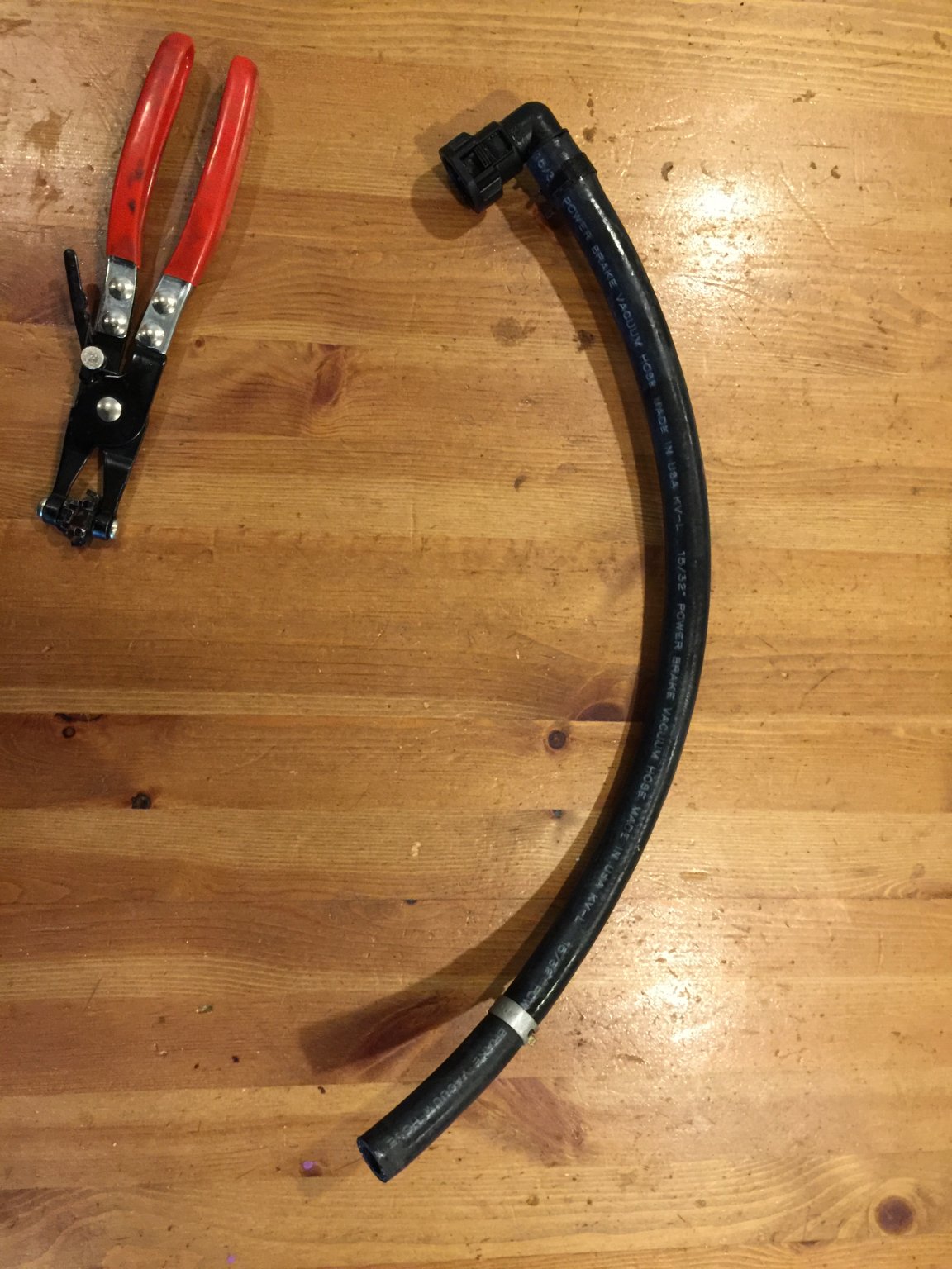

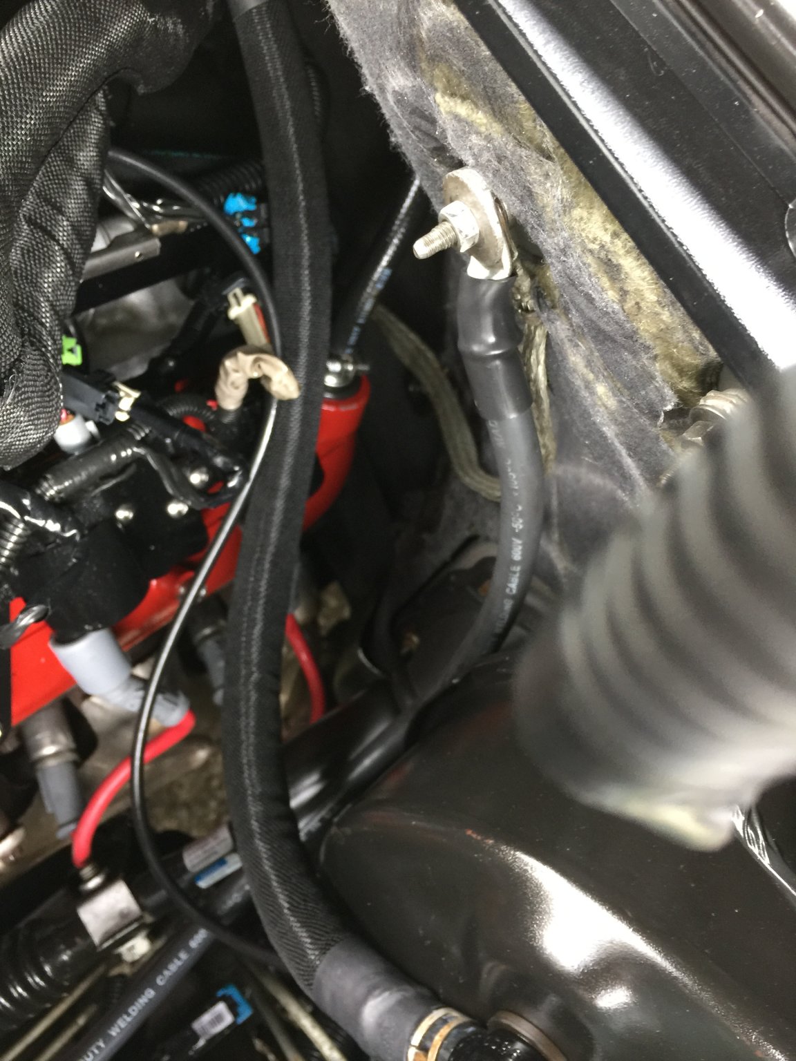

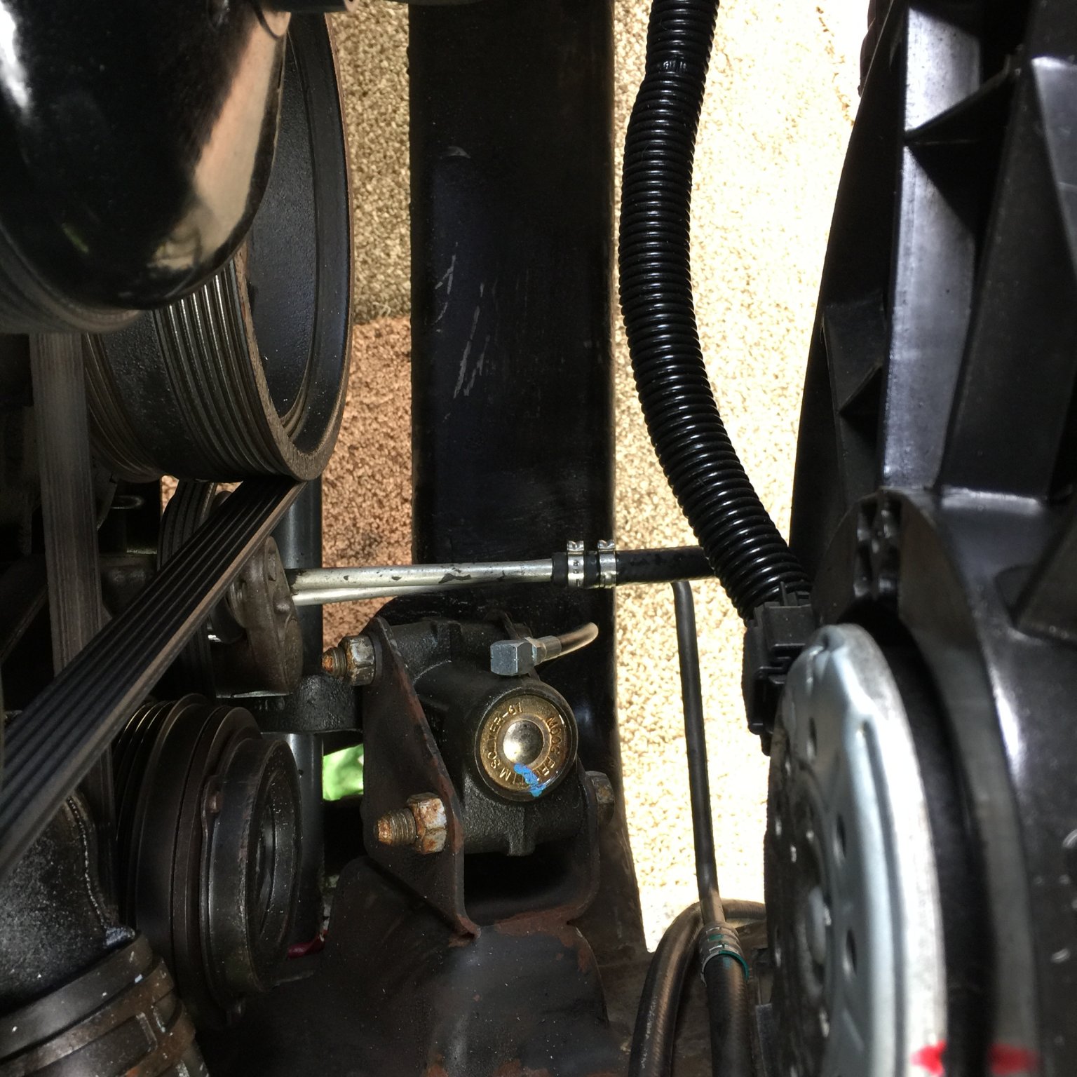

I couldn't stand the patch on the trans cooler line, especially because it was right at the bottom of the radiator area so every time I opened the hood and looked down, there it was with it's 4 hose clamps. I'd already replaced that line before and I knew it was hard to do, but I'd also learned since then that reinstalling it was easier if you put the spring clip into the quick connect and then push the line in until it clicks. The place where it connects into the side of the trans is almost impossible to get your hand in, and last time I had to push in on the line while I put the clip on. It was still hard but not nearly impossible like last time. Then after I got that done, I replaced the other hose clamps with PEX plumbing clamps that I had left over from some home plumbing projects. The 1/2" fittings worked perfect on the 3/8" hose and look way better than hose clamps. Then I decided to wrap my brake booster hose in braided sleeve and used heat shrink at the ends to keep it tidy. Just some little things but everything makes it look a bit better. I have more braided sleeve so I'll probably do more of that under the hood.
