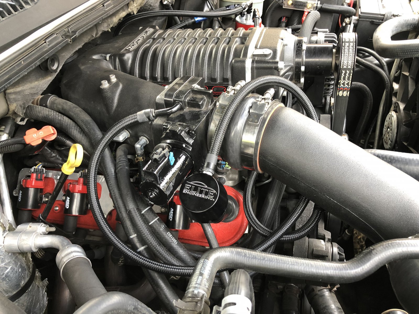

Wtf is it? The CSS needs to hook to that hose that’s going from the valve cover to the TB. Route the hose from the TB to the CSS and plug the nipple on the valve cover. That’s where oily vapor enters the TB when there’s no vacuum at WOT which is where most of @Tonyrodz spends his time from what I hear lmao.

Today the -6 black braided stainless line came in so I replaced the rubber one on the CSS. Now I have some left over since I ordered 8 feet. Wonder which one I can replace next? I’d like to end up with all black braided lines but that might be impossible.
Sam Harris
Sep 26, 2018
7,443
14,966
Texas
View attachment 231067 Today the -6 black braided stainless line came in so I replaced the rubber one on the CSS. Now I have some left over since I ordered 8 feet. Wonder which one I can replace next? I’d like to end up with all black braided lines but that might be impossible.
I wish my engine bay looked half as good as yours.. [emoji41]

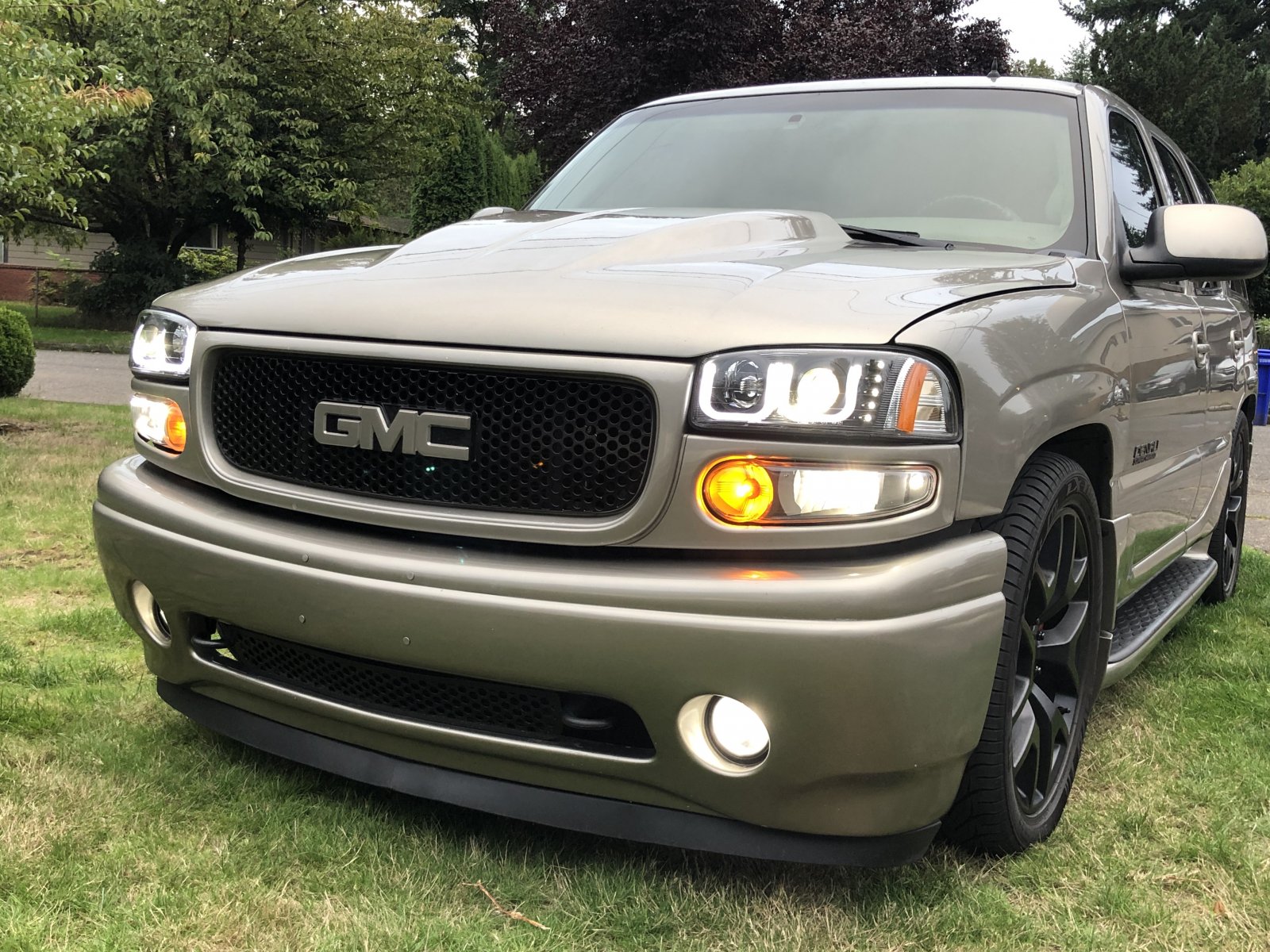

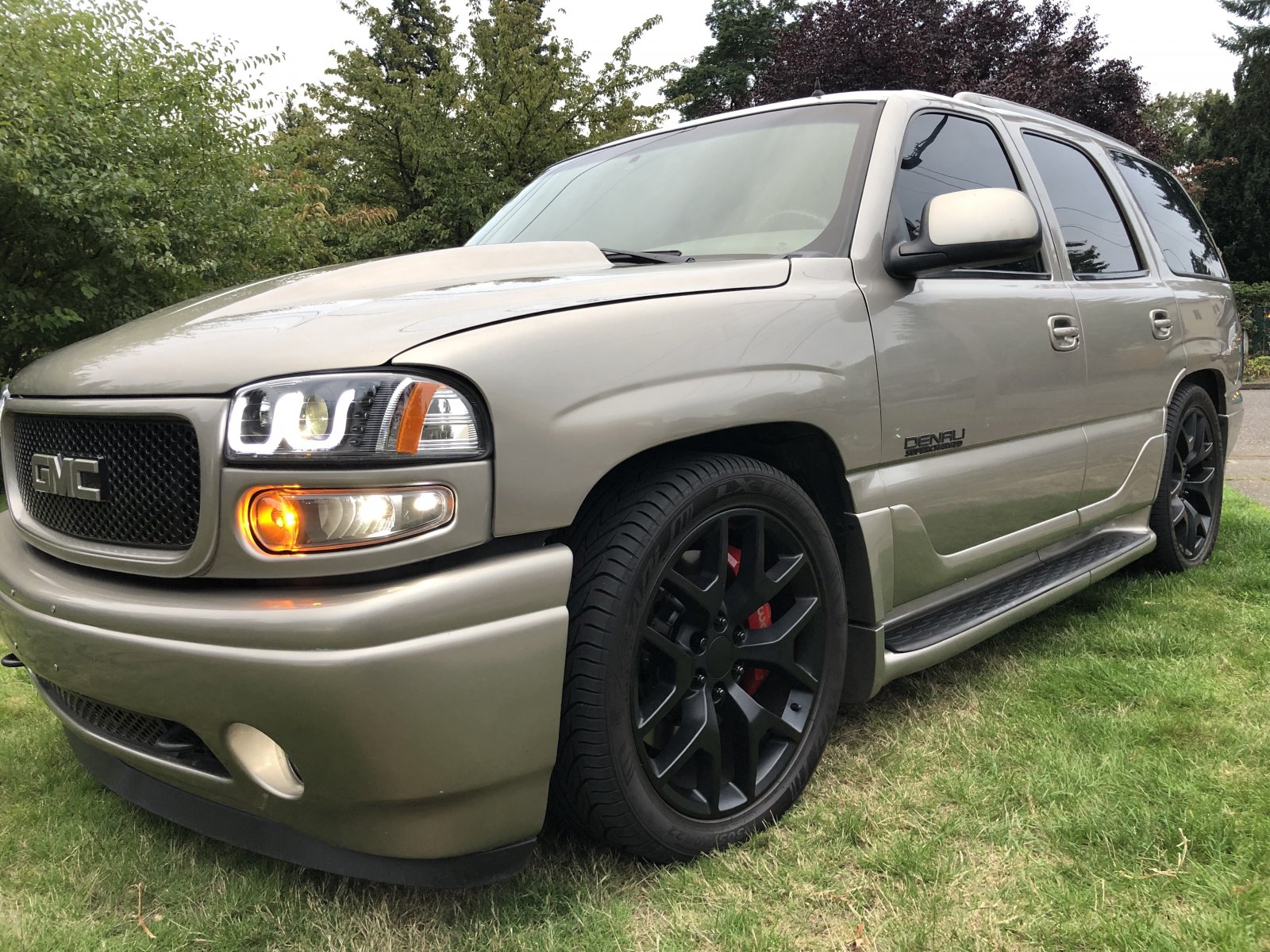

Today I washed it and applied a brand new product from Chemical Guys called Hydroslick Ceramic Coating Hyperwax. It’s supposed to be a ceramic coating that is in gel form and just wipes on and then buffs off. It has no wax. It has no Carnuba. It’s supposed to be a whole new category. I can say one thing- it’s a PIA to apply since it’s pretty much invisible as it goes on. It leaves no haze so you can’t tell if you missed a spot when its time to buff it off. Supposedly it lasts 6 months to a year.
Sam Harris
Sep 26, 2018
7,443
14,966
Texas
Today I washed it and applied a brand new product from Chemical Guys called Hydroslick Ceramic Coating Hyperwax. It’s supposed to be a ceramic coating that is in gel form and just wipes on and then buffs off. It has no wax. It has no Carnuba. It’s supposed to be a whole new category. I can say one thing- it’s a PIA to apply since it’s pretty much invisible as it goes on. It leaves no haze so you can’t tell if you missed a spot when its time to buff it off. Supposedly it lasts 6 months to a year. View attachment 231244View attachment 231245
Looks beautiful as always.
I mean, uh, damn, that non wax, non carnuba wax looks ****** ridiculous!!
