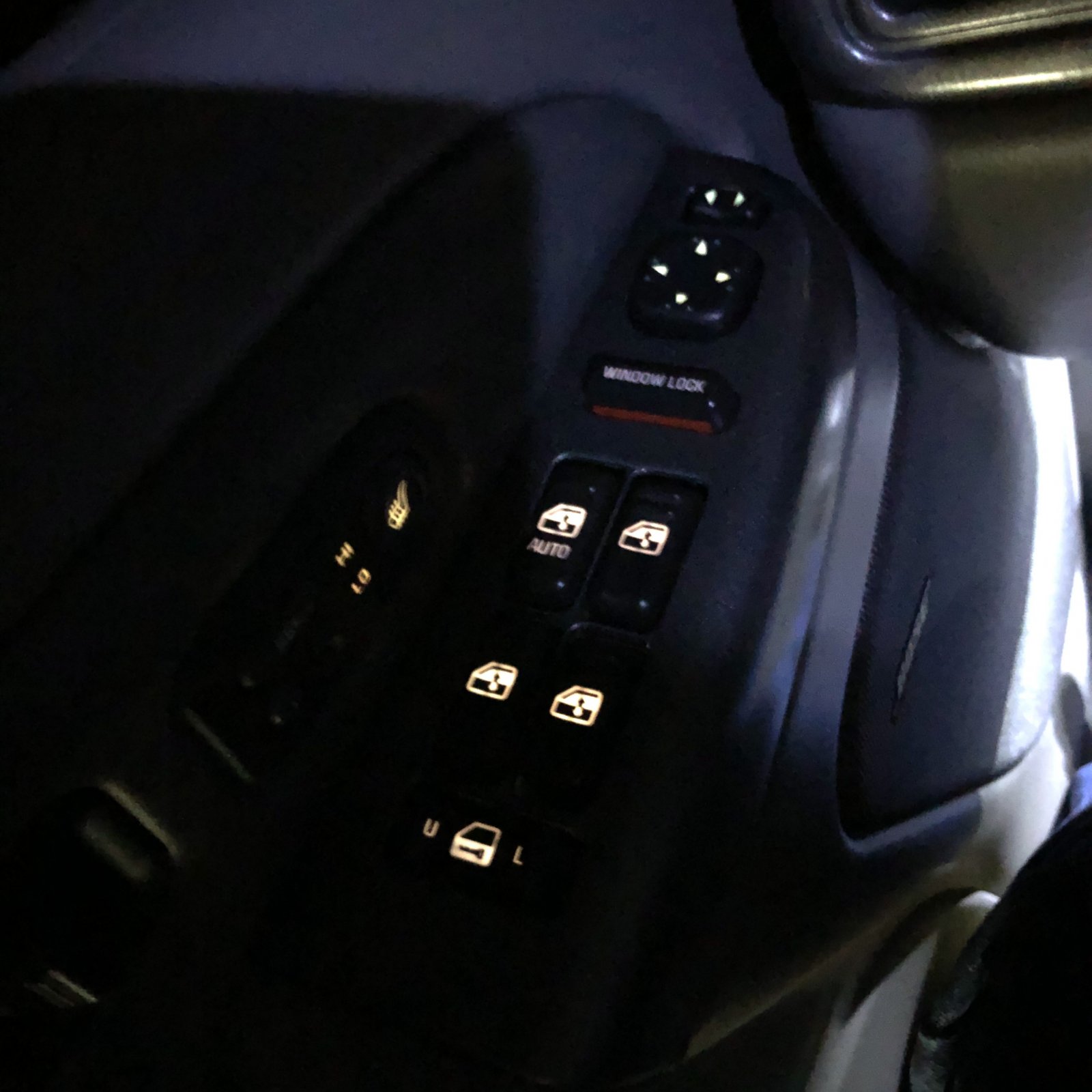

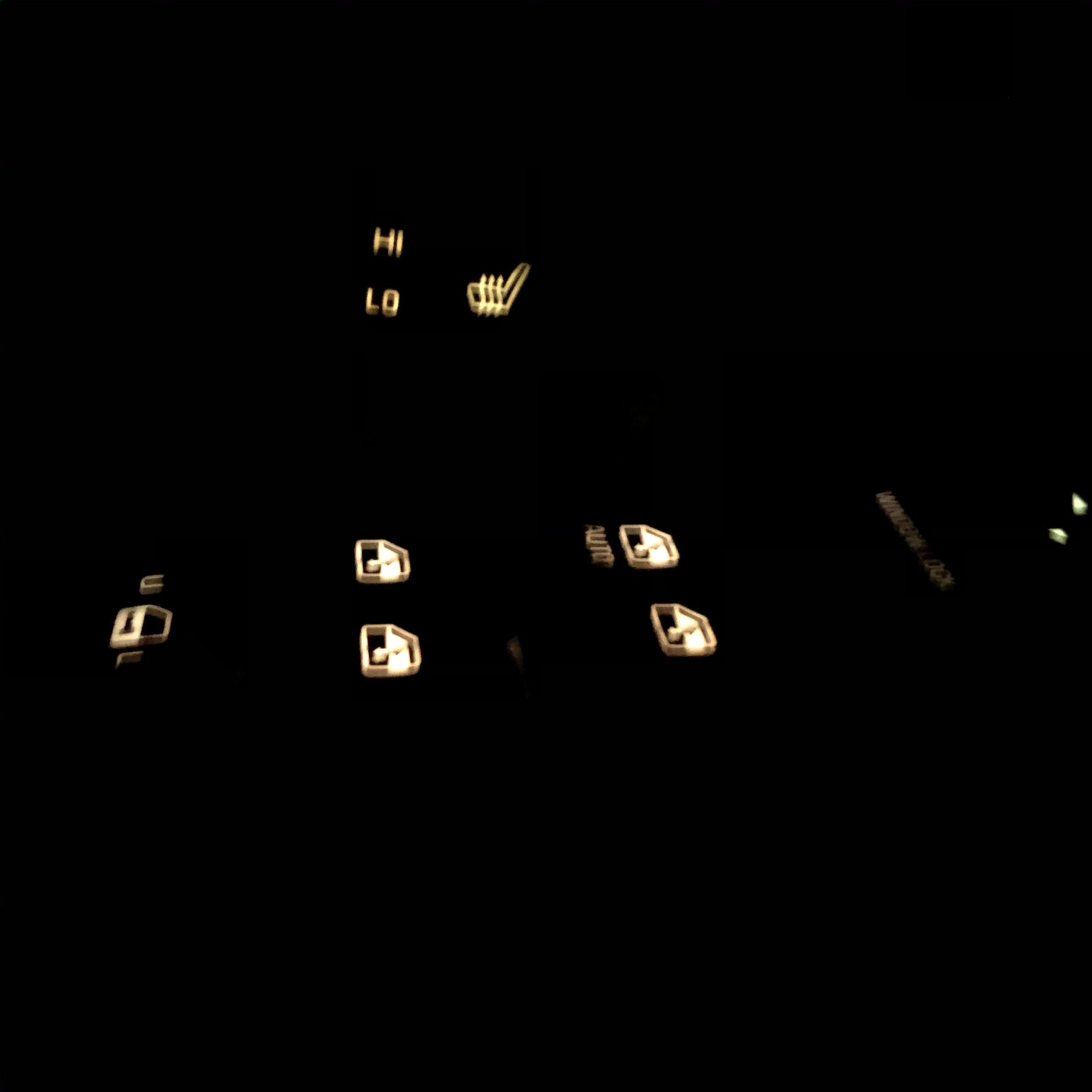

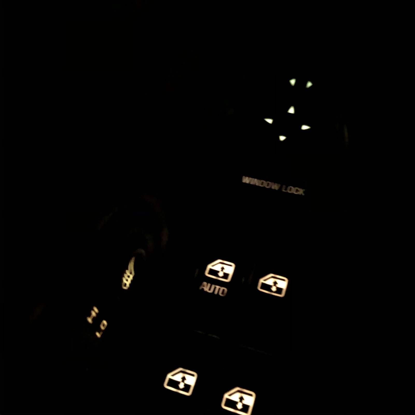

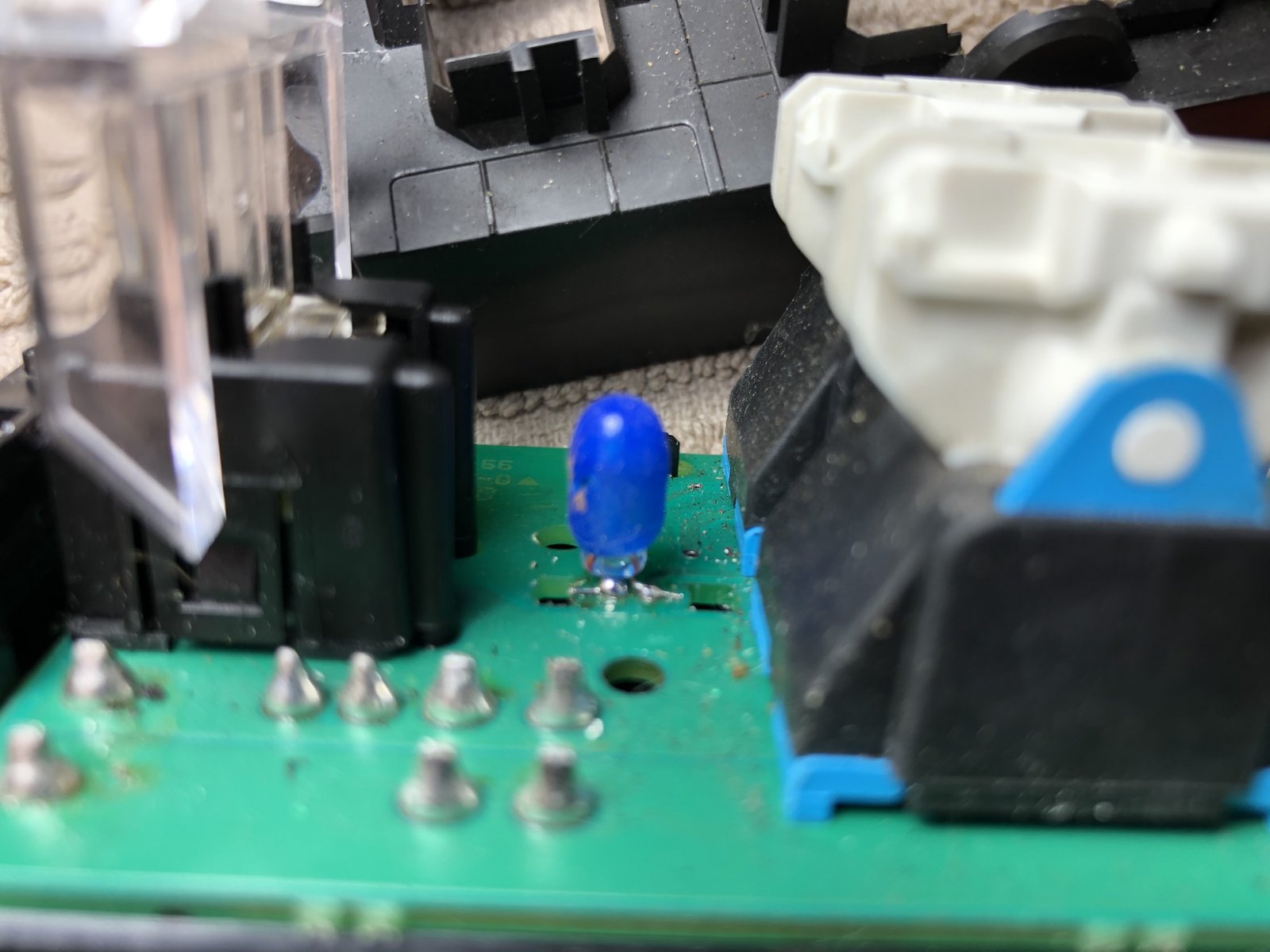

Last week I replaced the incandescent bulbs in the driver switch panels- all 3 panels. And in the secondary DIC which resides under where the cd changer used to be. What a PIA. Such tiny pads to solder to on some of them and no way to get to the back side of the window switch circuit board to do those properly so you have to cut the leads shirt, put an L bend so they run across the pad and solder them from the top. They end up protruding from the board farther

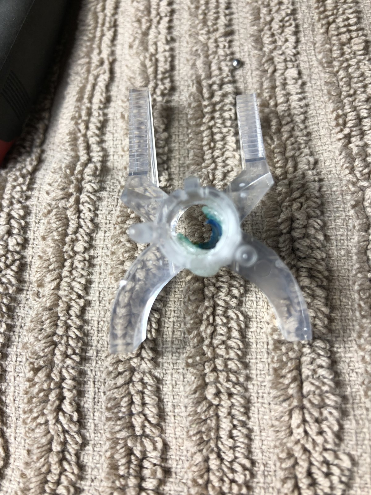

but everything fits back together. Anyway all was well until tonight and the front window switches went dark again. I opened it and found that bulb was melted inside the diffuser. Weird. Not sure what that was about but I had bought spares so I replaced it again. Back in business.
