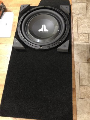

I don’t know of any of those powered subs in those small enclosures that sound good unfortunately. I wish Rodneys Boxes made an enclosure for the NBS like he makes for the NNBS. I put one of his in my 08 Silverado and it hits hard with a 10” down firing JL. It utilizes all available space without interfering with anything. Maybe you can build something.

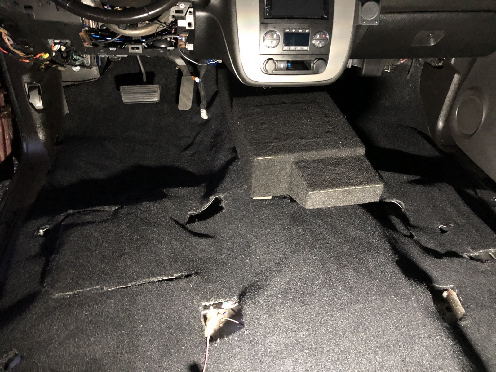

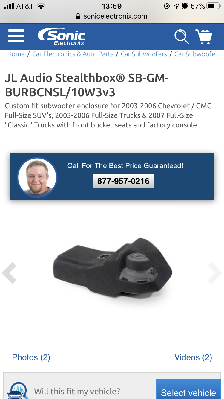

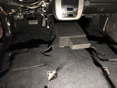

I wonder if the one @Fosscore added to his nbs would work for you? He has a build thread. You can also check it out in the classifieds, as he's selling his Tahoe, but he has all his mods listed.
EDIT--Look in here:
https://www.tahoeyukonforum.com/threads/fosscores-2006-chevrolet-tahoe-ls-4-8l-2wd-for-sale.119198/
Wow Fosscore’a Tahoe is impressive. I see the build specs state that he has a Stealthbox in the console, but I can’t find any posts that show it.
