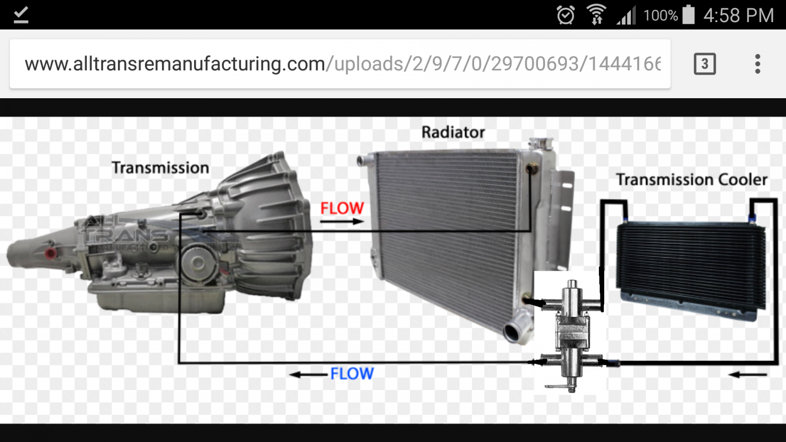

no matter if a new or used trans, I would always install an oil cooler, always pay attention to the installation direction, always in the return to the trans.
ideal is also to integrate a thermostat, as shown in the drawing, so that the trans quickly reaches its operating temperature, but never gets too warm.
as in our experience a temperature of 160 - 175 F is ideal, good working temperature, condensation water cannot form and the oil cannot burn
the additionally drawn thermostat is a "Racimex 50100", which I have installed in all my cars.

That’s interesting considering GM started using thermostats in the new vehicles in order to increase fuel mileage which has resulted in more failures so people are now bypassing these thermostats. When you say “our experience” who are you referring to? I agree 100% with the cooler but not the thermostat unless you live in a very cold climate.

Actually, the oil goes through the radiator first where it heats up along with the engine coolant. There’s a coil inside the factory radiator that’s bathed by the engine coolant. I’d like to know how you would determine if you’re doing harm. Anyway, adding a thermostat isn’t suggested over here unless you’re in the frigid north where it’s frozen for a good part of the winter. Be careful suggesting people do something that may actually shorten the life of their transmission which is the case in the newer vehicles with the factory thermostat, where owners here are deleting them instead of adding them. Here’s a YouTube video that explains the reasoning.

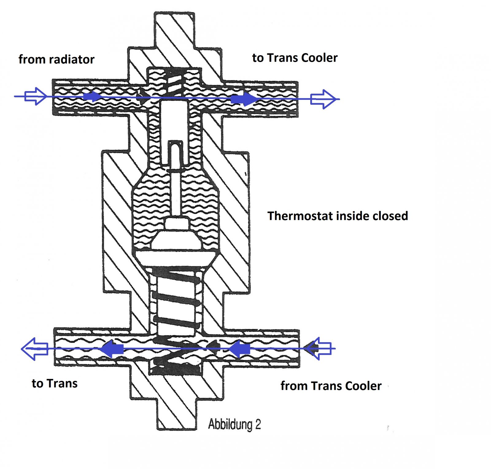

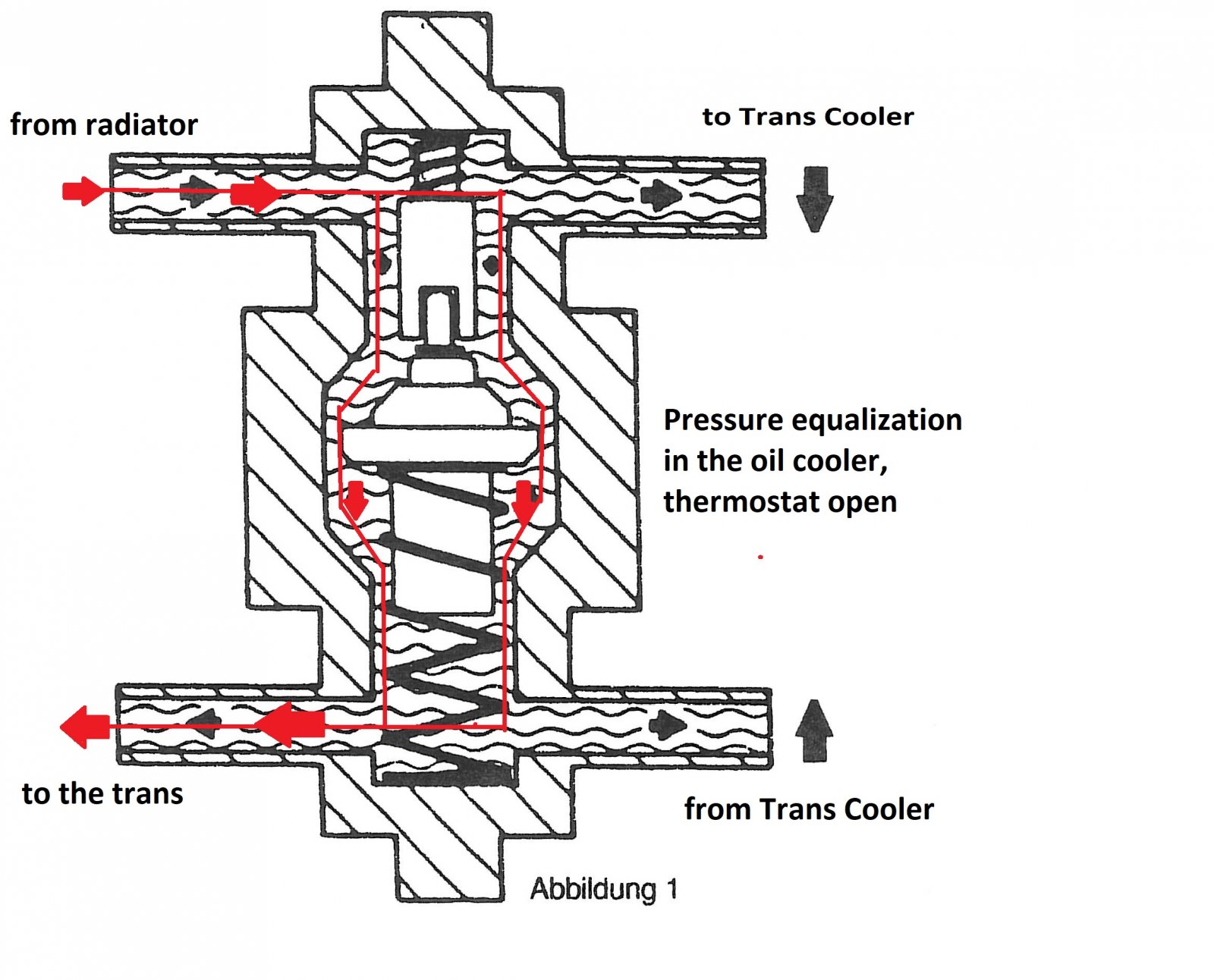

Sorry, I think we have misunderstood something.
The Racimex thermostat does not stop the oil flow, like in your video of the 6L80E, but changes the way the oil flows.
I have created 2 pictures and in picture 1 you can see how the oil flows (red line) when the temperature of the oil is below 167F.
Figure 2 shows the path of the oil (blue line) when the temperature is above 176F.
When the cone valve is open ( picture 1 ), the oil presses through both supply lines to the radiator. Pressure and back pressure cancel each other out and the pressure equalization stops the oil flow through the Trans cooler. The Trans cooler is thus neutralized and the oil flows back to the Trans inside the thermostat.
At 167F the cone valve starts to close and interrupts this standstill. At approx. 176F the cone valve is closed (Fig. 2) and the oil must now flow via the trans cooler back to the trans.
When connecting the hoses, make sure that the radiator/trans hoses are mounted on one side of the thermostat and the hoses to the trans cooler on the other side.
This thermostat is not intended for cold areas, but to protect the trans from overheating when driving with a trailer in warm weather and under load.
And these are our experiences that we made here in Germany and whether this is an option for you, I cannot and do not want to decide, it should only serve as a suggestion how to realize it.

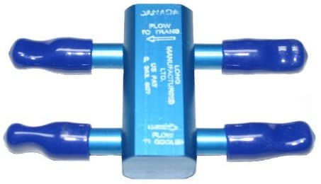

No, I understand. Tru- Cool sells the same thing. It’s intended for cold climates only. We run without a thermostat over here for most of the country.
