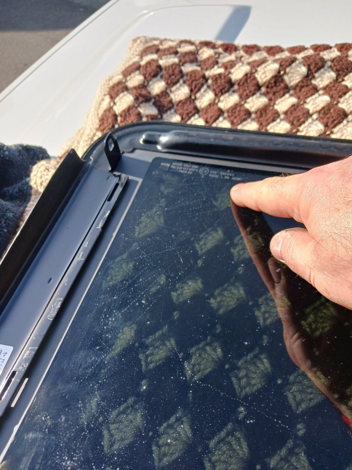

5. Rear of the glass is where the markings are. Also, just in case, glass has 2 plastic "combs" on each side, taller end is towards the rear:

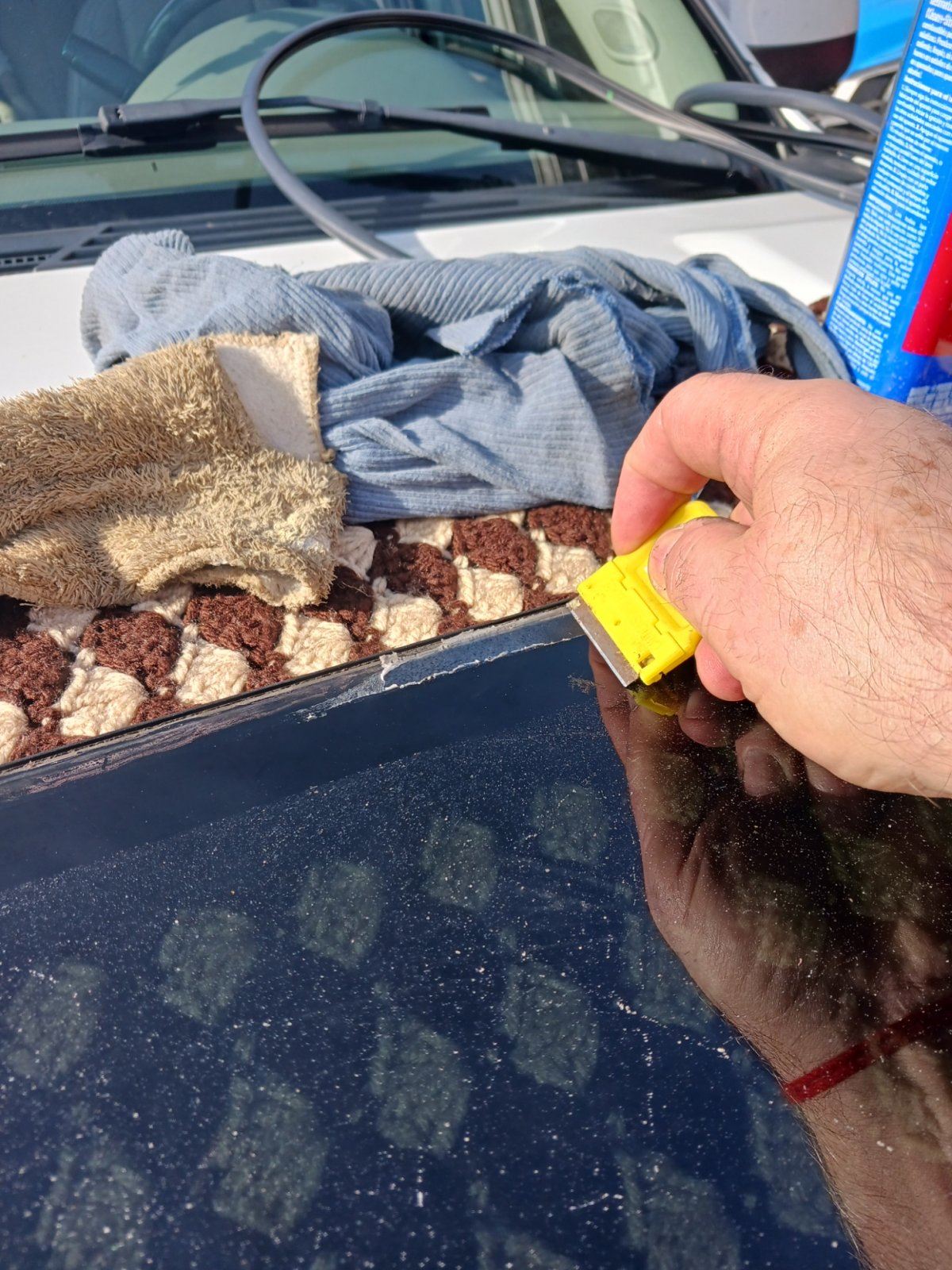

6. Remove the old seal. Pulls off very easy. Scrape and dirt/sealant/etc with blade off the seal mating edge.
8. OK, so there is a composite seal in the glass. If it's torn torn, tough shit, you have to replace entire glass. Otherwise, clean sealing channel in that seal thouroughly. I used denatured alcohol, rag and toothbrush. You can see, how much dirt comes out
