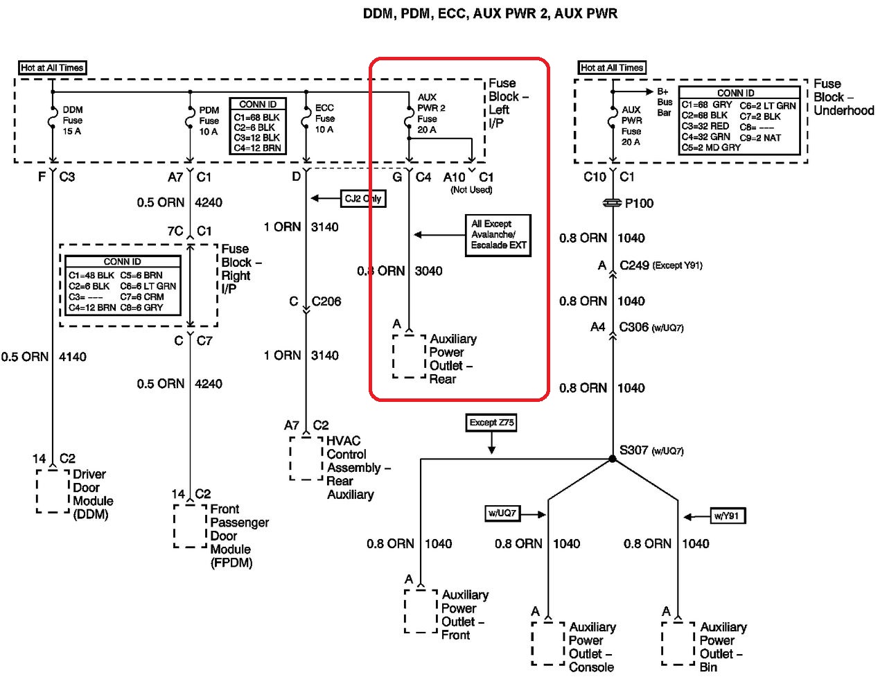

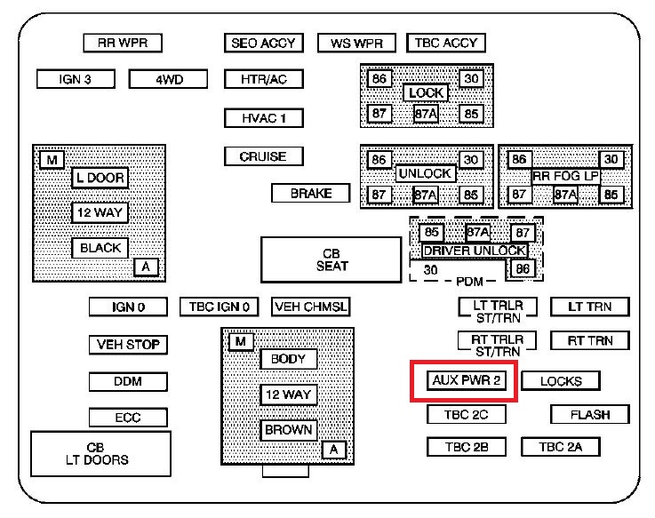

I have the same issue with the power port(cigarette lighter)in the rear hatch area. Fuse is good but it doesn't work. Hasn't in years.
Moderator
16,717
34,632
People's Republic of Colorado
Just out of curiosity, have you verified Aux Pwr 2 fuse to be good, and that the fuse socket has pin tension on both legs?
33,361
51,880
It's been quite a few years. I remember the fuse being good but I never verified pin tension. Never even occurred to me to check for that.

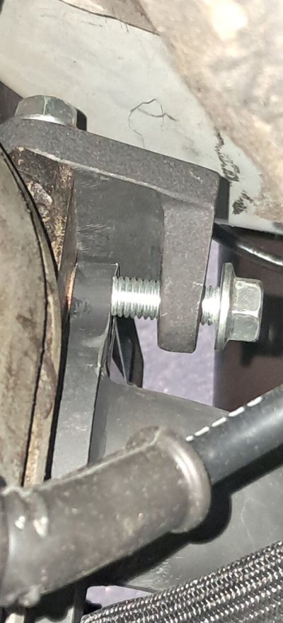

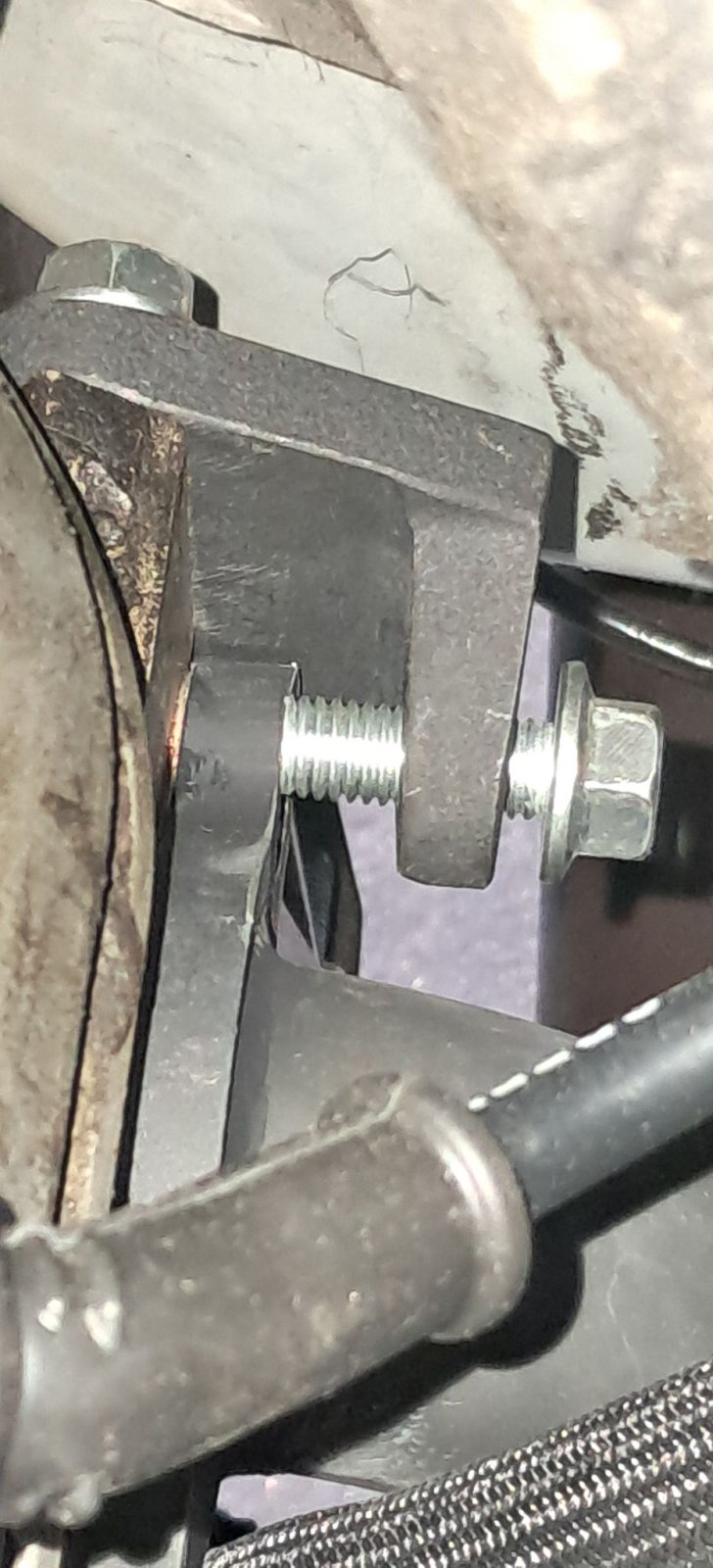

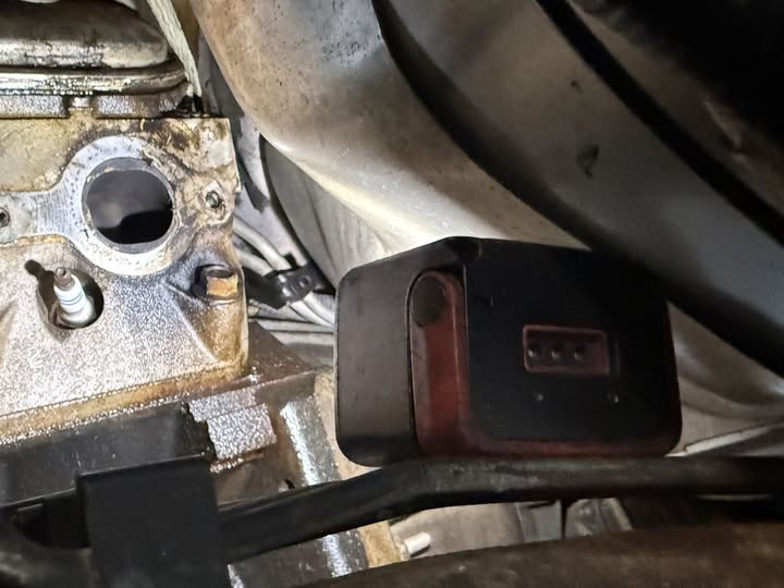

This is the fun part. We're into the header install and got all the other broken studs out except the dreaded rear broken stud below the mating surface.
Dorman makes this, and it will be here tomorrow. Hopefully I get my 50hp out of this and it holds until I get a new motor and trans in a few years.

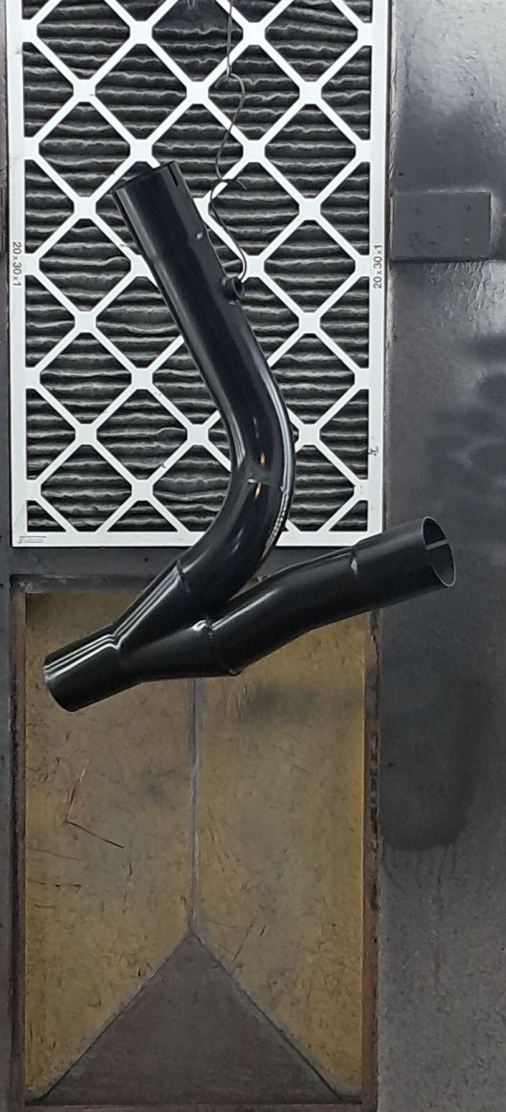

Midrange torque feels amazing. The coating I think helps keep the ringing a bit quieter from the headers. It is very quiet and tolerable at idle and cruise. Mash it from a light and it sucks the hat off my head. The holeshot on 4.10's is great.
