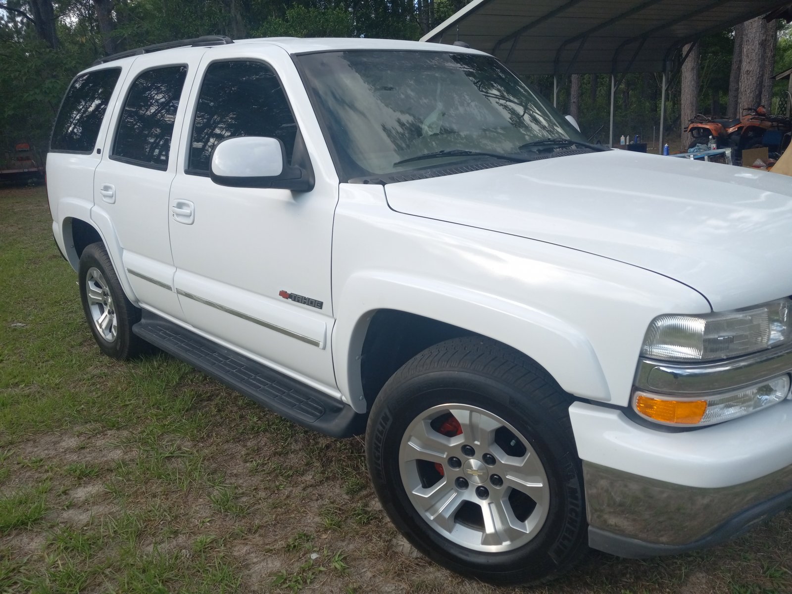

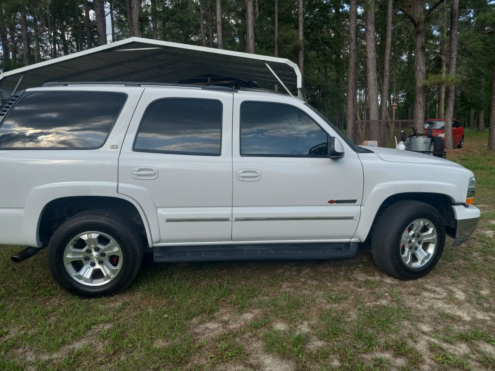

Went with Glacial White from Urechem, sealer, single stage. Not bad better than before. The roof is a bear!
