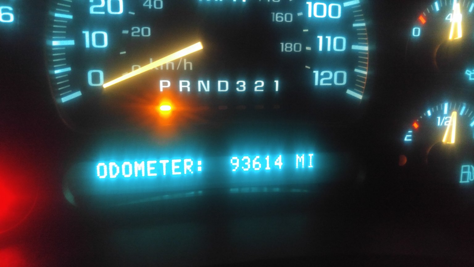

Merry Christmas everyone! After driving back and forth to work today on the ski resort and then Christmas dinner at a close family friends house tonight, I parked my car in my driveway and this number shows on my odometer. Exactly 19,000 miles I've put on since I bought my denali on Feb 28th of 2015. No mods tonight as the current outside temp is 13 degrees. Lol. And also because the weekend brought 18 inches of white christmas! :D

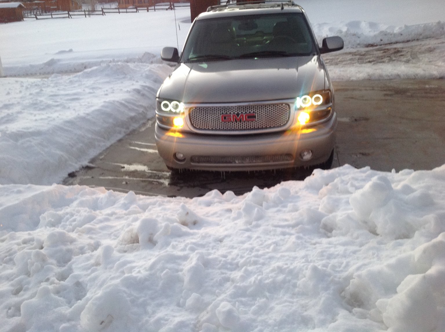

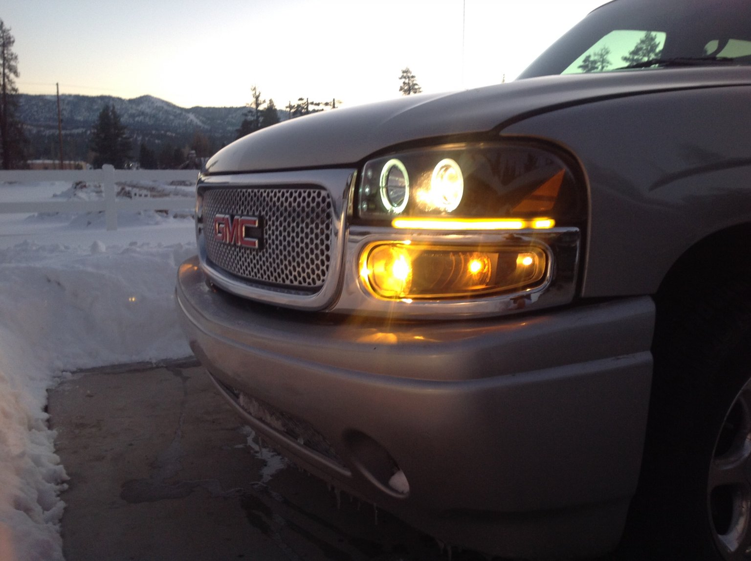

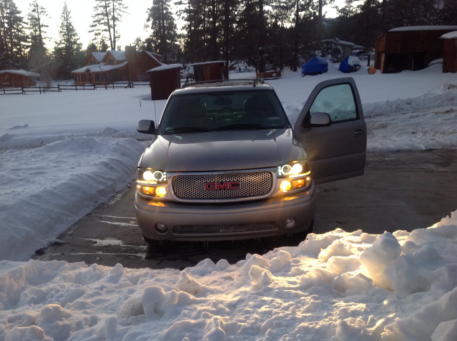

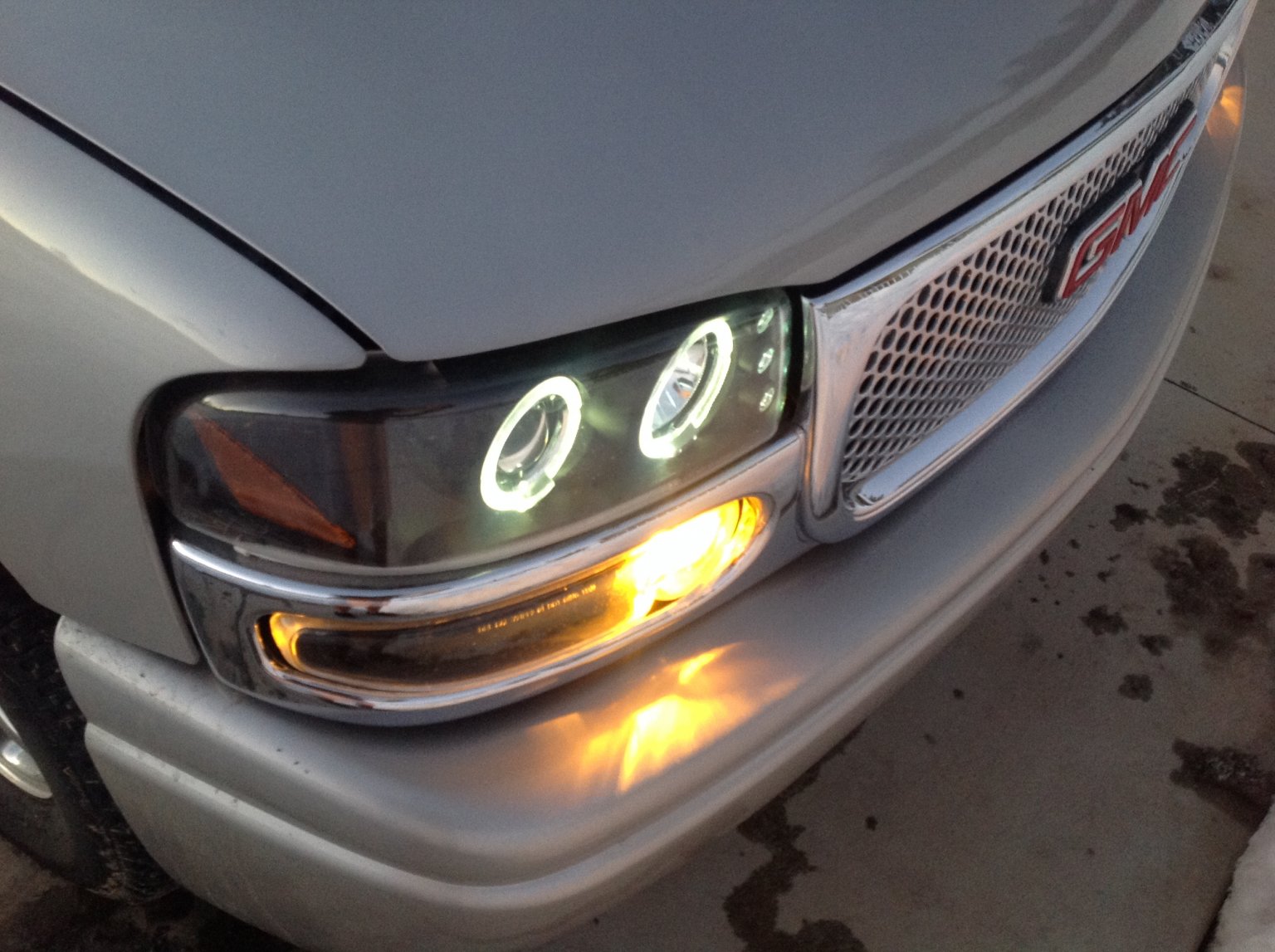

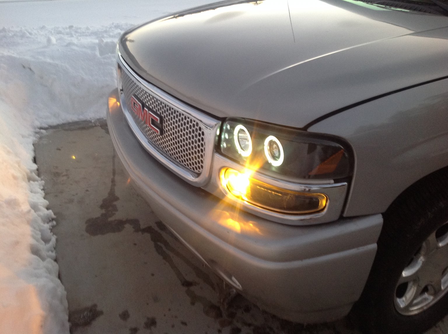

So did a cool mod today. Found a sweet thread about a week ago about getting my DRLs on at the same time as my headlights. Which spiked my interest because my LED/halos that are a part of aftermarket headlights are wired into my DRL. So got a couple diodes and run them from my my DRL relay to both high and low beam relays. Took a few try's to get them in the right pin slots. But I got them on. Here's a couple pics.
