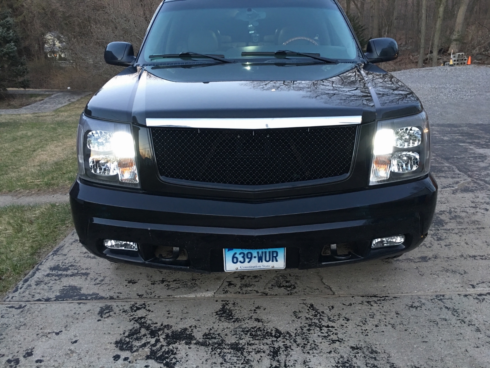

I noticed on my way to dancing that my drls weren't coming on like they are supposed to and went to back up and my video camera said no feed. Could be unrelated or could be related. Gotta check it out again in a bit when I go to head home. Why can't this crap just ever be easy.

Backup cam is fine. Every once in a while it glitches and doesn't kick on. Still no drls though which is really irritating. Gotta figure that out in the morning. On the up side, cruise control works again.

3157. Those are stock. Nothing changed there. Although I do have a diode ran from the DRL relay to my low and high beam relays so they come on at night with my headlights. Neither side is on at night. I didn't do anything to my headlights today so I'm not sure why those would have been affected. Will have to check that diode first thing in the morning. Not sure where to go after that other than a fuse.

That's why, 3157 are not designed for drl. They blow out quick, especially since yours were hooked up all the time with your headlights. Get 4114, and they won't burn out.
I try and tell as many as I can.
Actually there should be a sticky in the general or exterior section for this. Sellers always put drl for 3157 and it's not compatible for our particular trucks.

Yeah but both sides are not working, nor are the led strips inside my headlights that are wired into my drls coming on. And they work when I hit my remote with my park lights. They just aren't coming on with my headlights. So I know they work. And they worked fine before the tails went in. Not sure why the tails would affect that.

Did you check your diode?

I guess diode is only culprit.

I don't wanna do any leds up front. Have no desire to wire in resistors. Because me and wires don't get along. Lol. I checked the diode this morning and it looked fine. Will swap in a new one this afternoon and see if it comes back on. All fuses checked out this morning as well.

LED DRL bulbs are plug and play only need resistors if there in a turn signal

I think this has been touched on or maybe you already did it. Was having an issue on one of the trucks with something LED even with resistors PNP.
Just a thought go back to OEM tails as if nothing had changed and try every function again to see if those tails are tripping something out.
If all works then you know it is the tails. If not then, next course of action.
Hope another point of view to assist.

Yeah gonna plug my non led tails in real quick and make sure.
