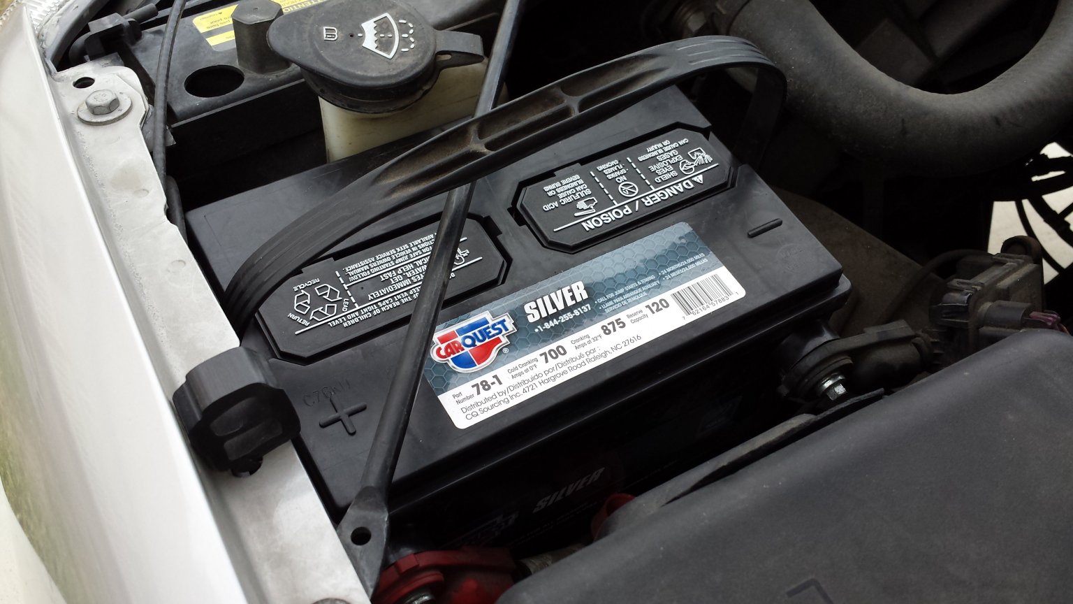

Well battery decoded to not hold a charge on me and died yesterday while I was washing it in the morning. With nothing on..... ooi. Started real slow before after sitting a few days while i was on my snowboarding trip. Decided it was time for a new one. So 142 bucks later I swapped in a new battery. Took about 20 minutes to swap it out after going to get an extension long enough to reach the bolt at the bottom of the tray. Haven't had trouble since. My front shocks didn't get done over the weekend while my denali was home cuz my buddy bailed on me again. So it's at the jeep shop where he works today up on the lift. Supposedly getting done. Always something.
