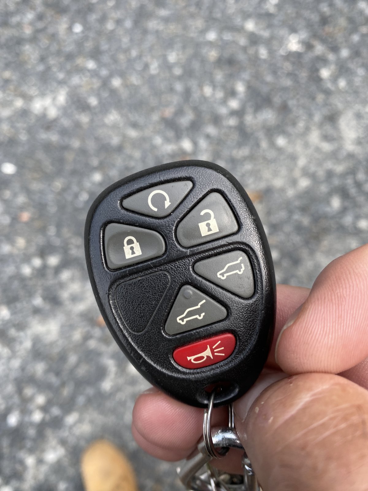

Hey guys a just bought a 2008 chevy tahoe and it has remote start but every time I go through the sequence I will hit the lock button then hit the start button the lights will flash and then the lift gate will open. Has anyone had this happen and it it a program issue

Not to be a dick but you sure you’re hitting the correct button? It’s the top one
Next thing I would do is take remote apart and makes sure contacts are clean, fresh battery and that the contact board is inserted correctly.

No problem and yes i hit the lock button twice and then the start and it opens the lift gate. Both of my remotes do it and iv put new batteries in both as well

What happens if you just hit the start button? Does your liftgate open as well?
What about if you hit your liftgate button? Does that also open your liftgate?

If i just hit the start it will open the lift gate and if i hit the liftgate it will open it as well

no then probably not, if you don't have a tech2 then I would try taking it to the dealer and have them re-program the fobs, maybe the programming got screwed up or "somehow" someone managed to program them that way. if reprogramming doesn't work then it may be a bad the module on the truck, if that turns out to be the case I would try and find a used one from the junkyard or online like ebay, dealer is probably going to want a grip for new module.

That’s pretty funny!!! It’s an 08 so ordering a new remote off Amazon is less than $10. 2008 also means the key AND the fob can be programmed via the trucks own system.
When the new key is programmed, the others are wiped unusable unless they’re reprogrammed (again) at the driver speedo console or DIC (HA!!)

I have the same problem on 07 Tahoe LTZ, there are no codes and I have tried two sets of aftermarket Key FOB, and the two working original factory Key FOBs, changed batteries, reprogrammed the Key Fobs, they all do the same exact thing as jaggar said. There no open door, hood, or lift gate indication. My On-Star subscription shows no codes or faults whatsoever, my little ODB/ODBII reader shows no codes at all, all senors working normally. I wonder, there might be a sensor, which is not shown DIC but monitored by the remote start?
