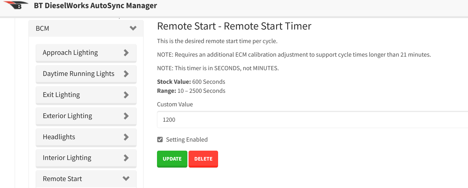

btdieselworks autosync supposed to let it run 1x20 min cycle..
Have not found ECM setting mentioned below...

It looks like the RCDLR and the BCM are the two computer modules listed, no mention of ECM directly in the loop..
You should change your remote batteries if you haven't tried that, because they can lose signal and that maybe getting it out of sync.
Maybe it doesn't think it's the second button press after resyncing.. since you're only allowed to press twice.
