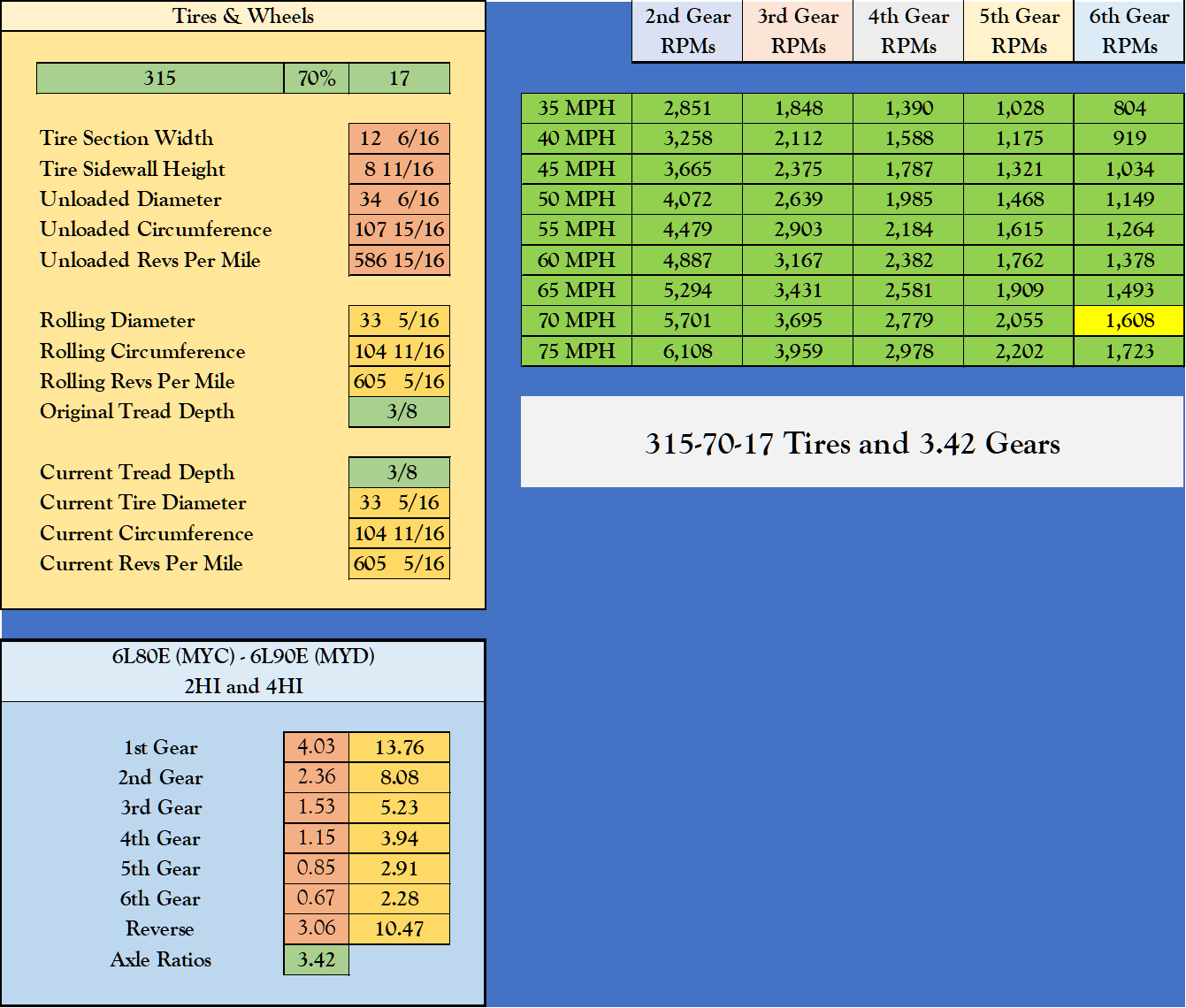

@swathdiver what does your fancy calculator say?
3.73 Gears will bring you back to essentially stock gearing on stock tires. 4.10s will give you a little more giddy-up and tractive effort in 4LO.
If you ever go back to the stock tire height, the 3.73s will be more friendly for street and highway driving than the 4.10s. Though many don't mind them at all.
