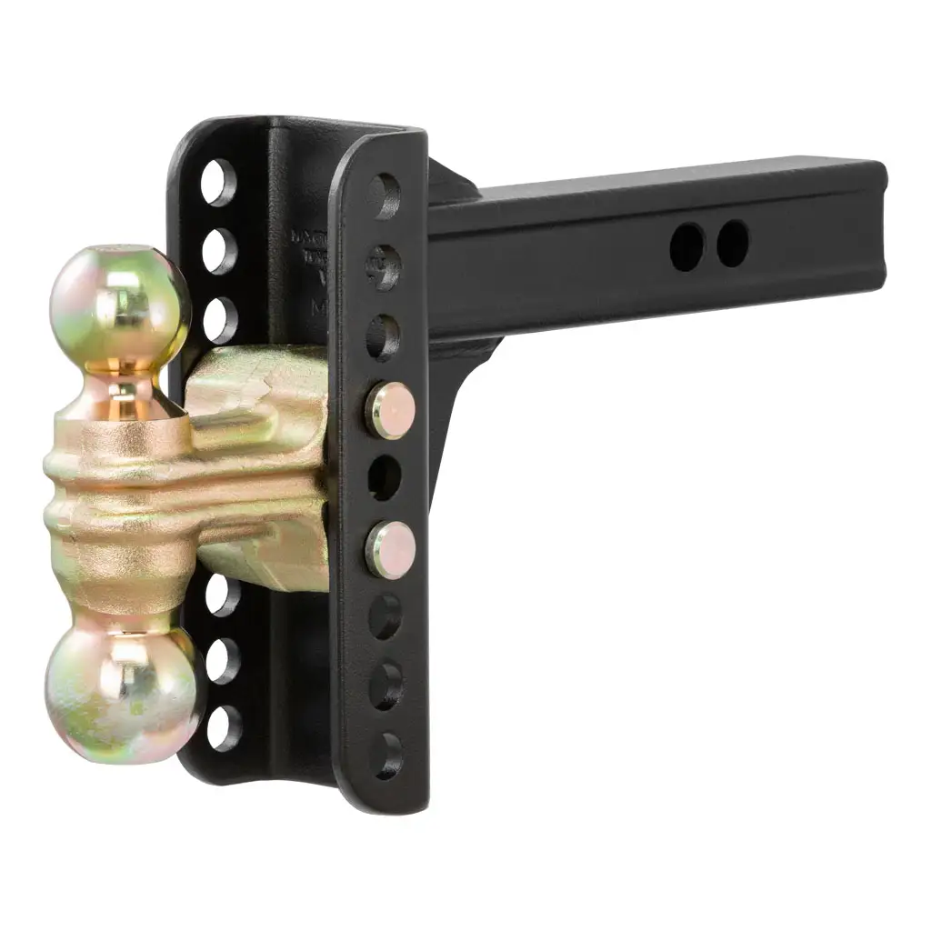

How about one of these? They come in different capacities.
  • Adjustable Trailer Hitch -Drop Hitch-Tow Hitch with 2 inch Receiver-6inch Drop/Rise, 2" & 2-5/16" Ball Hitches for Trucks, 20,000 LBS GTW, Trailer Hitches with Anti-Theft Pin, Black…
$109.99
https://www.amazon.com/Adjustable-T...le+trailer+height+receiver,aps,83&sr=8-5&th=1

We use a Curt 45900 (14,000 pounds):
