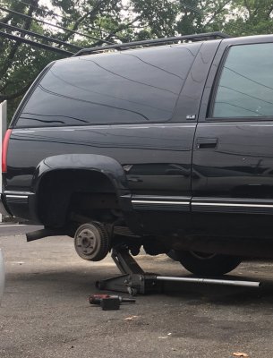

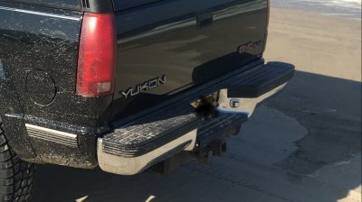

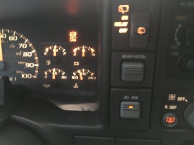

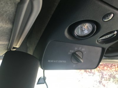

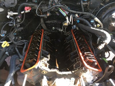

Pics being uploaded now.....
**5.7L Vortec and 4L60E**
Rebuild or Upgrade?
1996 2door Yukon SLE 4x4
I bought this Original Owner truck about 4 years ago.
I put up 8k miles since and and currently have 140K miles
This was an unmolested but sitting truck when I bought it.
Refreshed with GM or LMC parts.
usual fluids, filters, sensors, bulbs, shocks, bumpers, brake lines, rotors, etc.
Whatever it needed to be reliable.
Only change,
285s on stock rims, no crank
Used for beach duty and the yearly 1000 mile family roadtrip.
I'm currently disabled and can't do the work myself.
I don't care about an LS. I would prefer to find someone who could help me get her in shape.
But am I missing an opportunity?
Please give me your thoughts
REBUILD the original Vortec350 & 4L60E
Buy a REPLACEMENT Crate Package Motor & Trans
SWAP a rebuilt LS & Trans Package
A9F3FB4D-77D7-425A-8182-F376657A71EE.jpeg 11C9A94A-B99B-461A-9016-A99E005EFF7A.jpeg 6D1B57BF-7365-47E5-B7F8-63812F6FC840.jpeg 434F9C7D-190E-4062-8E72-789F82E19044.jpeg 8B44B208-4BB1-41AE-A52C-4F820739D3E9.jpeg

Thanks for your help!
This truck does our family road trips, so I want it to perform reliably.
The 5.7 Vortex has a leaking fuel injector.
The 4L60E is a good but tired.
I can buy a crate motor and trans or rebuild these.
I'd like to know what's the most reliable way to go.

Thanks, ivin74!
This Yukon sat for a long time before I got a hold of it.
I refreshed everything it needed 3 years ago, and have since used it on several 1000 mile family trips. Which is it's only job...
Get there safe, off-road beach driving, get home.
In April I found this Yukon SLE, needs head & intake gaskets.
Also, having owned several of these trucks, I get the feeling it's underperforming.
