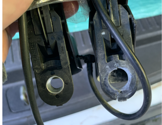

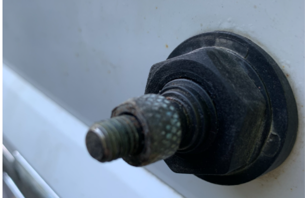

I had expected it to break near the spline. This is where mine failed and I replaced with a GM replacement (15277756). The inner part is aluminum and fused to the spline on the motor side. It took me a moment to realize that; the new one was not fitting. This is a 2011 Suburban.
