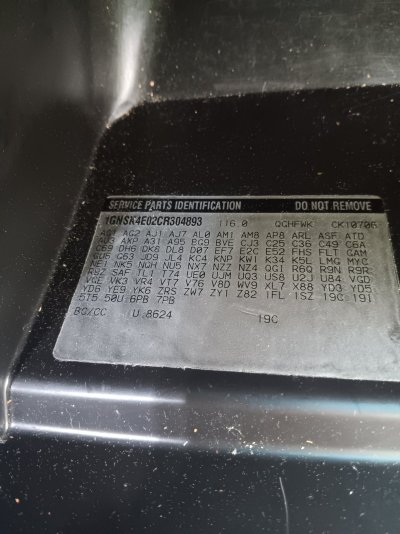

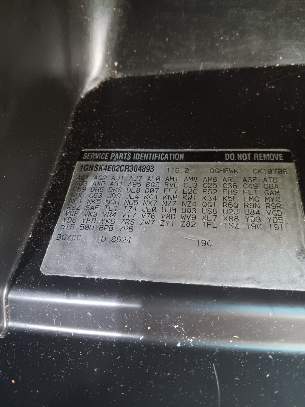

I'm looking to lower my rear down, will these swap out on a '12 SSV?

Correct, I was asking if the PPV rear struts will fit my SSV without any additional hardware or adjustments... I'm looking for the slightly lowered stance in the back
I believe the springs and shocks would need to swapped, that would probably get you around 1" maybe a smidge more
once you start lowering it then you are looking at control arms and adjustable panhard bar.
these have a floating rear axle, so when you are start lowering the axle shifts, how much you lower it defines the extra parts needed.

Your RPO sticker shows the Z82 Max Trailering Package, which are heavy duty shocks and springs.

Im sorry to tell you but shocks don’t determine a vehicles height, springs do. Either coil springs, coil over springs or air springs. Not shocks- they only absorb shocks, that’s why their long name is shock absorbers. As you must know by now, you don’t have coilovers (long form is coilover shock absorbers) in the rear, you have separate coil springs and shock absorbers. In order to lower it you’ll need to swap out the springs and like mentioned, other stuff depending on how low.

It's 4wd, the PPV didn't offer that until '15 I believe
I am still confused. Just because it is a 4wd how does that make it a SSV without being a 5W4 on a 2012? Maybe someone can clarify this for me as I was told it had to be a 5W4 to be a SSV which my 2013 is which is also a Commercial?
