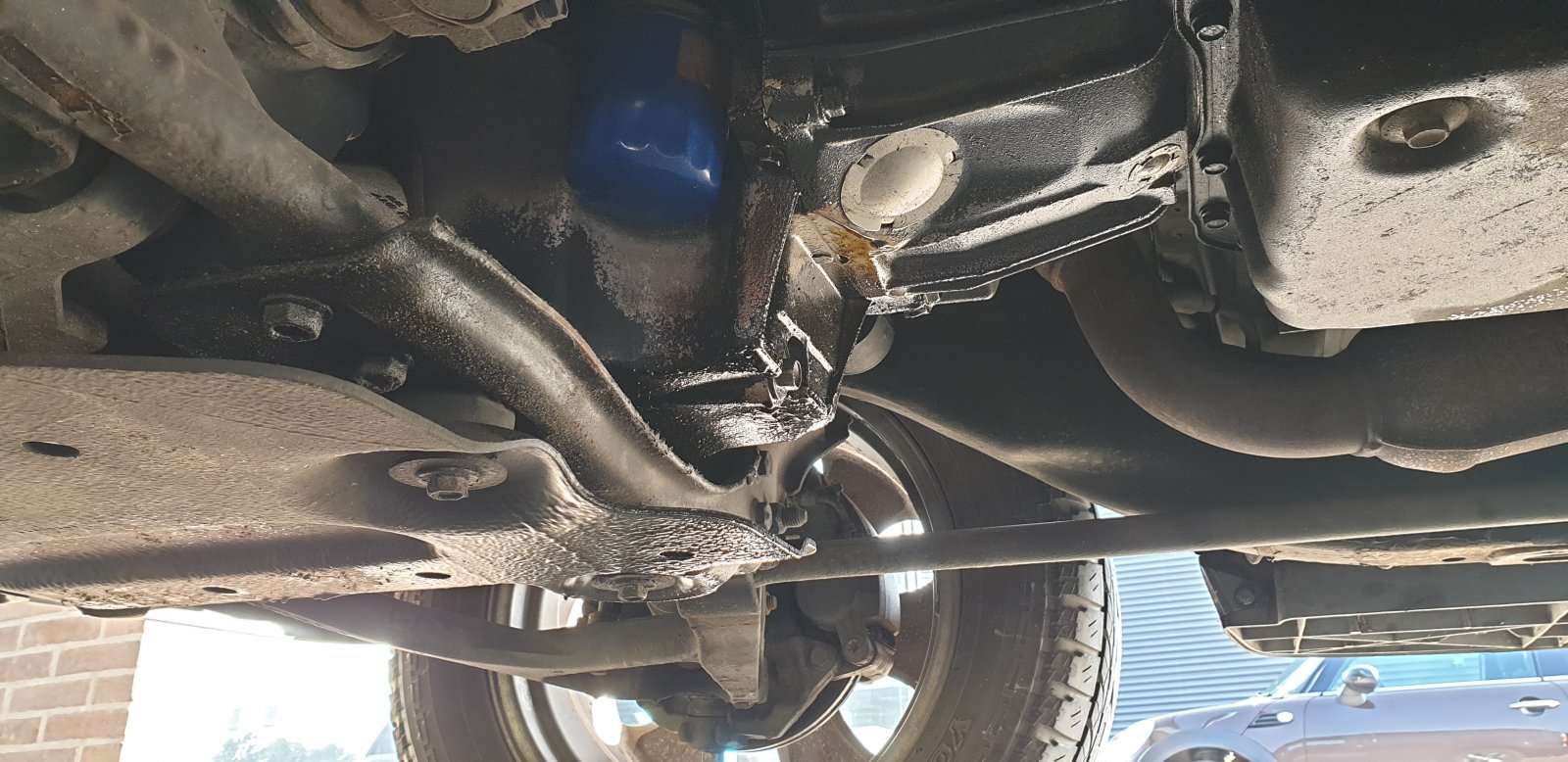

I need to replace my rear main seal because its starting to leak (nowadays I find a small puddle each morning).
I have looked on rockauto.com and found the following part no. GM GENUINE 12639250
Is this the correct part? (could not find it under my vehicle in rockauto) and should I replace other stuff while my mechanic is at it? Just making sure because I have to order everything from the States.
Thanks!

I do believe that is correct. You definitely want the whole housing that comes with the new gasket and rear main seal itself. I would go ahead and do an oil pan gasket at the same time by the looks of it.

If you want to be sure, post the last 8 digits of your VIN, and @915_Tahoe will provide you with the correct part number. As @91RS stated, "You definitely want the whole housing that comes with the new gasket and rear main seal itself".

Third on doing the oring while there, and i would do the block off plate/ oil cooler adapter gasket as well. The father in law paid to have his rear main done to stop a leak, still had the mess in the driveway.
Ended up being to the block off plate. Five dollar gasket you can do in a driveway in 5 minutes cost him 300 at the shop to fix a problem he didn't have.

Oil and filter of course, pickup tube o-ring, oil pan gasket and make sure to clean out or replace the oil pickup tube while apart. Complete rear main seal assembly and I did the torque converter seal when apart. Definitely the oil cooler lines plate/block off. If is easy to get to while apart, do the oil sender switch. Check the transmission mount and replace as needed.

Cr/Shf RR oils seal Housing with gasket and seal
Gm#12639250 $83.93
Rear main seal
Gm#89060436 $30.65
Rear housing gasket
Gm#12639249 $30.62
Oil pan gasket
Gm#12612350 $49.73
Pickup tube seal
Gm#12584922 $9.47
Side cover gasket without engine cooler
Gm12611384 $4.79

Are you even sure your rear main is leaking and not a combination of all the other normal leak spots like the valve covers, oil pressure sender, block off plate, pan gasket etc? You can get a boroscope up there to see, that’s about the only way to be positive.

Get rear Trans seal with boot, where driveshaft slips in
-Exhaust flange gaskets, for both sides and I think the rear may one one too. For when mid pipe comes down
-I would replace the oil switch up top and the cam pos sensor as during my research I saw where these two were proven to leak over time.
-Nows a good time to do a trans filter as well since trans will be out and on the floor. Dropping the pan otherwise is a painful process
