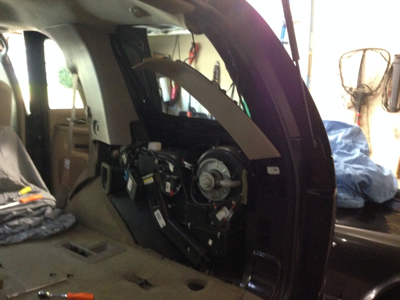

if you pull the rear passenger panel off then you can see the blower and 2 door actuators, the rear actuator closest to the blower motor is the one that controls hot cold the one closer to the front controls up/down. on my nbs the dealer wanted $127 fleet price, if you can wait and order it online you can get it cheaper. sometimes the aftermarket ones are darn near the same price locally.
