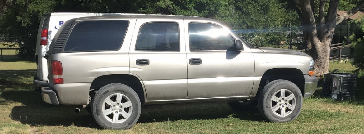

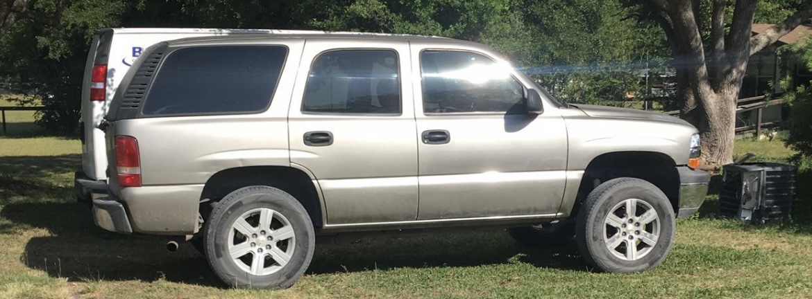

Welcome to the Forum from NH.
Pics of the truck, please.
