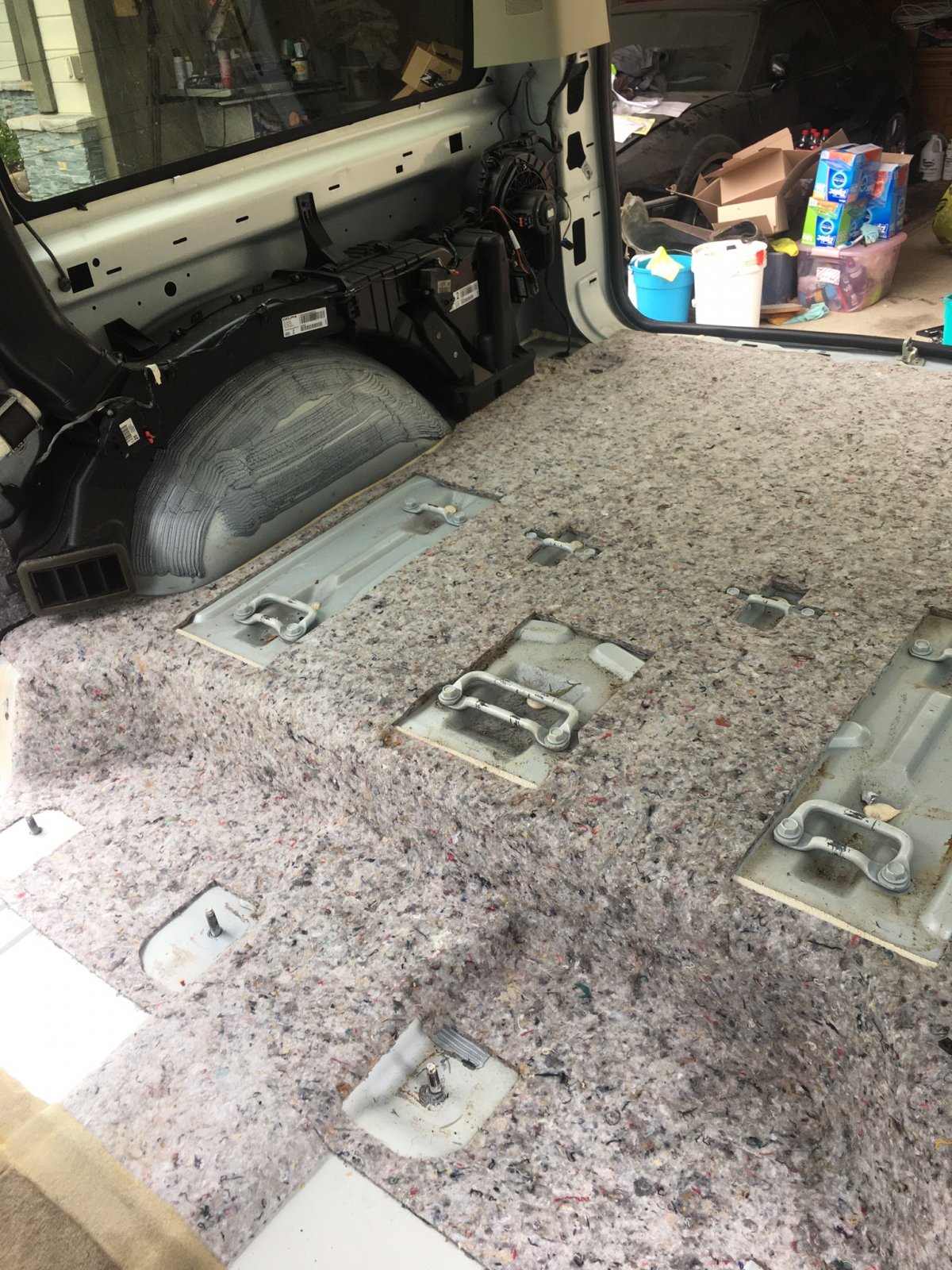

You’ll be delving into this once the panels removed. I can’t see how gm could of integrated the heater core into the evap coil but you’re right, we’ll see.
