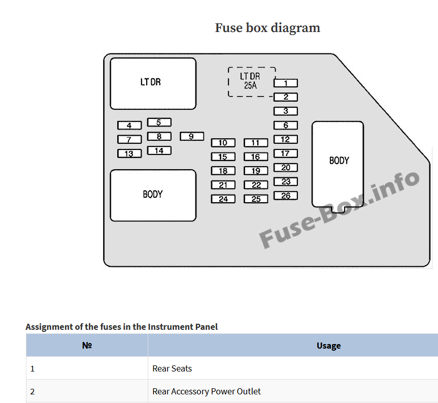

Hello Forum. I have a question ??? I own a 2007 Chevy Tahoe LT. I bought an small compressor to keep in the tahoe just in case. Well, I was attempting to air up a low tire and it stopped working, I thought it might be a fuse in the compressor but, It turns out that the 12 volt plug at the rear doesn't have power ??? does anyone know where the fuse for the rear 12 volt plug may be ???
