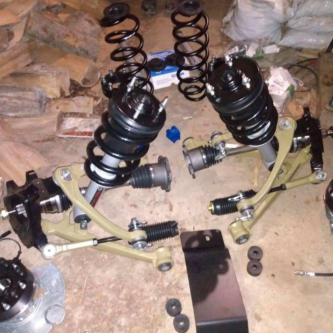

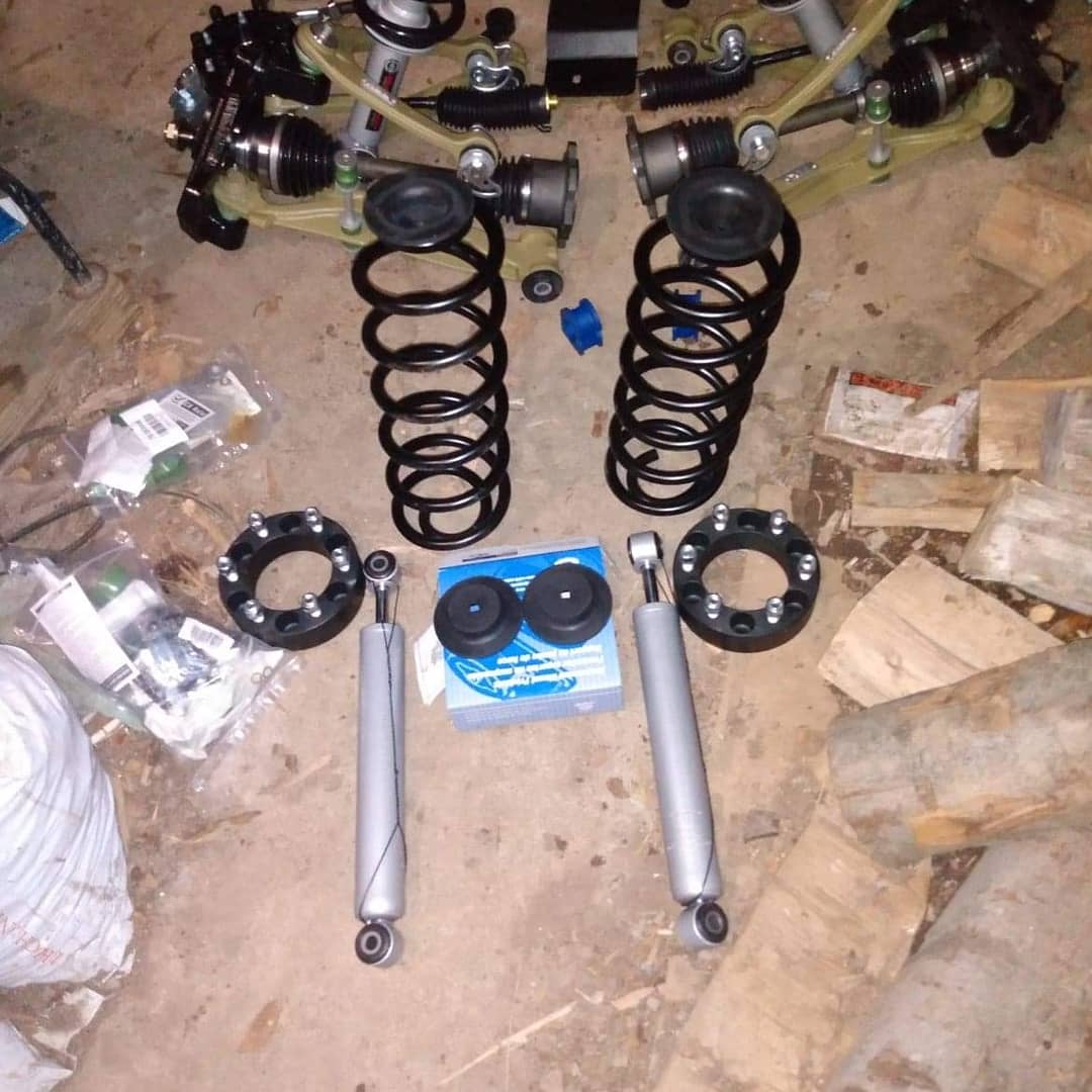

The rear springs wheel bearings and outer tie rods came in today so that means I finally have almost all my parts. I only need wheel bearing bolts which will be here tomorrow :) excited to finally tear it apart and swap everything. theres a big pile of suburban parts in the dining room lol and couple nights ago while I was getting beams to jack my house off it's foundation a dodge ram found its way to my driveway I couldn't resist I love 3d gen dodges and it was cheap. I gotta replace a ball joint and a tie rod in it tomorrow but that gives me something to drive while the suburban is in pieces and it makes my old dodge a parts truck so I can steal it's motor for my dart because I need more projects and things to do lol I will measure old and new springs and struts and measure wheel well hight before and after see how much actual lift I get. And I gotta put back together and do breaks on one of my extra cars so I can sell it to get new tires for the suburban and new dodge
87carl
87carl
Feb 21, 2016
328
169
Kinda layed stuff out and loosely mocked them up to see what everything looks like and how things fit together. control arms and tie rods are olive drab green not yellowish tan lol it looks kinda nice with all the black parts surprised how heavy some of these parts are. Also I have new brake pads calipers and rotors to put on all the way around went with 1.5 front and 2 inch rear spacers gotta trim front wheel studs slightly mostly just the tip and maybe 1 or 2 threads. Can't wait to see how the suburban looks with this stuff on it and most importantly how it handles.
