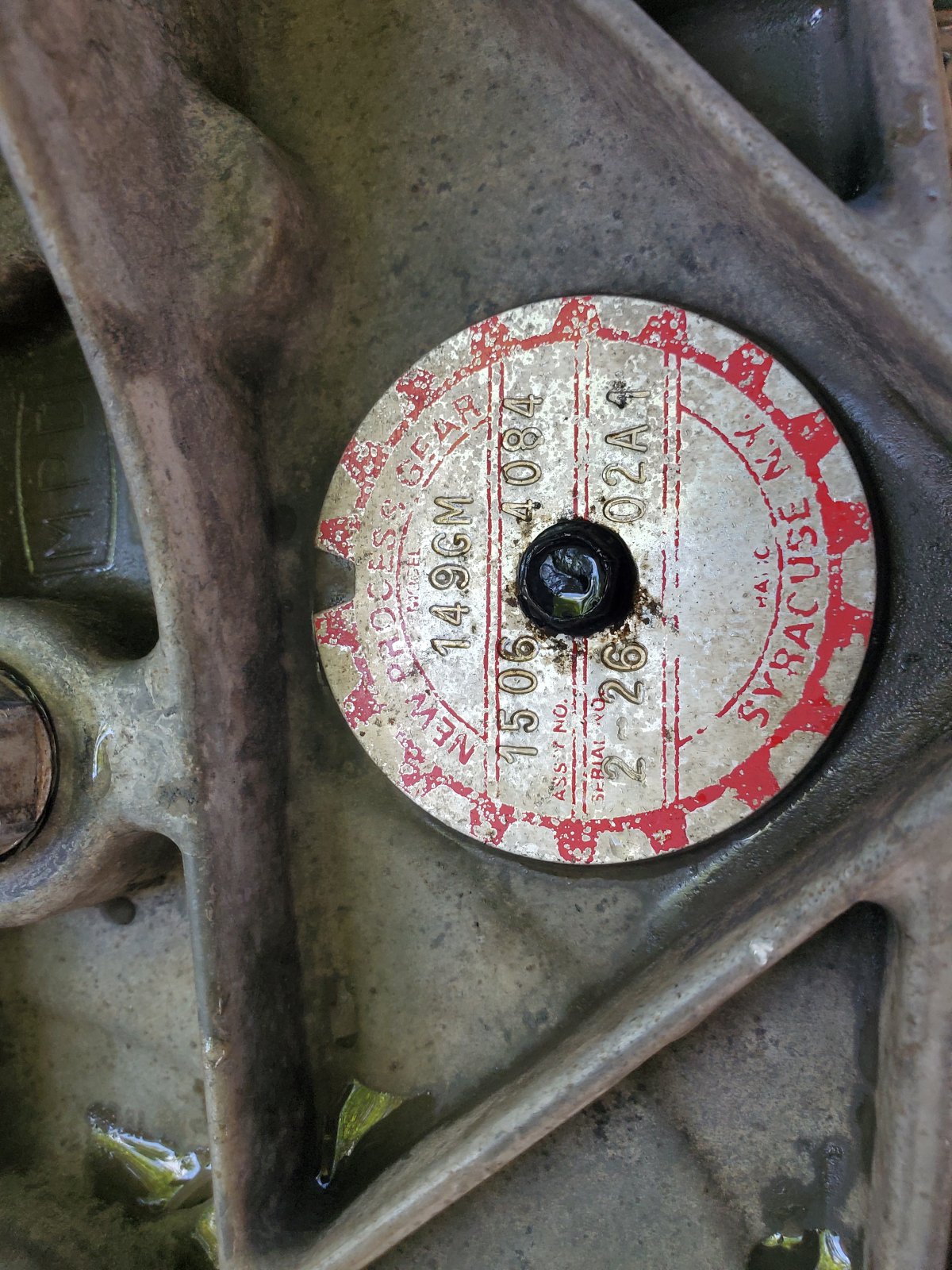

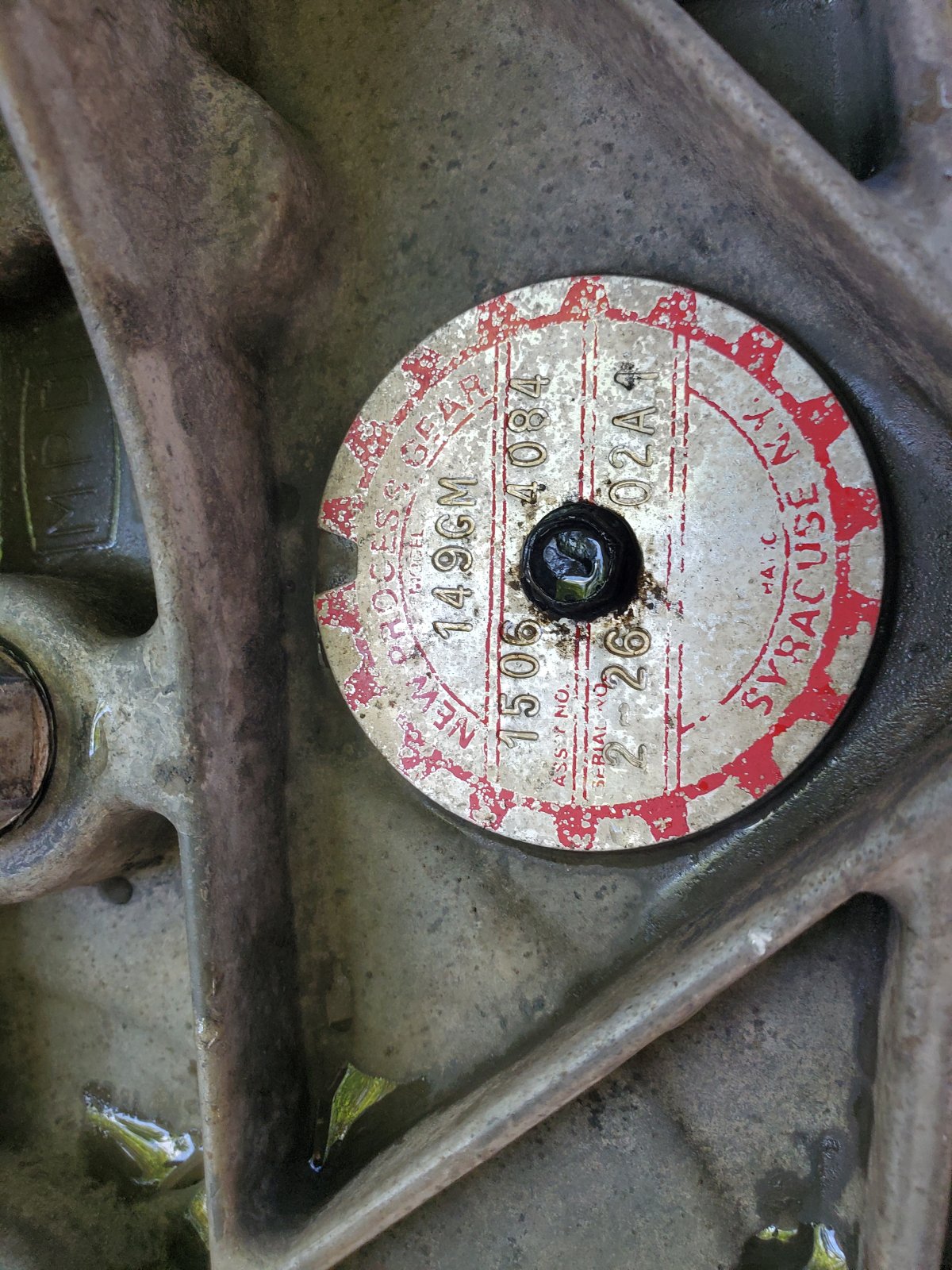

dunno couldnt find a definite answer i keep seeing both RPO codes for them NR3 for the BW case and NP3 for the np149. like i said comms have been kinda sketchy, totally possible he just happen to have a different new process case laying around and thats what hes saying he has...
randeez
randeez
Sep 29, 2017
8,188
25,926
south florida

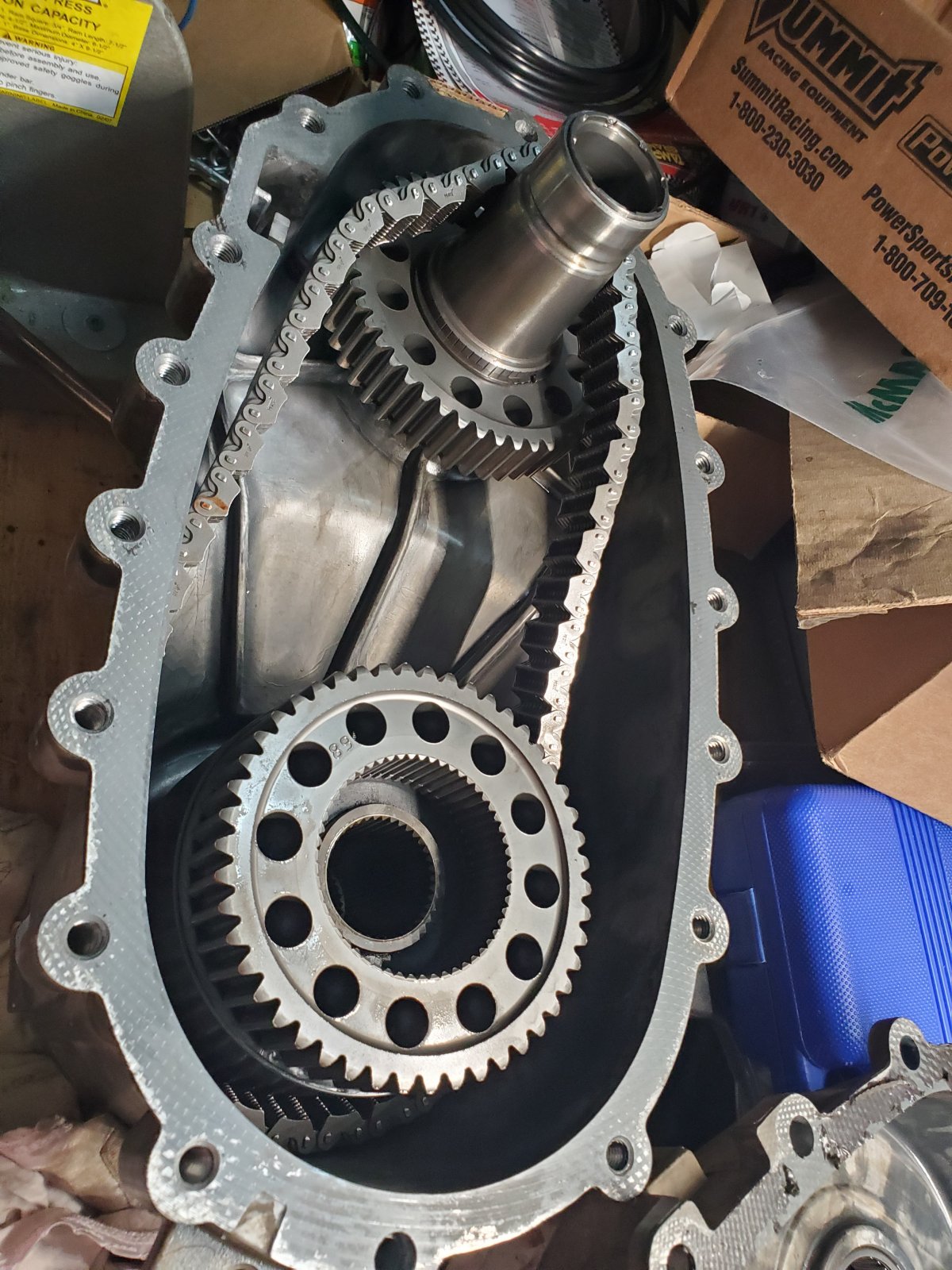

Was the correct one...had about an inch of grease caked on it so I hit it with the pressure washer, feels pretty loose as far as the bearings go so I'll prob just throw new bearings seals and chain...theres an updated cover and pump I gotta see if need to be replaced also.
got it pretty cheap so even if i do have to rebuild everything it would just come out to be about the same as a refurb'd one, but atleast ill know every part in it is new
View attachment 238860 View attachment 238861
Sweet!

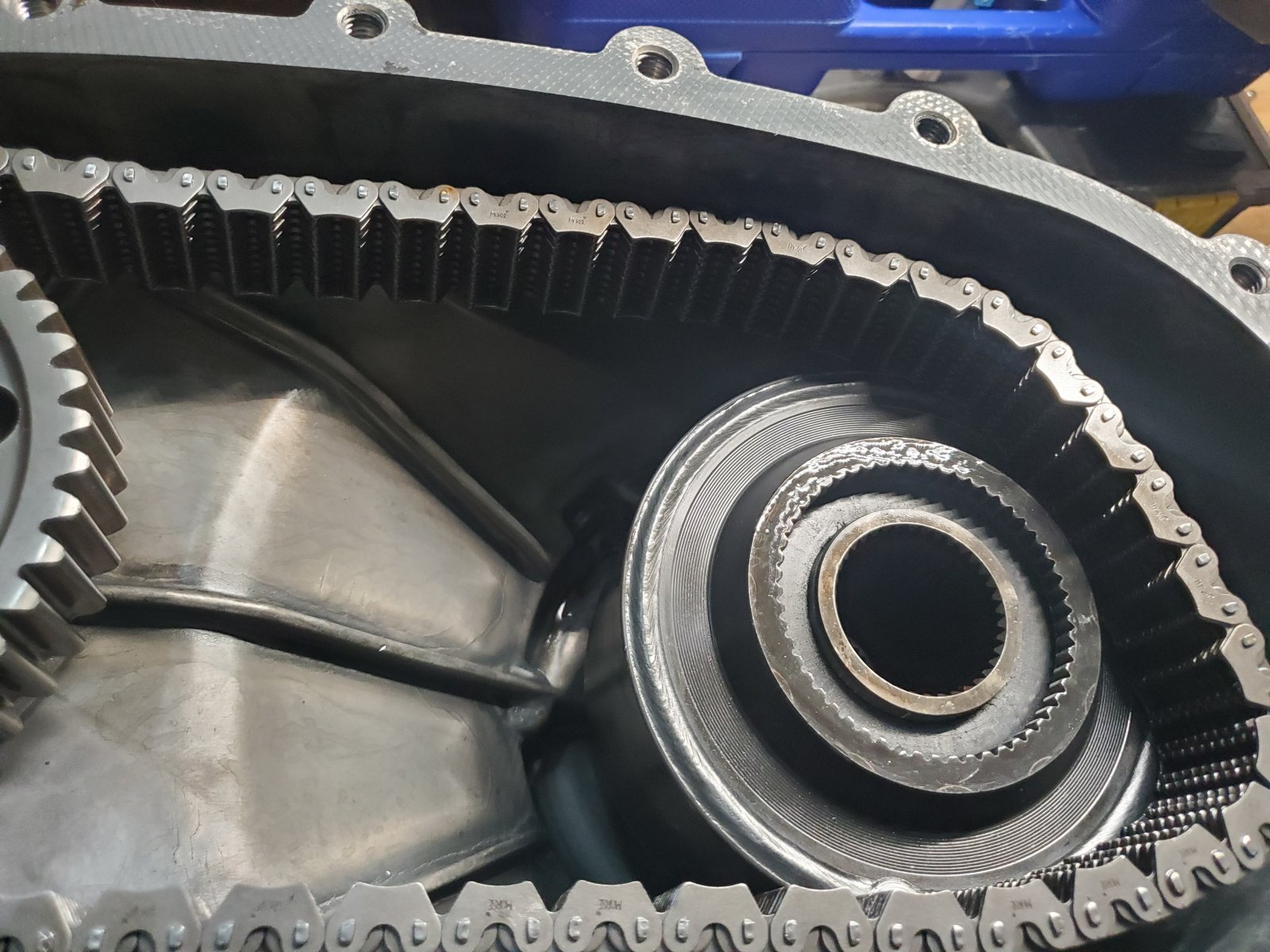

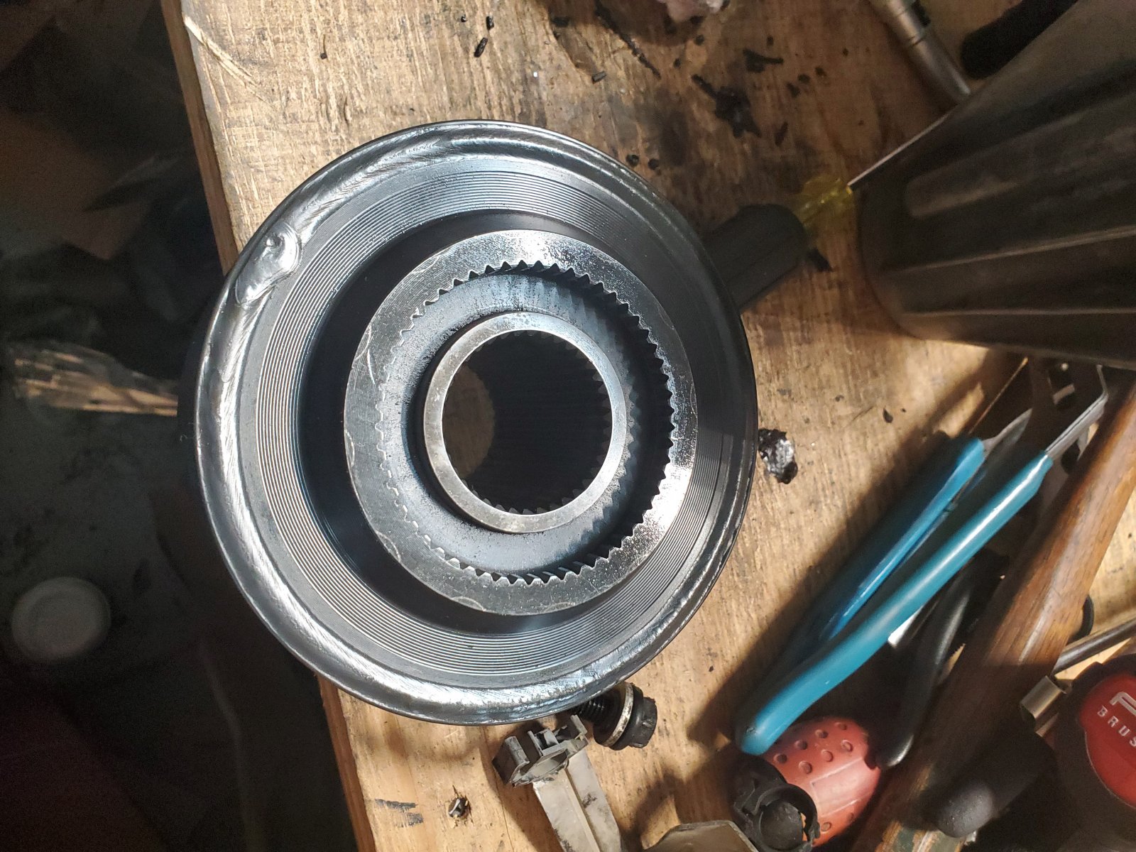

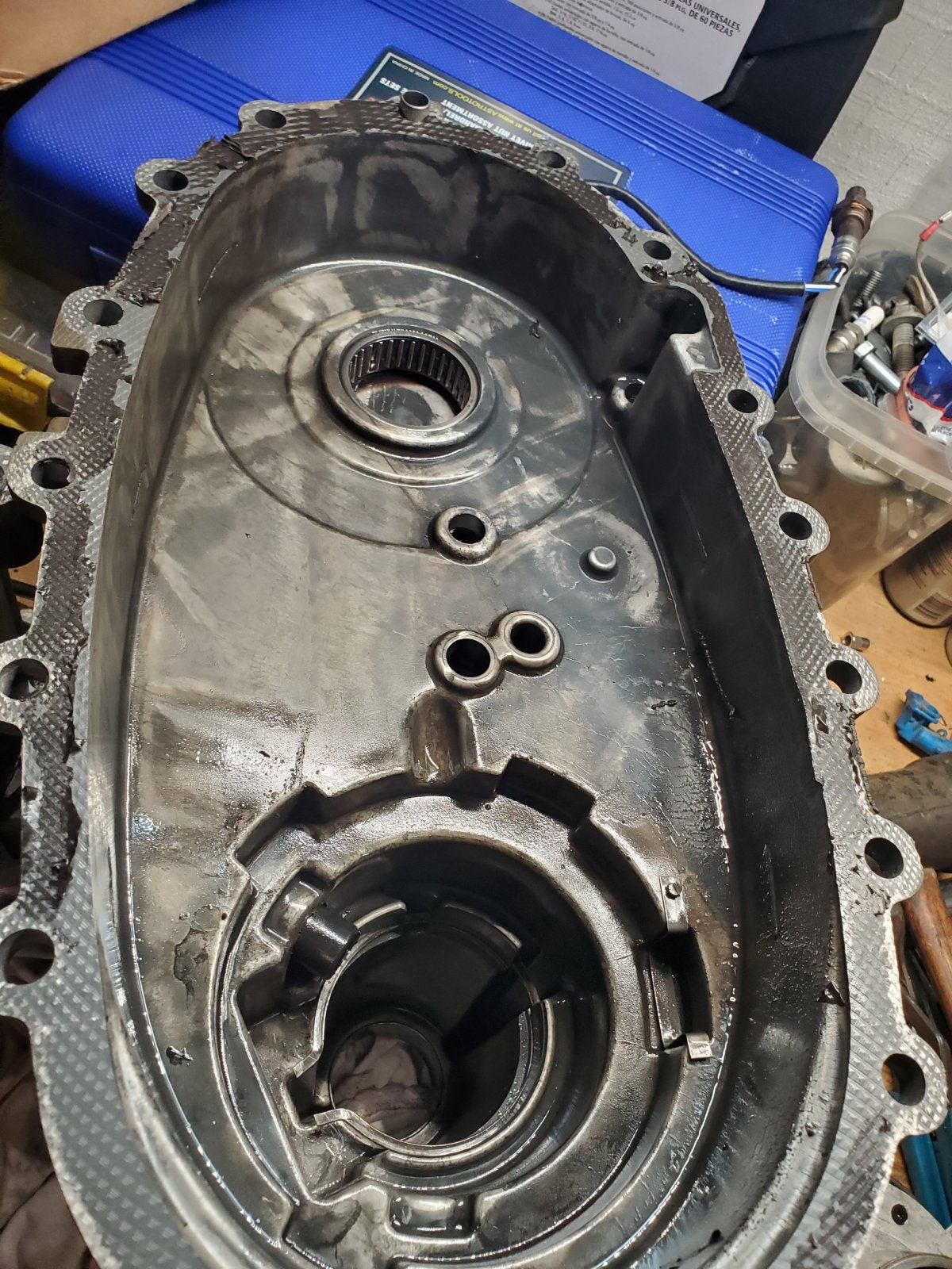

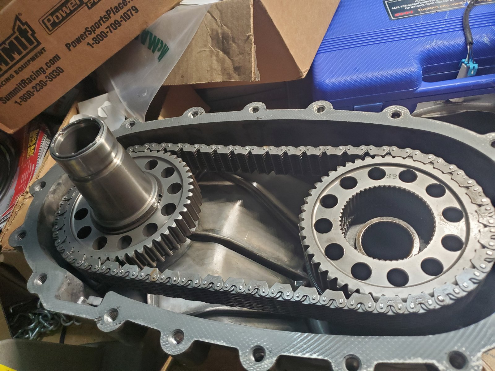

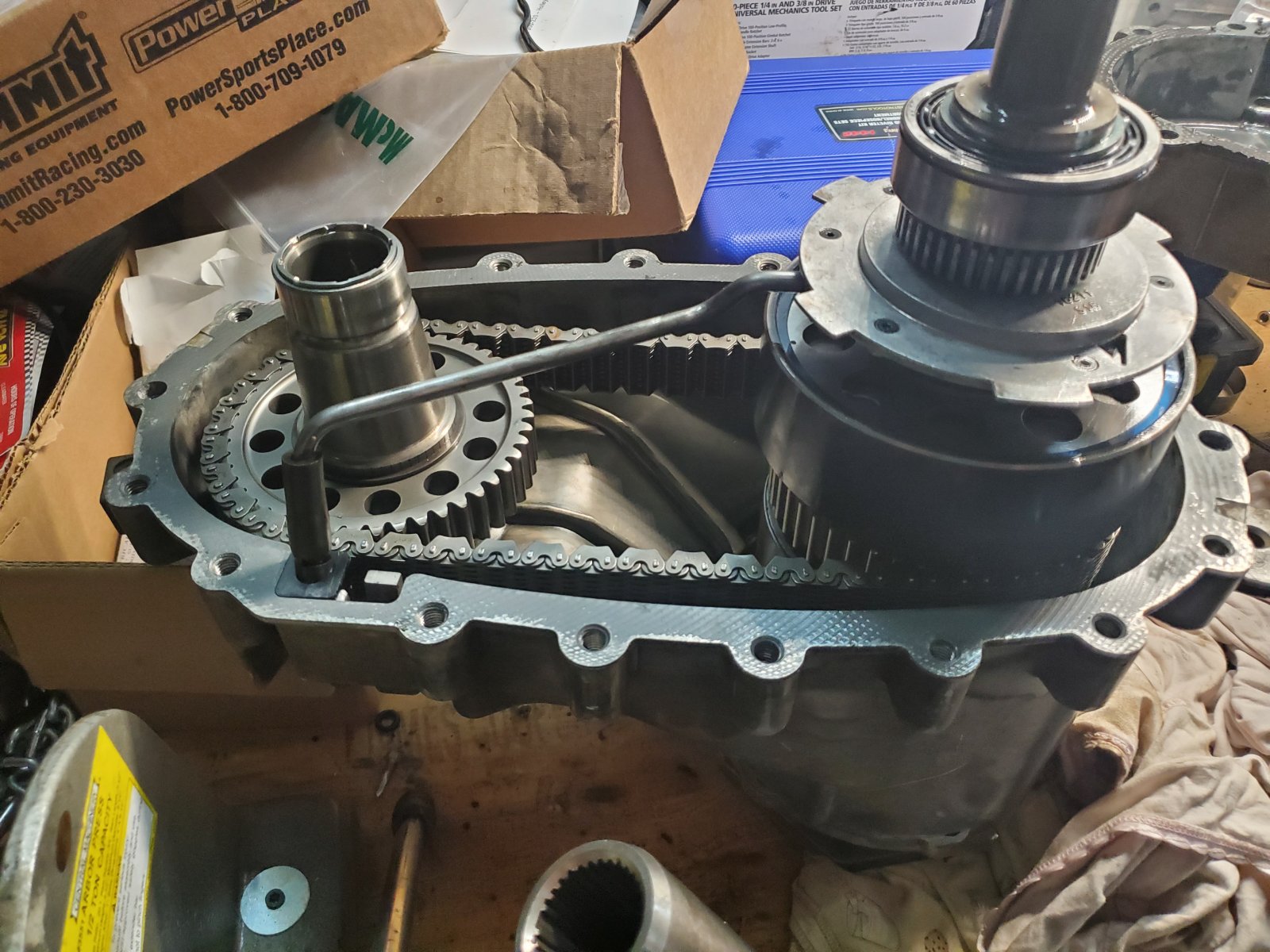

inside looked a whole lot better than the outside - possibility someone rebuilt it at one time...the way to much rtv squished out from the case halves is usually a give away. there is actual pump pickup that the screen was about 75% covered. magnet had a lot of metal paste on it. going to grab a few cans of brake cleaner and go to town on it next few days. pump looks in good shape but not sure how well its doing with all that rtv blocking the pick up. so will probably just grab one of those, couple seals, bearings, new chain... $300 rebuild kit basically, all the hard parts look good
not sure how "tight" it will feel after but hope it gets a little better

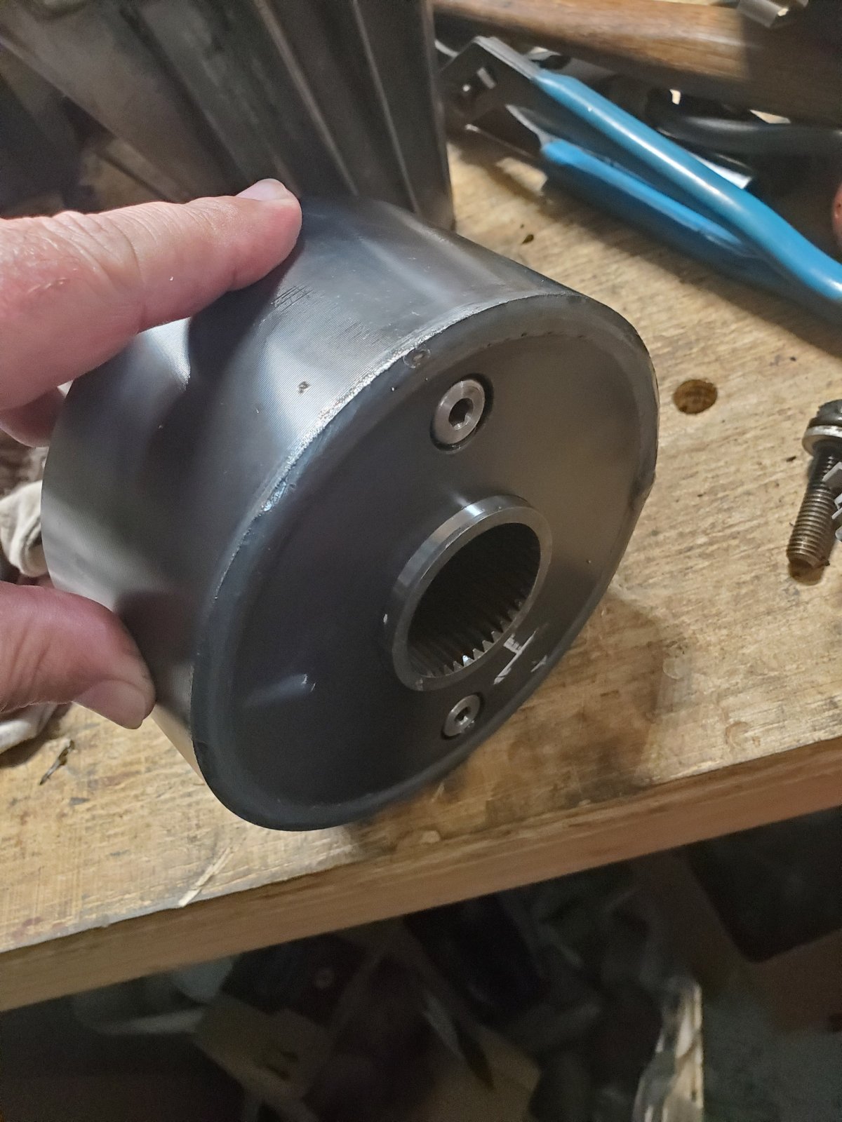

Is that the viscous clutch in the last picture, it has some blue gunk on it? My 06 SD has this t case and I've been curious to what the inside looked like. I LOVE how it works, yesterday I had to pull out on hw36 going towards Boulder, I had a tiny opening and took it. I smashed it the the floor and just as the rear wanted to spin, it just took off like a rocket with nothing spinning. I think you're going to love this in your Denali.

That's the outer part that slides over the planetary gear but looks pretty much the same. The viscous coupler goes right in behind the input shaft that drum looking thing with splines thru the middle and a larger spline on one side

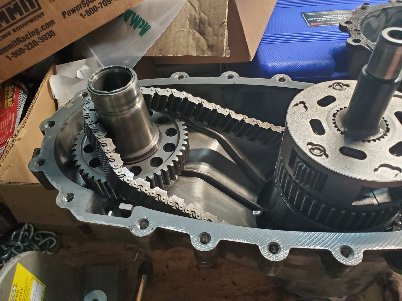

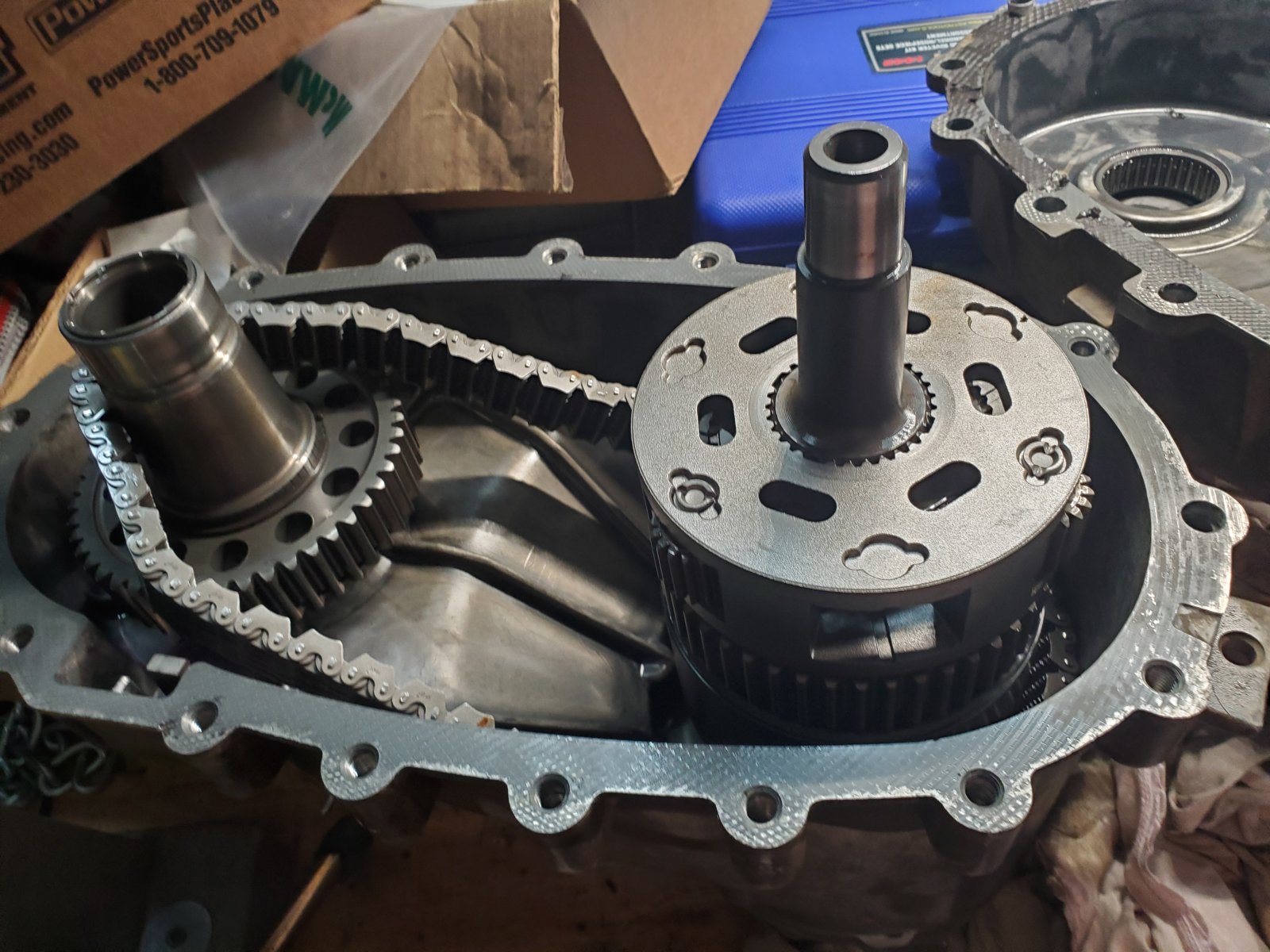

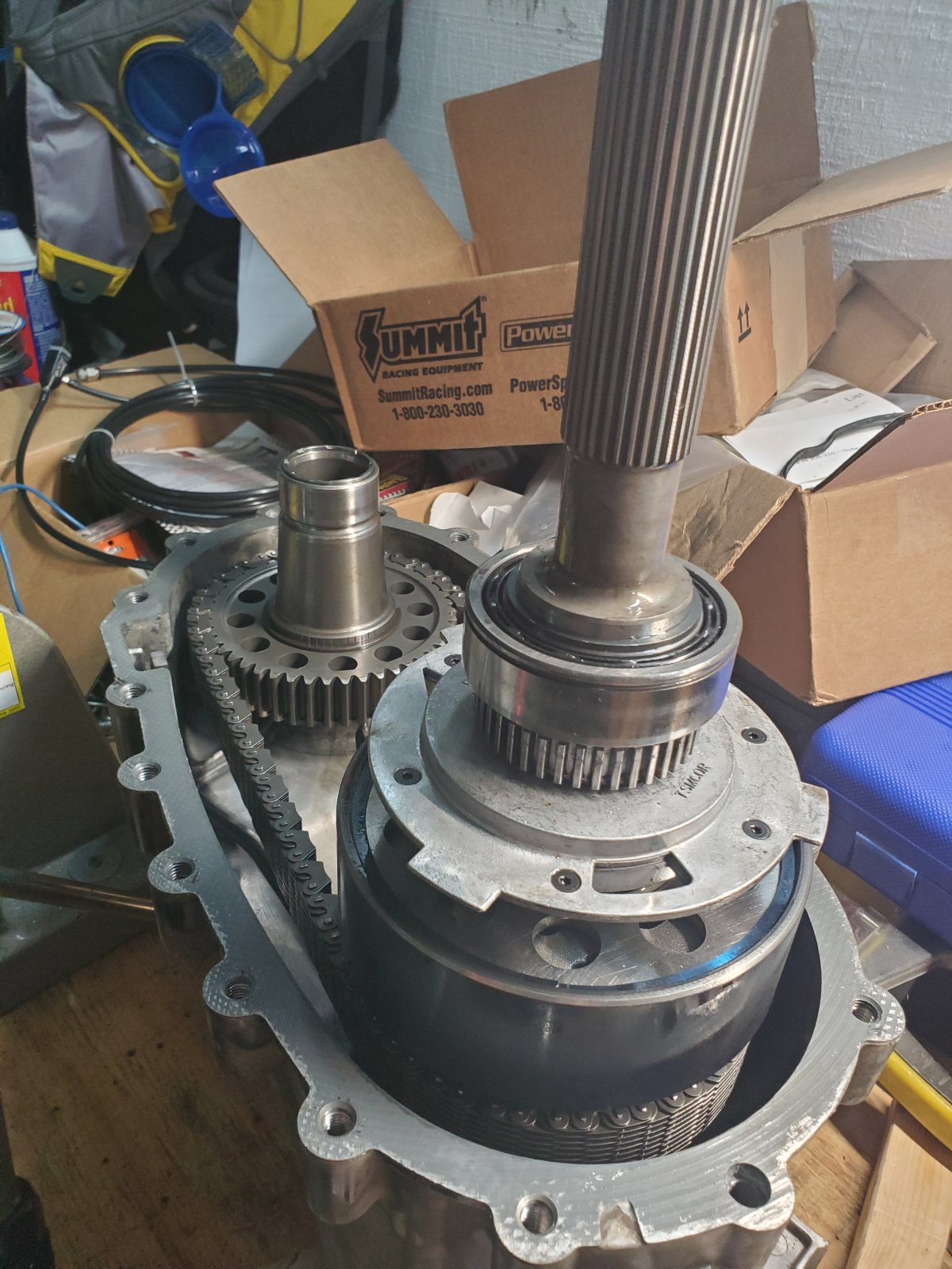

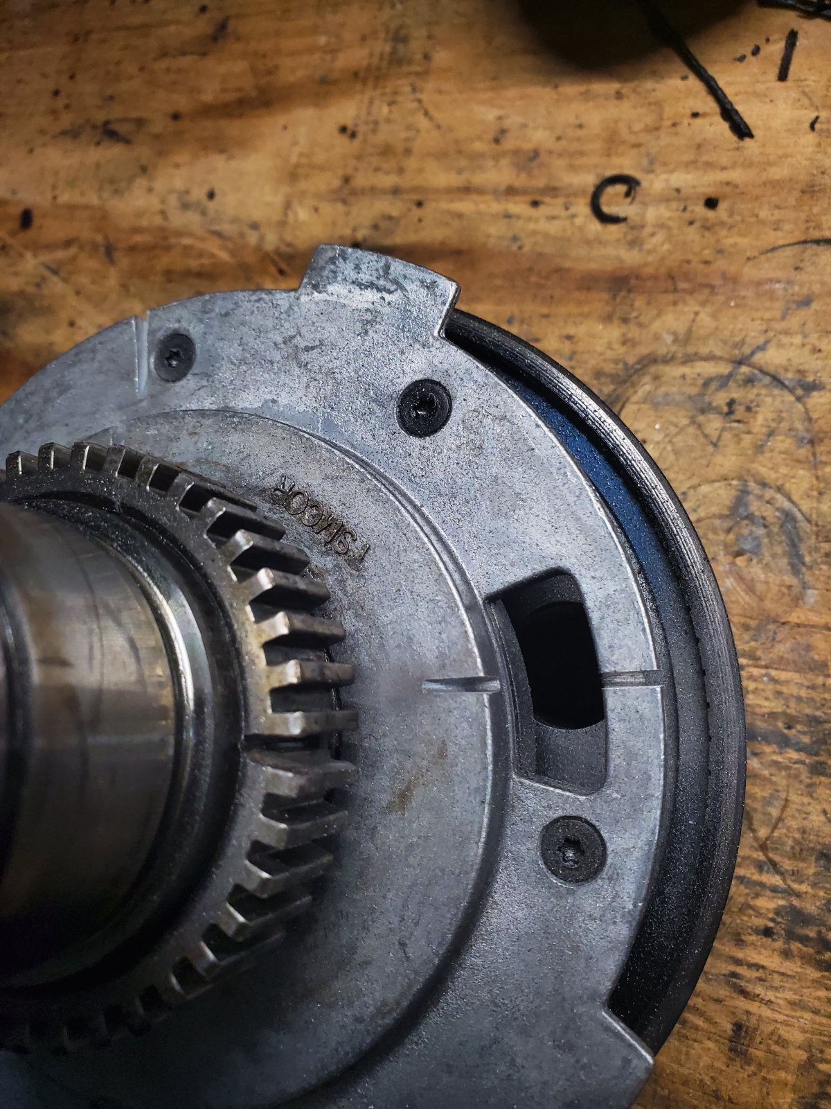

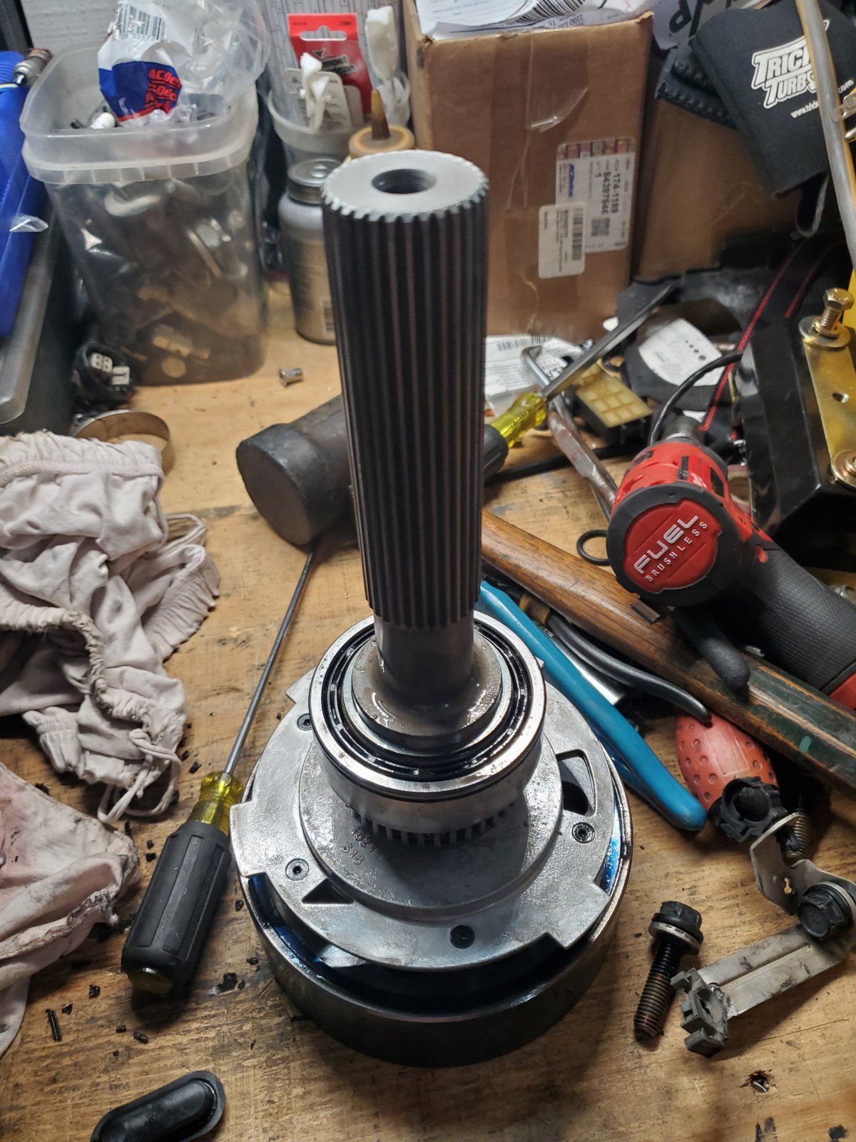

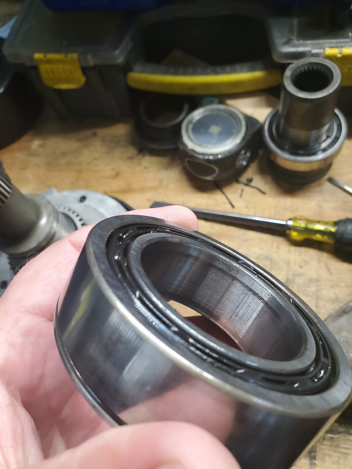

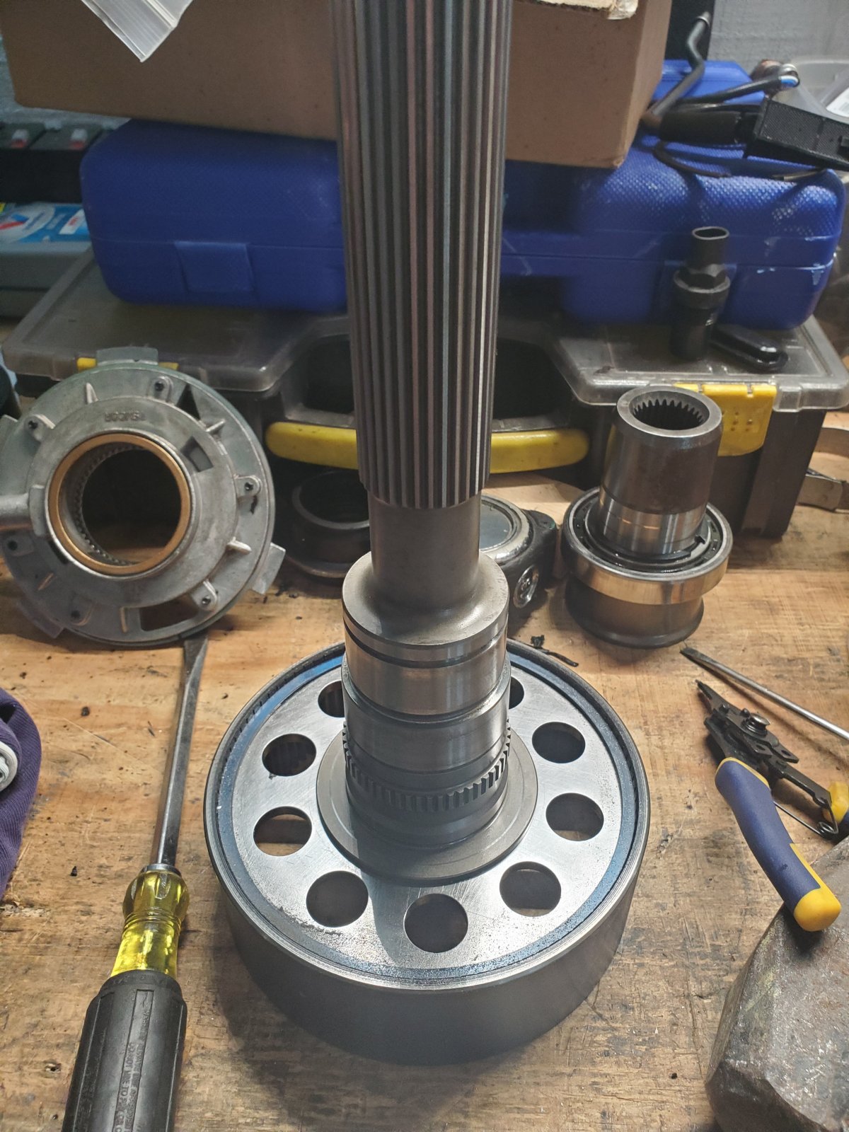

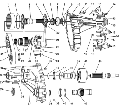

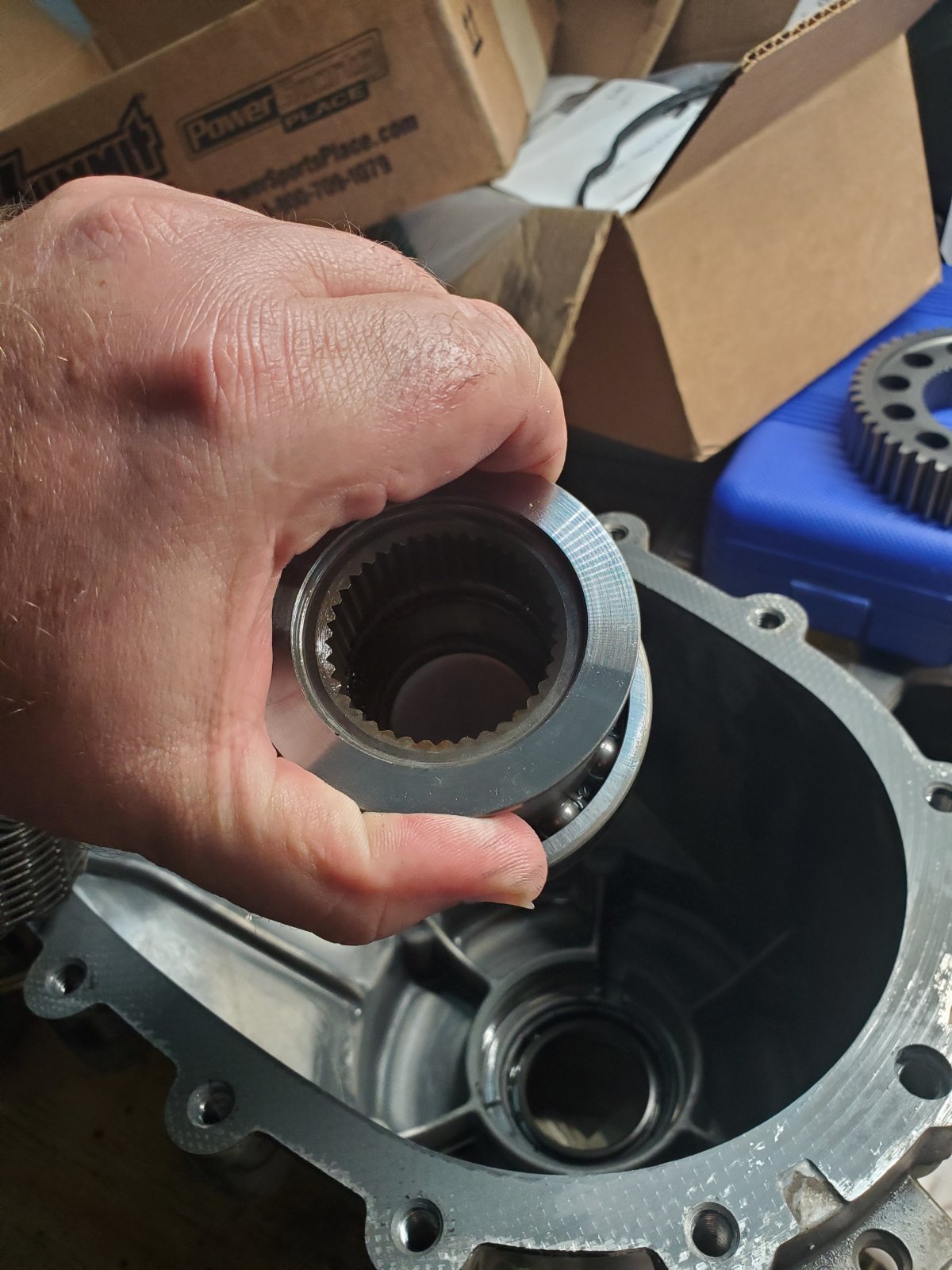

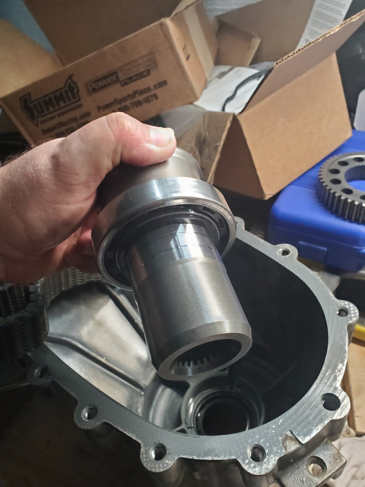

having hell of a time breaking down this transfer case, i need to (and did) order a proper pair of snap ring pliers for these larger ones. im trying to get to the "pump" as i can see theres some aluminum shavings all around where it sits on the output shaft. every vid ive watched they pull the snap ring and literally just remove the bearing by hand- as it should cause its held there by a snap ring. and then the reluctor for the speed sensor just slides right off after it. well i managed to hold and beat the shaft out of the bearing by hand which wasnt fun, and the reluctor seems just as tight going to try and hit it with some heat tomorrow.
4 (pump) ,5(snap ring),6(reluctor),7(bearing),8(snap ring) at the top
ended up just ordering entire rebuild kit - seals, bearings, chain, sprockets, pump, viscous coupler... the one in here seems to be leaking a little, refurbs were 300-400 :eek: without having a test bench, to test it you need to run it for half hour , lift the back, set parking brake, take out the front driveshaft, rotate front side of transfer case with 15ft lbs just to determine if its good. figured it couldnt hurt to have a spare since i break everything anyway.

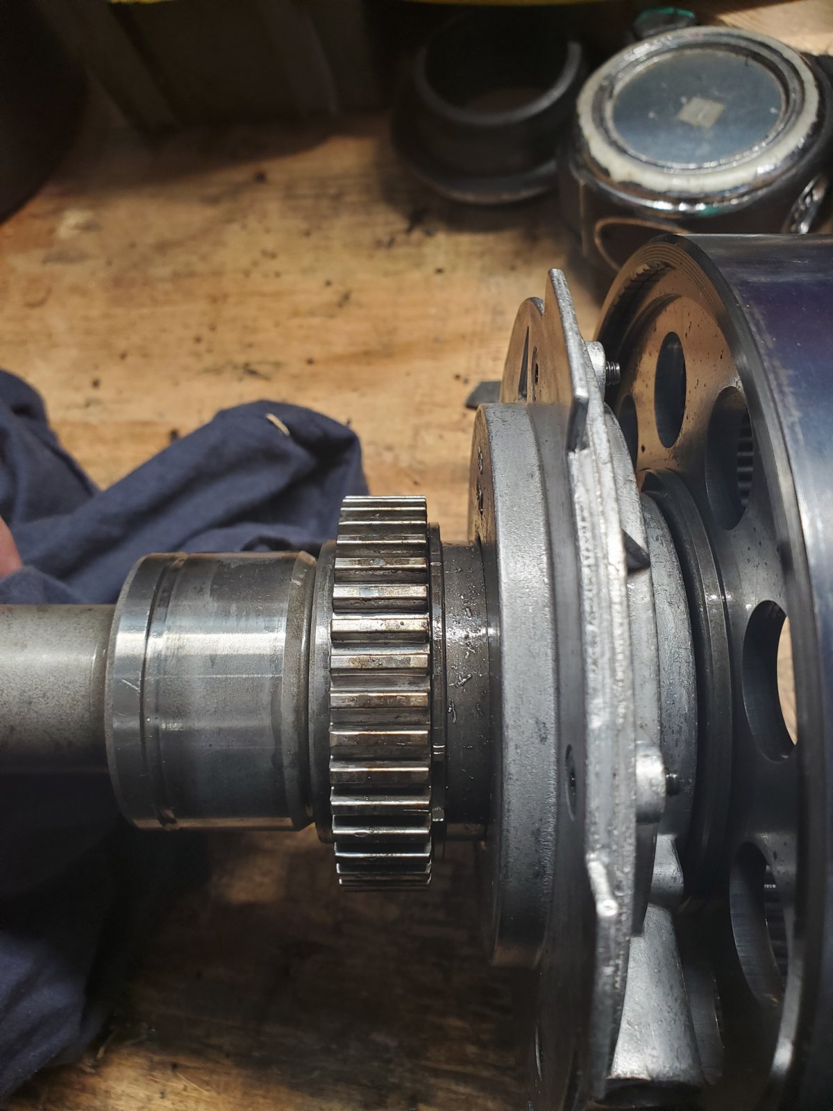

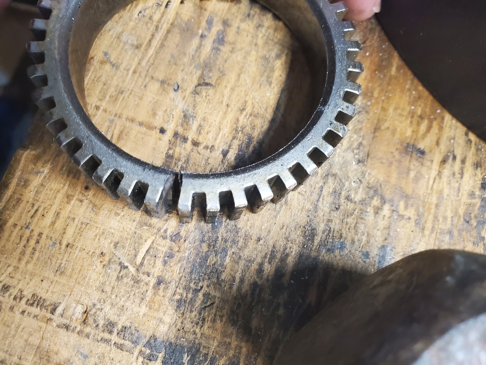

Gave it the fire with no luck...sooo made executive decision to cut that crap off. It wont be needed since I dont use speed sensor from there. There is a shoulder that the bearing bottoms out on and a snap ring that holds the pump up, so not needed for spacing or anything. Also looks like top edge of the teeth were hammered to get it on at one point.

Gave it the fire with no luck...sooo made executive decision to cut that crap off. It wont be needed since I dont use speed sensor from there. There is a shoulder that the bearing bottoms out on and a snap ring that holds the pump up, so not needed for spacing or anything. Also looks like top edge of the teeth were hammered to get it on at one point. View attachment 239371 View attachment 239372 View attachment 239373 View attachment 239374 View attachment 239375
Yeah, those teeth are fooked! WTH

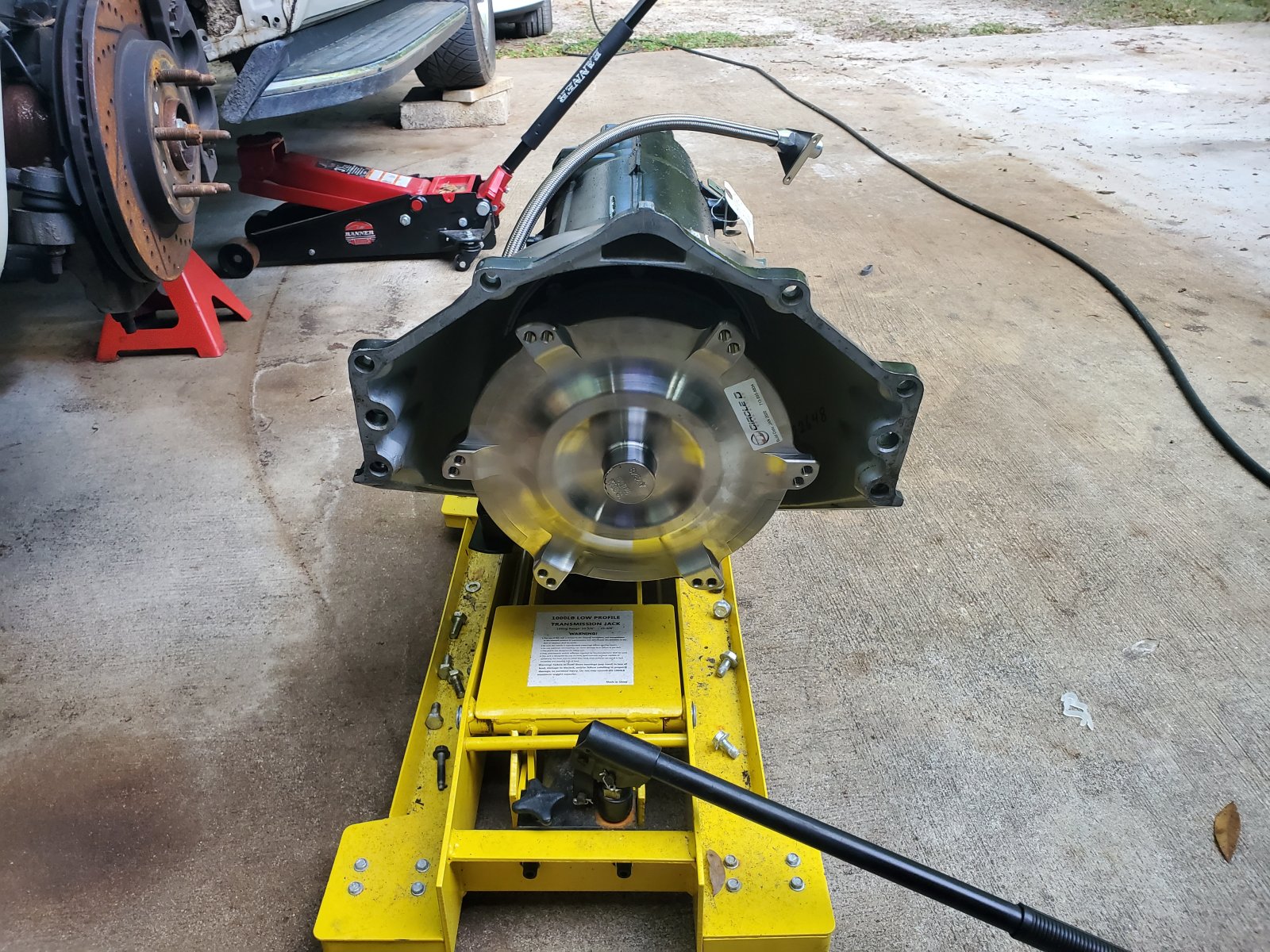

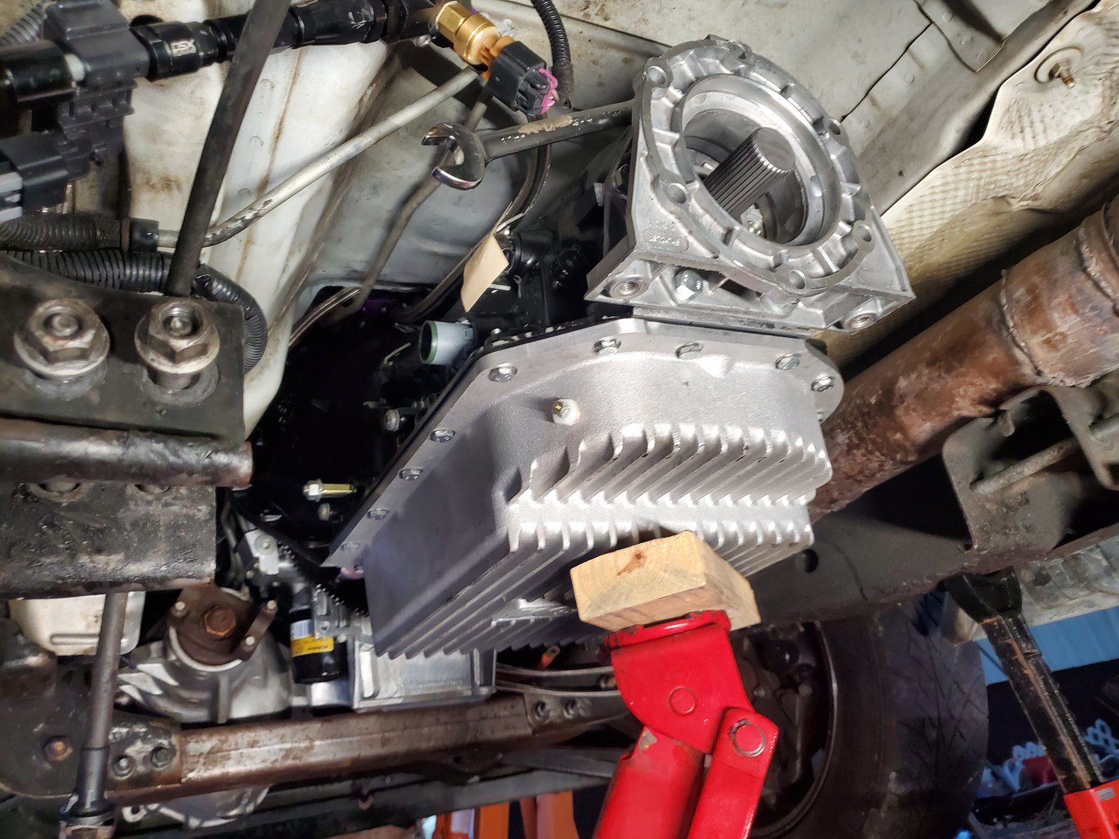

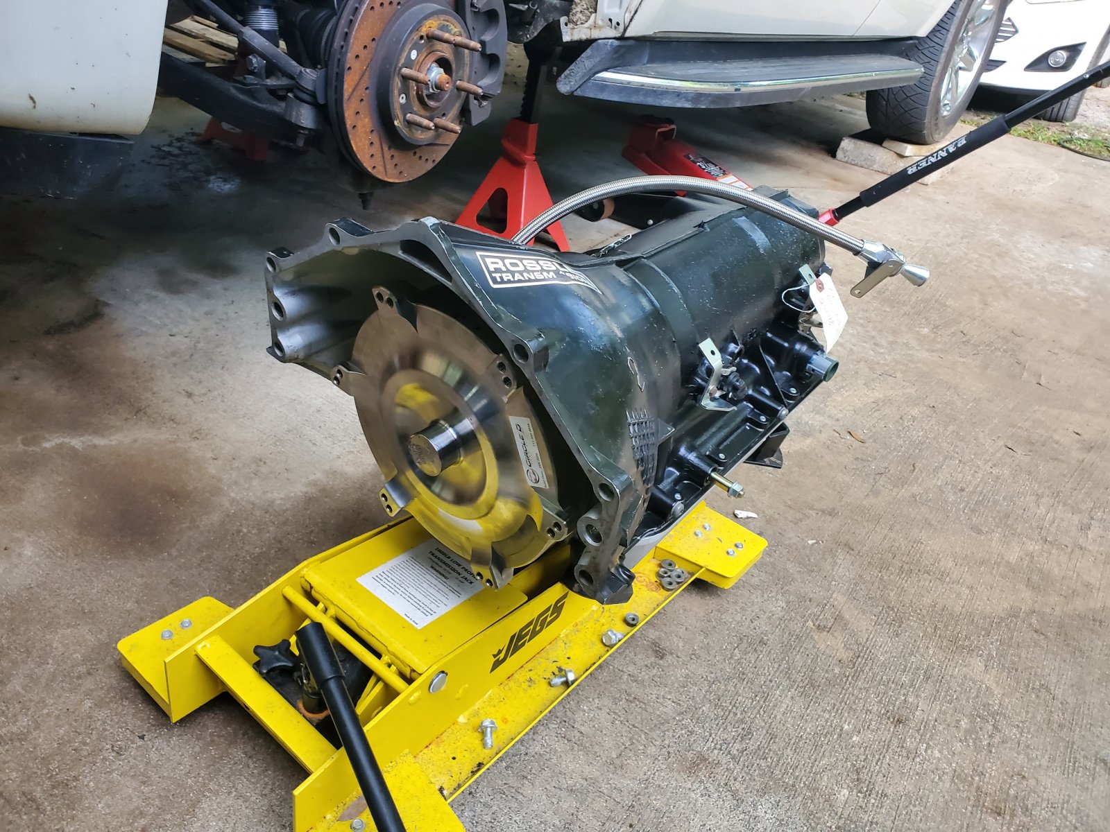

transmission "refresh" has been paid for and should be thrown on the shipping truck in the morning.
the initial cost was a little tough to swallow for this trans if youve followed along, so for the last month I have had this pit in my stomach that the cost to fix it was going to be way up there - I have spent a retarded amount on this crap in the "hopes" of making it reliable.... i joke alot about its only money n crap but i am a pretty cheap fukk most of the time. the longer this took the more i started looking at local shops that i could use in the future to avoid the shipping and (hopefully)downtime.
i realize in this game im playing there's rarely warranties outside of obvious builder and craftsmanship errors, something breaks i just want it fixed. i'm straight up with these guys and telling them whats wrong, steps ive taken, anything i doubt about doing the work my own self. i dont blame problems on people, i dont ask for anything free, sponsorships, discounts, etc.
i fully expected the cost to be (minimum) cost for a tear down/assemble $1800, hard parts $5-700(planetaries/pump), shipping roundtrip $500, probably some other misc shop supply charge @$150 and, to me, that would be totally fair and reasonable.
so talking with them today he starts rattling off everything that needed to be done, cleaned up, tested, etc. and and im here thinking the longer this goes the more its going to be... andddd grand total for me a little shy of $2000 total (phewww relief) all said and done back to me. it was way cheaper to have them ship it using their freight account (than to ship without a freight acct) like $220 for them, $600 for me to ship it. so that means right off the bat ~$500 of that is gone just for shipping. hardparts replaced planetary something like this: http://www.tcsproducts.com/products/product/4l80e-overdrive-planetary/ pump im sure they use atleast a genuine pump so $150-300, $500 total parts. so we're down less than $1000 for labor and misc supplies, testing, cleaning. i dont doubt they can probably rebuild one of these in a few hours so i doubt they're "losing money" but that is what experience costs . in either case i am happy with them, no regrets on going with them
