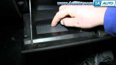

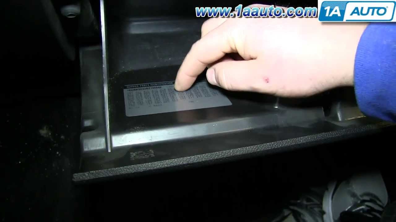

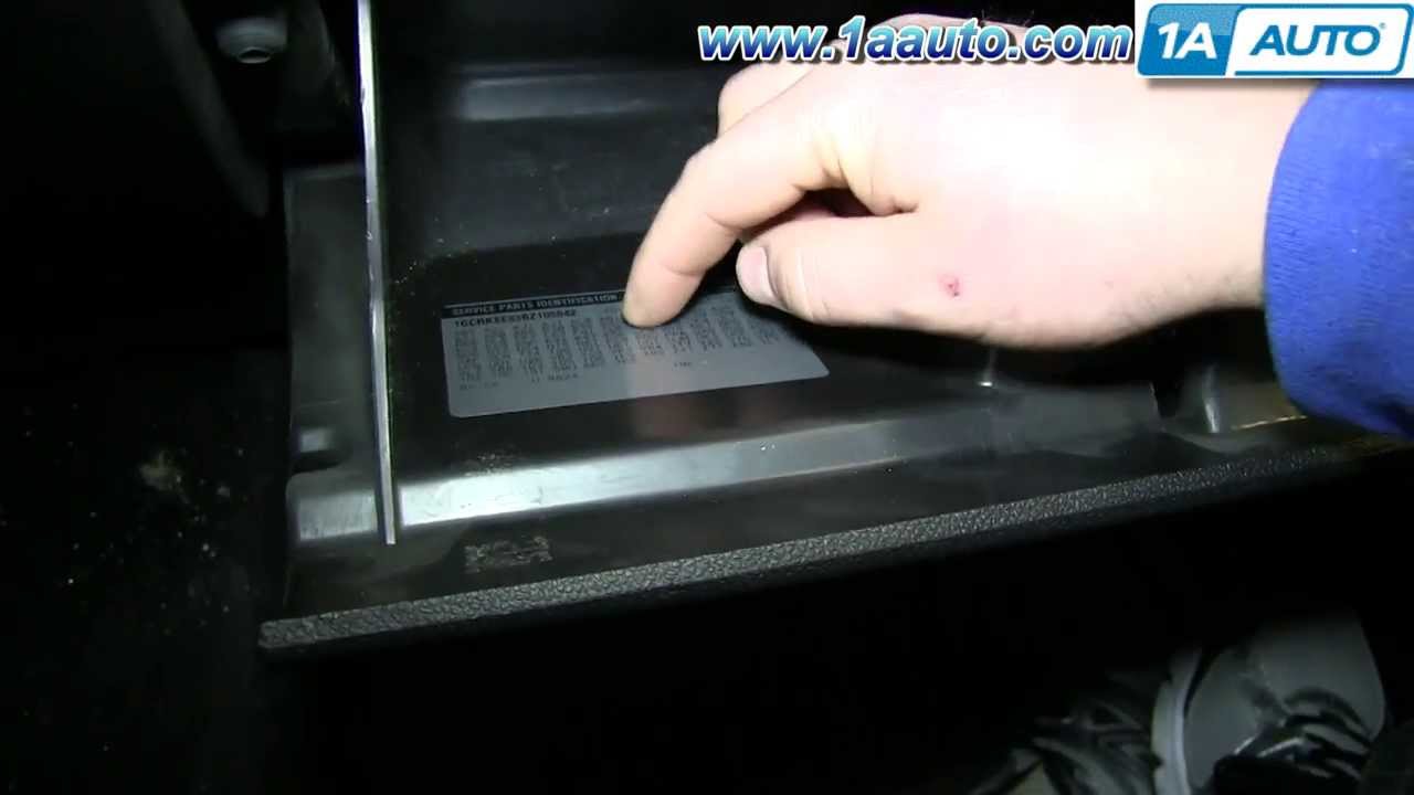

To make sure the Radio plays right it need to be coded to the right speaker system that in the vehicle, we will need your speaker code. To find the speaker Code you will need to look at Service Parts Identification label that is Found in the you car glove box.

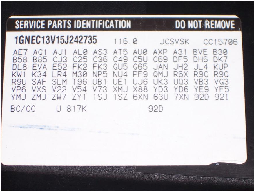

1. EXAMPLE PHOTO BELOW, THE SPEAKER CODE IS A UQ7 THE RADIO CODE IS UB1, THIS VEHICLE CAME WITH AM/FM/CASS/CD RADIO WITH ANALOG BOSE AMP YOU WOULD ORDER A RADIO SET UP FOR UQ7 YOU CAN GO BACK TO A CASS/CD OR UPGRADE TO A CD6 OR NAV RADIO. YOU CANNOT USE A UM7, U1C, AND UBO OR UNO THESE WILL NOT TURN ON A BOSE AMP.
2. EXAMPLE PHOTO BELOW, THE SPEAKER CODE IS A UQ3 THE RADIO CODE IS UB1, THIS VEHICLE CAME WITH AM/FM/CASS/CD RADIO WITH BASE SPEAKERS NO AMP YOU WOULD ORDER A RADIO SET UP FOR UQ3/UQ5 YOU CAN GO BACK TO A CASS/CD OR UPGRADE TO A CD6 OR YOU CAN USE A UM7, U1C, AND UBO OR UNO. YOU CANNOT USE A NAV RADIO, NAV RADIOS REQUIRE A BOSE AMP.

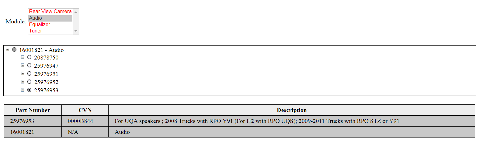

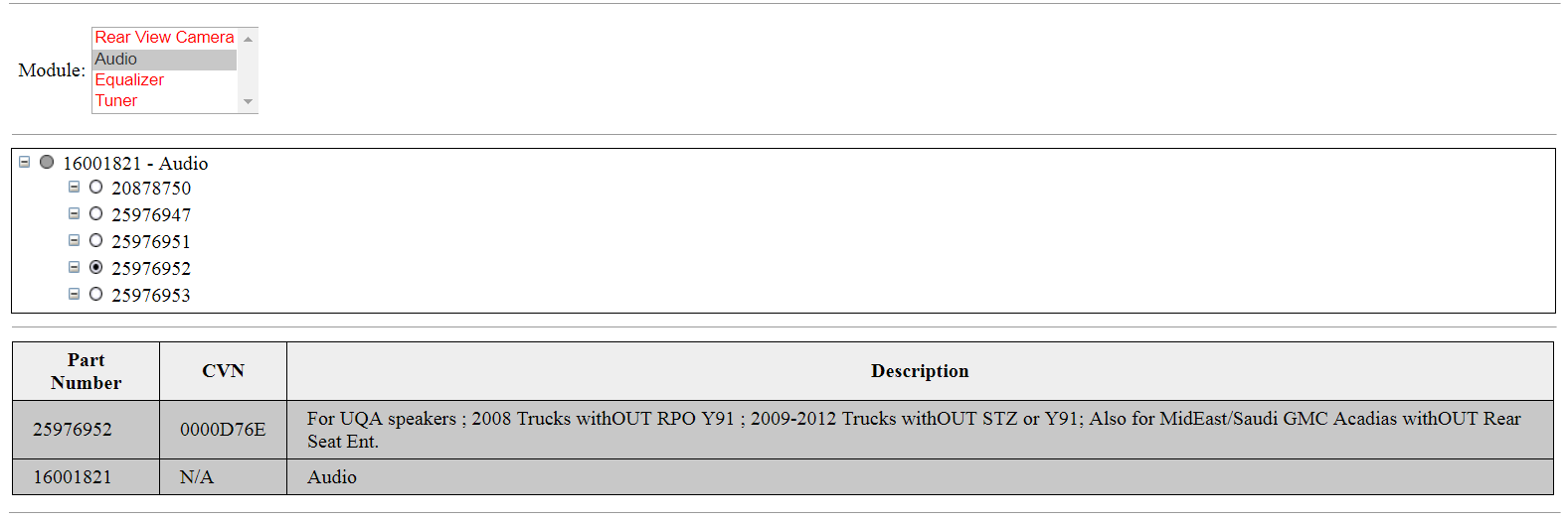

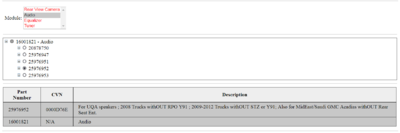

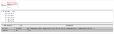

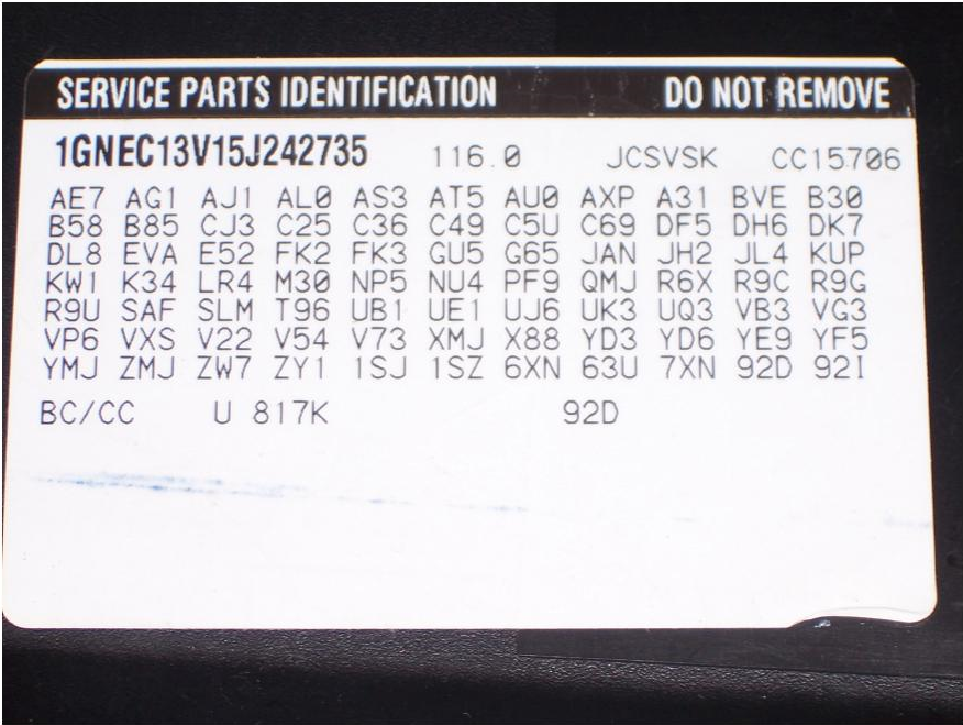

Thanks Ken! My '09 and those other two guys' '09s all have UQA RPO code. They both have rear a rear DVD and the UVB Navigation Radio, mine does not have a rear DVD system and has the U3U Navigation Radio. They both have the center speaker on the dash, mine does not. Neither has Y91 or Y92.
I don't think our friend from Kuwait's post answers the why yet. Maybe he knows. Ejbarah, thanks for posting friend! Do you know why some systems have the center dash speaker without Y91 or Y92? Presumably, they do not have the smart amp.

Rear DVD it's just an options when you buy your car.
Some cars comes with rear ENT with center dash speaker and UVB (RADIO AM/FM STEREO, SEEK/SCAN, AUTO TONE, CD, CD-R MP3, DVD, NAV, CLOCK, ETR, RDS)
Others comes with U3U (RADIO AM/FM STEREO, SEEK/SCAN, DVD, CD, CLOCK ETR, NAVIGATION, VOICE REC, MP3) with center speaker and without center speaker.
GM has two option for one RPO.
I know it's confusing but look at this and you will know what GM offering.
This is just example :
UX6 SPEAKER SYSTEM,FRONT DUAL DASH MOUNTED
UX6 SPEAKER SYSTEM,2,CUSTOM
UX7 SPEAKER SYSTEM,4,DUAL FRONT DOOR MOUNTED,DUAL EXTENDED RANGE PACKAGE SHELF
UX8 SPEAKER SYSTEM 8, DUAL F/D MTD, DUAL RR DRS, DUAL MIRROR PATCH CTR I/P, PKG SHELF, AMPLIFIER
UW4 SPEAKER SYSTEM,6,DUAL FRONT DASH MOUNTED,FRONT DOOR,DUAL EXTENDED RANGE SHELF
UW5 SPEAKER SYSTEM 6, BASE
UW6 SPEAKER SYSTEM,6,DUAL FRONT DOOR TWEETER & WOOFER,DUAL EXTENDED RANGE
UW2 SPEAKER SYSTEM -10, QUAD FRT DR MTD, DUAL RR SAIL PNL, AMPLIFIER
UW0 SPEAKER SYSTEM 4,DUAL FRONT INSTRUMENT PANEL MOUNTED,DUAL ROOF MOUNTED
US2 SPEAKER SYSTEM 6, DUAL F/D MIR PATCH TWT, DUAL F/D
UC5 SPEAKER SYSTEM 6, QUAD FRT DR MTD, DUAL EXT RGE RR DR MTD
UBD SPEAKER SYSTEM 8, BASE
UQA SPEAKER SYSTEM PREMIUM PERFORMANCE ENHANCED AUDIO
UQF SPEAKER SYSTEM STANDARD AUDIO
UQG SPEAKER SYSTEM ENHANCED AUDIO WITH AMPLIFIER
UQH SPEAKER SYSTEM PREMIUM AUDIO BRANDED WITH SURROUND AMPLIFIER, AUD IOPHILE
UQP SPEAKER SYSTEM 10, PREMIUM
UQQ SPEAKER SYSTEM STANDARD, SINGLE
UQS SPEAKER SYSTEM PREMIUM AUDIO BRANDED WITH SURROUND AMPLIFIER
UQ0 SPEAKER SYSTEM,4,DUAL FRONT DOOR MOUNTED,DUAL STANDARD RANGE PACKAGE SHELF/QUARTER
UQ0 SPEAKER SYSTEM,4,DUAL FRONT DOOR MOUNTED,DUAL STANDARD RANGE PACKAGE S UQ1 RADIO,PROVISIONS FOR STEREO
UQ2 SPEAKER SYSTEM,4-SPEAKER,F/D MIR PATCH TWT,F/D HSS,EXT RGE RR QTR
UQ2 SPEAKER SYSTEM DELUXE AUDIO UQ3 SPEAKER SYSTEM,PERFORMANCE ENHANCED AUDIO
UQ4 SPEAKER SYSTEM,BOSE 4-SPEAKER,INCLUDES AMPLIFIER UQ4 SPEAKER SYSTEM 4, BASE
UQ5 SPEAKER SYSTEM,4,DUAL FRONT DOOR MOUNTED,DUAL EXTENDED RANGE QUARTER MOUNTED
UQ6 SPEAKER SYSTEM 11,QUAD FRT DR.RR DR,DUAL RR PACKAGE SHELF,CENTER IP UQ7 SPEAKER SYSTEM,BOSE,PREMIUM PERFORMANCE
UQ8 SPEAKER SYSTEM,4,DUAL FRONT EXTENDED RANGE,DUAL EXTENDED RANGE PACKAGE SHELF/QUARTER
UY5 SPEAKER SYSTEM 4, DUAL FRT FLR SILL, DUAL EXT RANGE QTR MTD
UY5 SPEAKER SYSTEM 15, DELUXE
look at this U3U NAV unit serve two options for Audio :)
