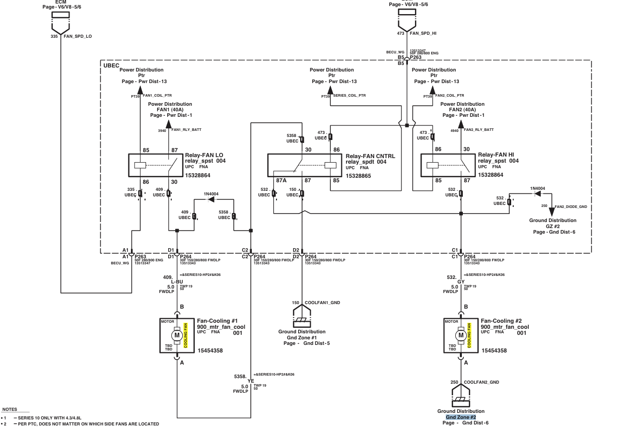

Got an 09 tahoe w an e38 computer. 5.3/6l80e truck and the e fans will not turn on unless commanded thru scanner or truck overheats. The connectors are in good shape but have no power or ground on dr side fan connector and only ground on pass side fan connector. All relays are good and fuses I’ve tested and swapped it all. PCM body has intermittent ground signal according to my power probe and didn’t know if anyone has had this issue before. I’m thinking pcm is bad but Cant find any culprits, any help would be appreciated! Truck has codes that aren’t really issues as well. Map sensor and o2 codes yet they all read and are fine. I’ve replaced the map with a gm genuine sensor and code still shows.

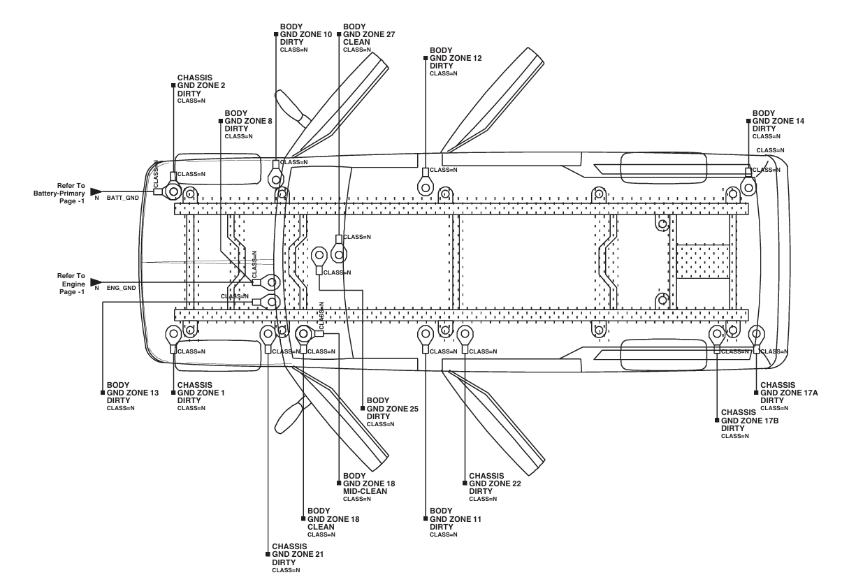

From what I can tell the fans use G100 and G101. See the links below from www.charm.li. Verify your vehicle info before using these diagrams.
Locations are #6 and #8:

all wiring ive seen looks good ive pulled the ecm off and checked the pins for corrosion etc and the fan connectors as well. i pulled off my front bumper and checked the grounds on both lower core support mounts and those have good consistent ground signal and checked all other engine grounds. when key is off all grounds are good. im thinking its the ecm maybe prev owner shorted it doing a battery swap but could i try grounding the coolant temp sensor wire maybe or would that short my ecm worse. ecm has consistent .5 volts on the ecm body itself while running though. not sure where the ecm grounds tho ive searched through diagrams and cant find it

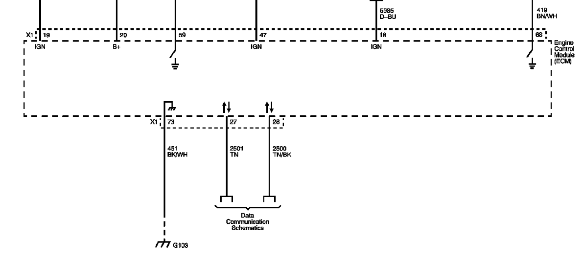

Verify that I selected the correct vehicle. The main ground for the engine computer is G103:
G103 is on the passenger side of the engine - unless it's been moved for one reason or another; I can't tell if it's on the head or the block, but here's the link to the pic (see the comment about RPO HP2):

I’ve found the intermittent ground/.1- 2v signal on the radio harness, seat harness, relay control circuit that controls all engine grounds. If I unplug the neg battery terminal my fuse block still has 11.3 volts so something with a capacitor is back feeding short to to ground only with key on. The vcim has the ground issue as well. Body control module isn’t affected though. There’s all chasis grounds are good and no interruption other than the few left under carpet and seats and maybe in the rear of the Tahoe. Strongest short voltage I’ve gotten is on the radio harness where I saw 1.8 volts rather than the typical .1-.4
