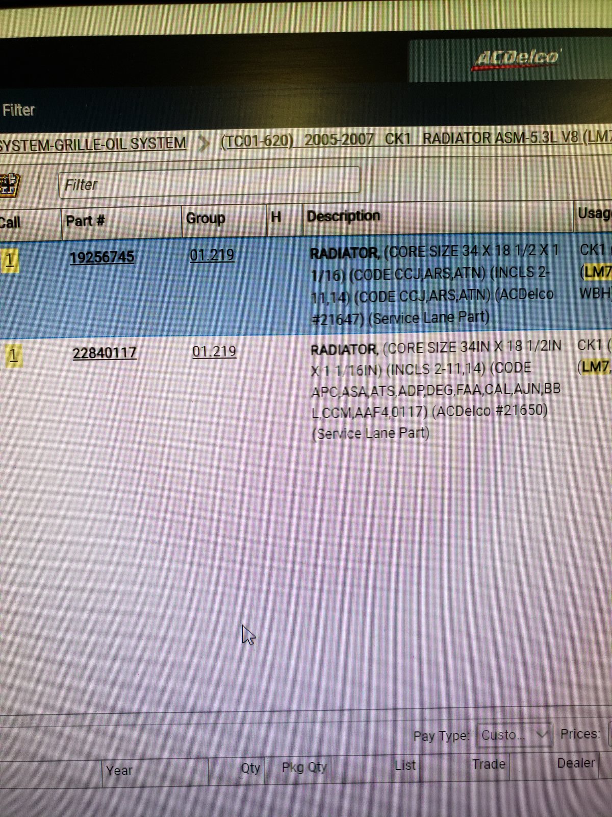

With "T" as the eighth digit, he has a gas engine, like me. I looked at both radiators at RA and matched the RPO codes from his rig to the gas engine options and not one of the RPO codes matches his RPO code pic. If I look close enough, I just did, it lists the exact same RPO codes for gas or flex fuel.
IMO, I would go with the one that fits mine, and likely yours, because of yours being the same rig as mine.
Posting the last 8 digits of the VIN: 5R208540....hopefully @915_Tahoe will chime in. He is the genius with this stuff.

Ugh. Everything seems to be breaking lately. Noticed antifreeze leaking and then the "service airbag" message pops up.
Radiator finally gave out.
Upper right side of the radiator I noticed these cracks.
Would anyone happen to know what size radiator I need for an '05 Z71? I tried measuring it without taking everything apart and I think it's 34" wide x 1-1/4 thick. Not sure of the height. The last 8 of my VIN is: 5R208540
Vin# is showing 2 sizes for your truck. If you can get the 3 digit code # off the radiator and cross the ones i posted so you can get the correct one.
