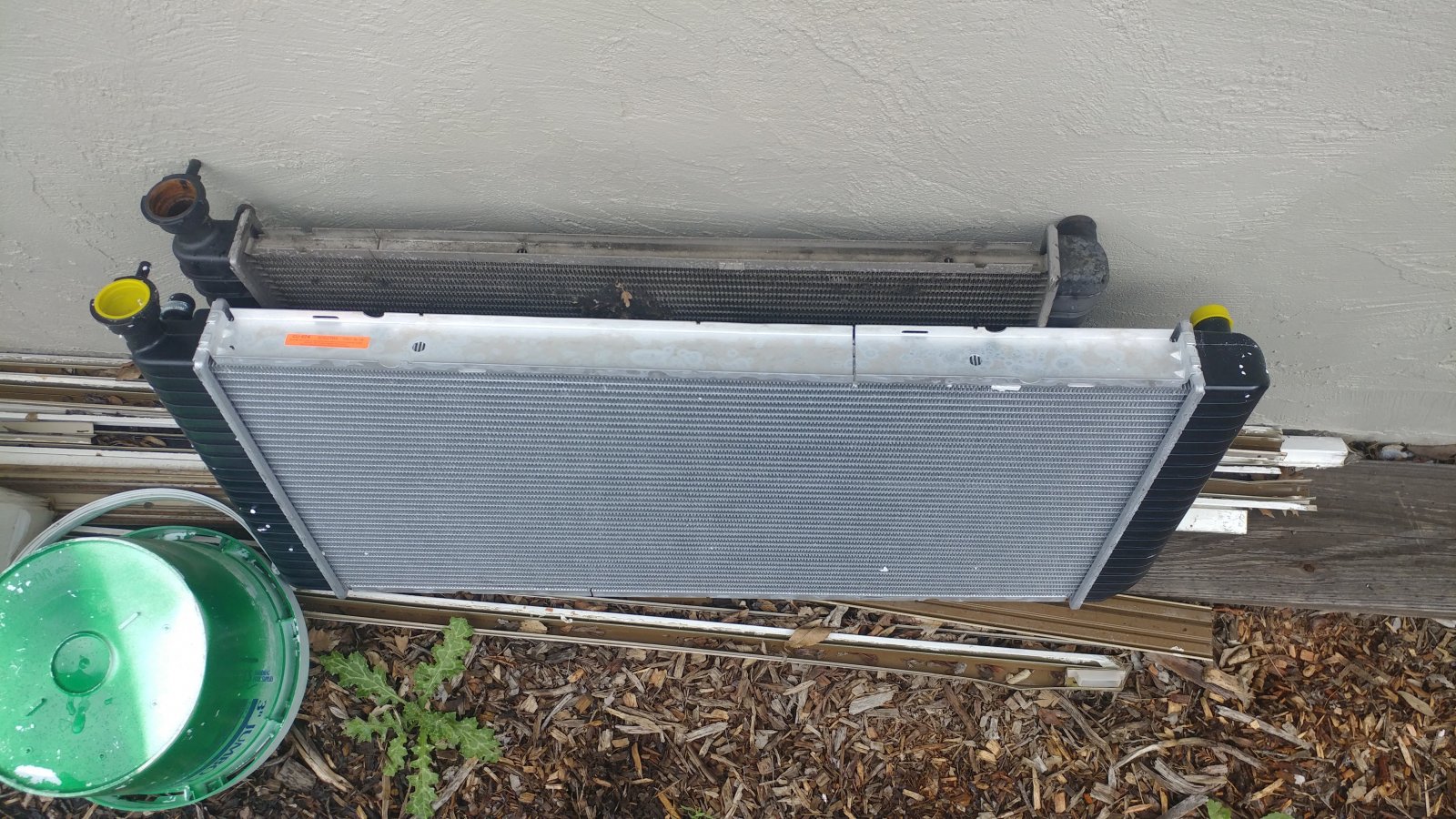

having trouble finding an exact replacement by the usual way. i cross referenced on ebay that gave me a parts number that lined up with an AC delco radiator but it says "GAS; Excluding Rear Auxiliary Air Conditioning(C69); CORE SIZE 28-1/4 X 17 1/8 X 7/8; CODE JDS,AAT,CAN,AJR,GAN (DRAIN **** ELIMINATED); 4 speed Automatic trans." my RPO sticker says C69 i cant find any of the other codes on this one or another listed. anyone know where i can find this info?
2004 chevy tahoe 5.3l V8 LT it is not the flex fuel version. the Vin is T.

update: the bigger one was the correct one thanks for the replies guys. the original was cracked, 130K.
