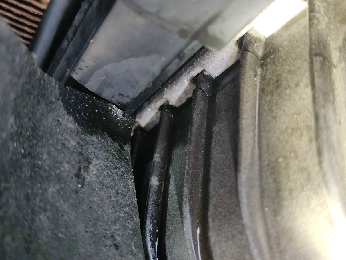

Ugh. Everything seems to be breaking lately. Noticed antifreeze leaking and then the "service airbag" message pops up.
Radiator finally gave out.
Upper right side of the radiator I noticed these cracks.
Would anyone happen to know what size radiator I need for an '05 Z71? I tried measuring it without taking everything apart and I think it's 34" wide x 1-1/4 thick. Not sure of the height. The last 8 of my VIN is: 5R208540

Plug your VIN in here and have a look: https://parts-catalog.acdelco.com/catalog/catalog_search.php
I come up with 21647 or 21650 but do not know your RPOs. You're about spot on with the dimensions, 34 x 18-1/2 x 1-1/16!

the 34" radiators are all basically the same with 1 key difference, either they come with a oil cooler option or no oil cooler, even if you do not have the oil cooler you can still use one with the option. generally they all have a transmission cooler option.
the cheap re-pops are usually only 1" thick, best to try to for at least a little thicker some come 1 1/8"
other than that they all fit and work

I have a 2005 Z71 and mine is the Genuine GM part #21647. RPO codes do make the difference to get the correct one. Simple to check them. If you actually need the 21650, as per RPO codes, likely still time to cancel the other one.

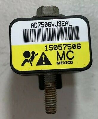

I bet the airbag sensor on the driver side, underneath crapped out. Super common on these. I had the same issue. Replaced mine with a used one--gtg.

ABS - airbag sensor?
Not sure what DS is.
Do you mean something like this? https://www.ebay.com/itm/383876821422?hash=item5960d771ae:g:-BsAAOSwp19f51w0
I fixed my post. I don't know why it posted as abs. Should've said srs. Ds is the driver's side.

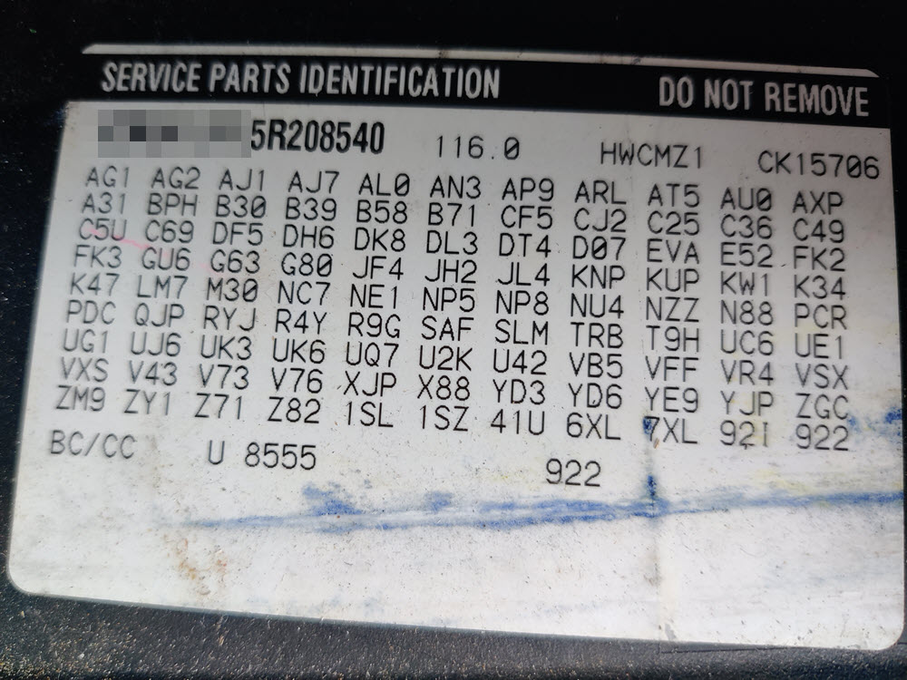

If you look inside the glove box cover, the RPO codes are listed there. Much easier for us to read if a pic of that is posted here. Only care about the codes and not the description when looking for correct application. If you notice, at RA, the two choices we have given are the same size. I had to look thru all the RPO codes, listed at RA, for each radiator part number to make sure I ordered the right one. PITA sometimes but is important. If you will post a pic of those codes in the glove box, I will help look it up, if you wish.
This sensor--View attachment 345958

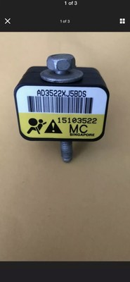

Is there any difference between that one and this one?
The one you listed is part # 15057506. The one RA lists for my truck is 15103522
Could there possibly be a difference between those two? It looks like such a simple part.
I would love it if you would teach me how to make heads or tails over the RPO codes!

He already listed his build sheet, that he got from some site, in post #3. I just don't want to scroll thru all of those descriptions. The pic he just posted is more up my alley.

Not really sure, but you can google the part number to see if it'll work for you, or stick your head under the frontend and peep it out. Either way will work.
EDIT--My hoe is an 03, yours may differ.
