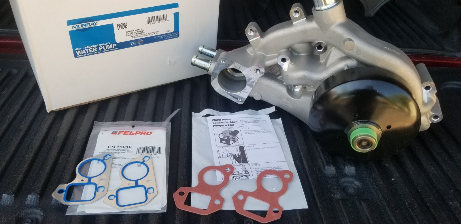

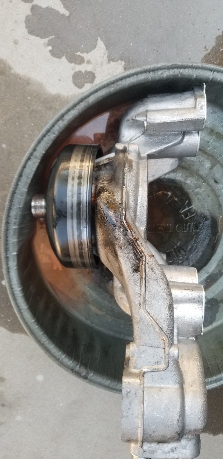

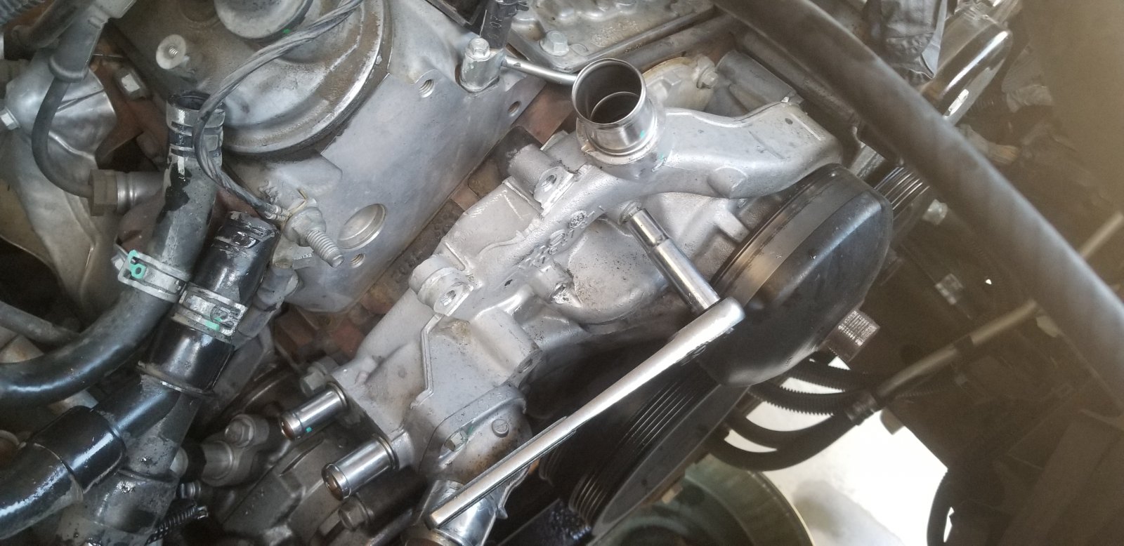

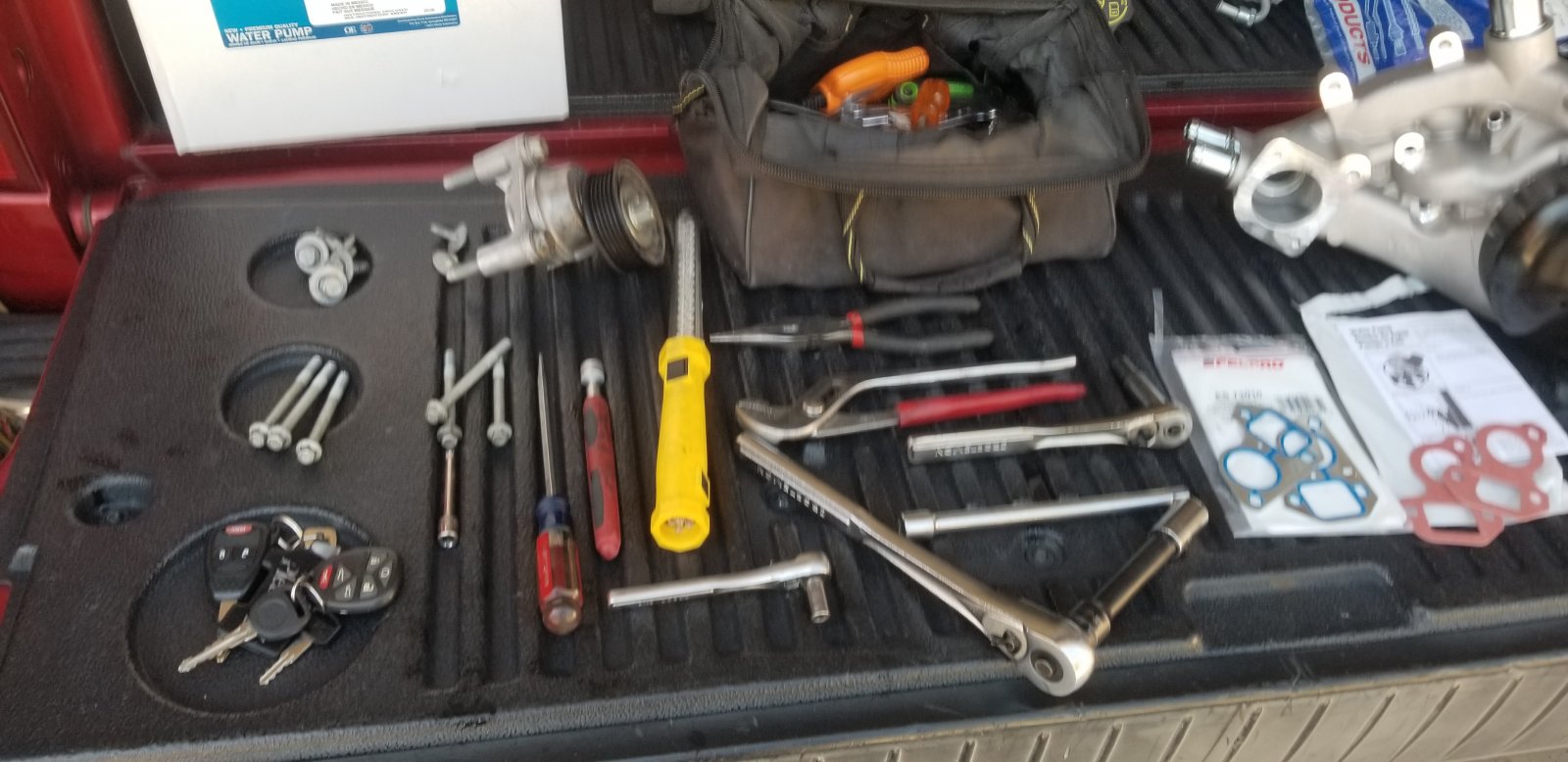

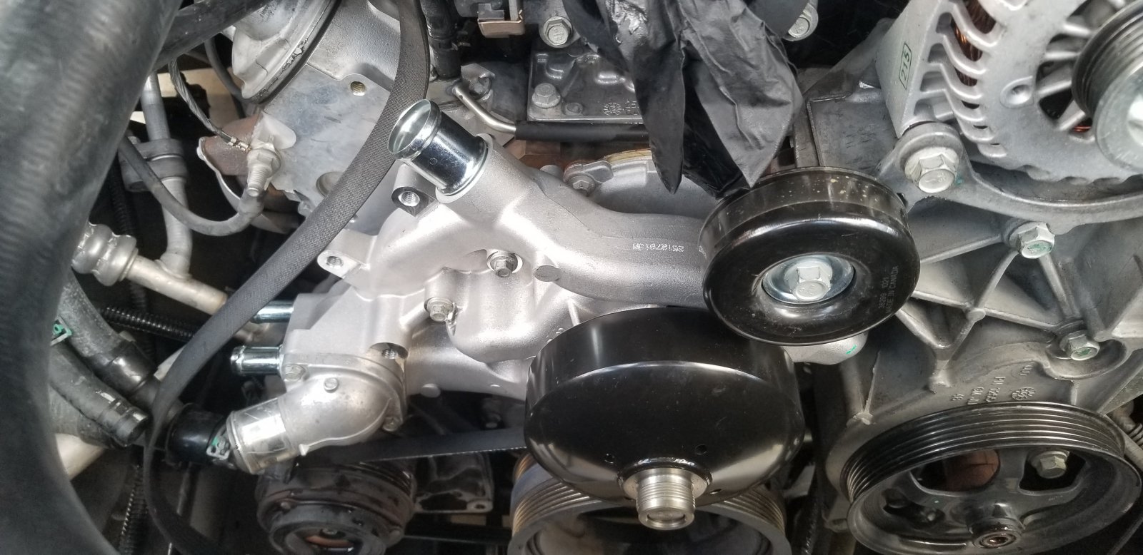

So I went ahead and installed the Murray HD pump on Saturday morning. It's specifically made for vehicles that still use a mechanical cooling fan. It's made in MX and supposed to have better bearings to support the added load of a mechanical fan/clutch. Time will tell...
Our Tahoe has dual electric fans, no mechanical fan, so hoping this one lasts much longer.

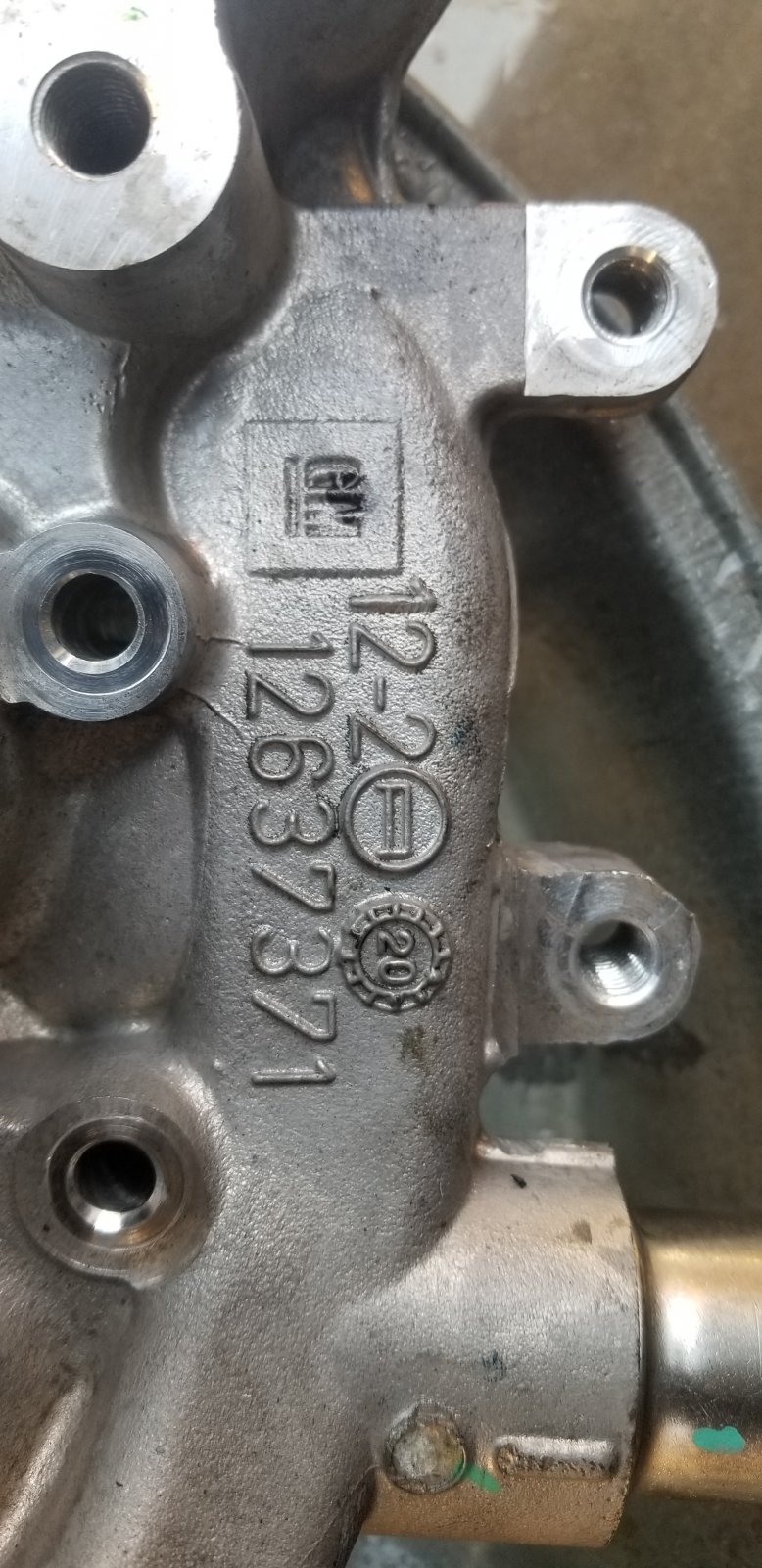

The 41K mile GM pump appears to have been slowly leaking for a long time given the dried-up/crusty Dexcool on its underside.

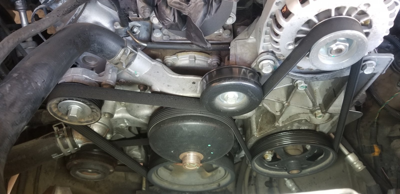

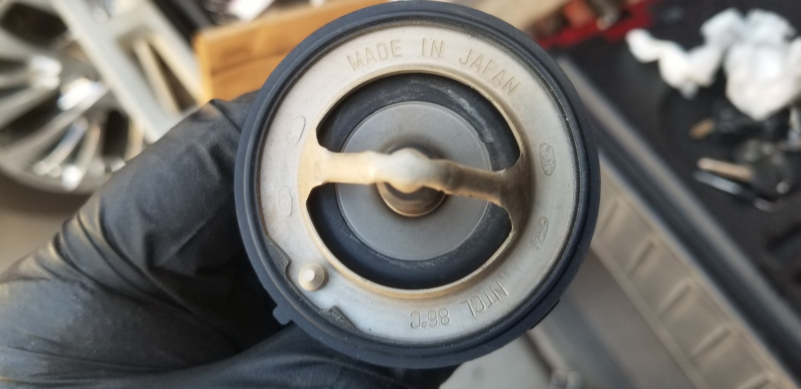

Was surprised to see the T-Stat that came with the GM pump was made in Japan. I'll consider that a bonus! Was just 4 years old, so went ahead and transferred it and it's housing onto the new Murray pump. The tensioner and idler pulley were new with the pump and were made by our friends up in Canada, also a bonus in my book. Both pulleys rolled freely, so left them be.

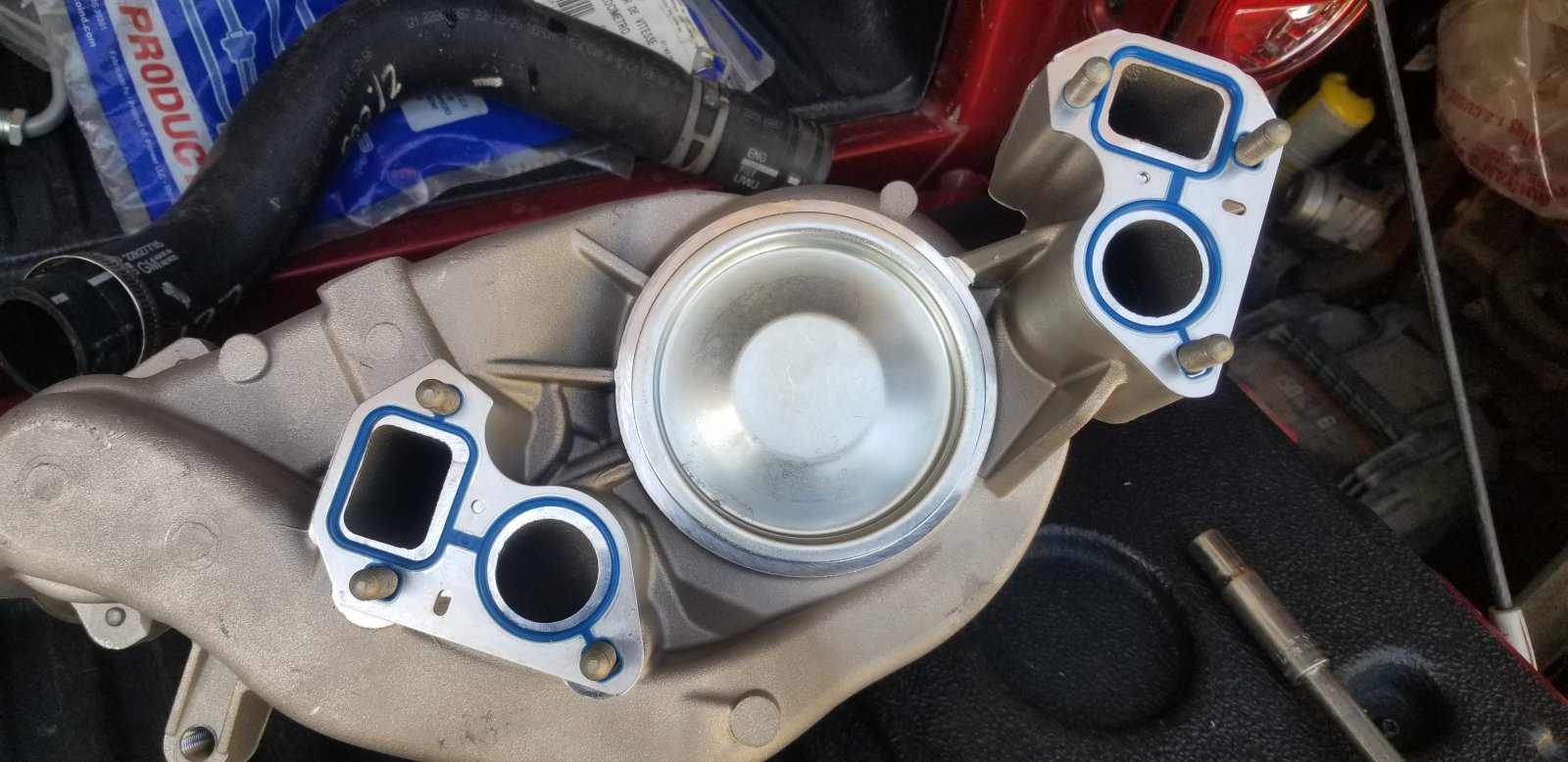

The new Murray pump came with fiber gaskets, so got a set of Fel-Pro aluminum bodied/O-ringed gaskets which I trust much better.

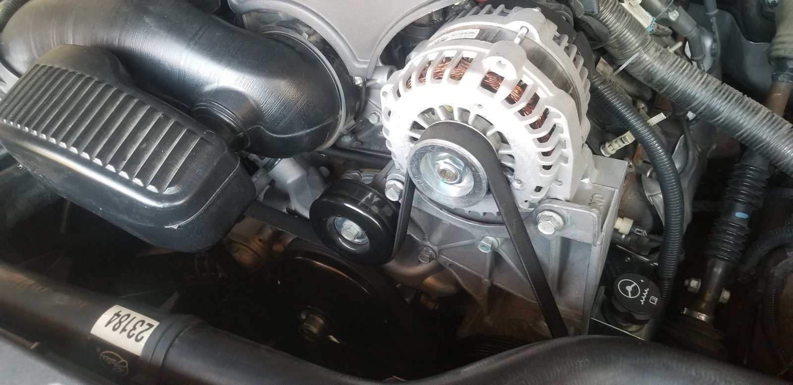

After removal of the old pump, thoroughly flushed and drained block, front/rear heater cores, radiator, coolant reservoir and hoses, blowing them through with compressed air. Re-flushed everything with distilled water and installed new pump, torquing the 6 bolts to 22ft/lbs. Refilled system with the Prestone version of Dexcool. Used 3 gallons of the full strength stuff, plus 2 gallons of distilled water. Burped the system and has reached equilibrium with the "Full" mark after 3 or so hot to cold cycles on Saturday PM/Sunday AM. No leaks or antifreeze odor! Entire Pump R&R, cooling system flush and initial fill/burp took ~5 hours start to finish. Wasn't difficult, just a bit time consuming.
Keeping the 41K GM pump in event I choose to have it rebuilt. Will add a few pictures when I have some more time to get them uploaded.

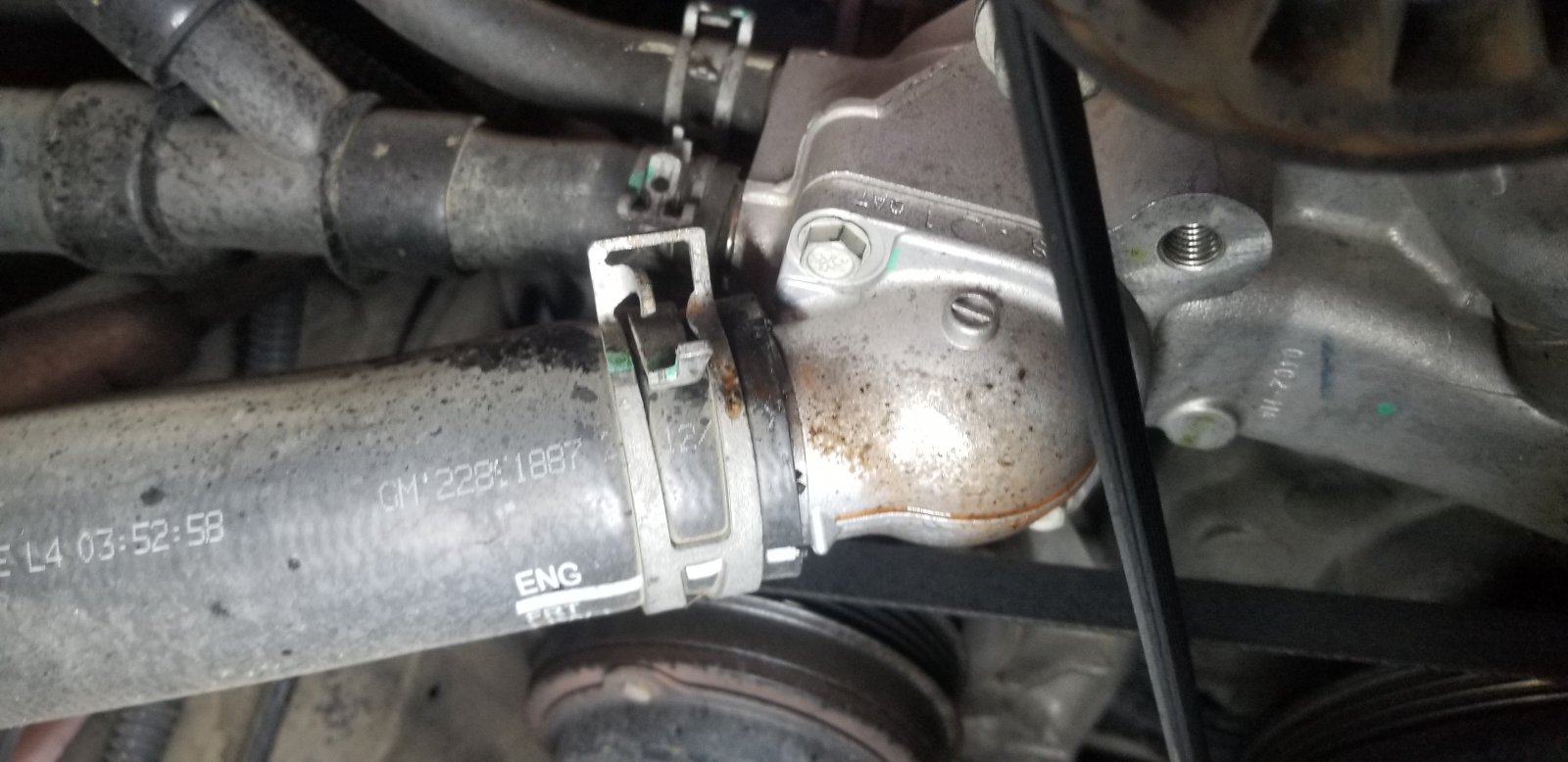

So my bride came home last night and as is usual in the summer months here in AZ, she popped the hood and turned on the fan in the garage to vent out the heat.
She noticed a strong antifreeze odor and gave me a shout. Sure enough, the water pump is leaking via the weep hole.
