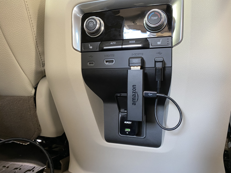

My kids have apple devices and we use ROKU is our home. I feel like a ROKU stick is bound to get kicked or broken if sticking out of those HDMI ports. Does running a cord from pad or phone to the USB-C work?
ytechie
Aug 15, 2020
22
12
Not sure why GM implemented Miracast. Android dropped Miracast support with v6.0, which was released in ***October 2015***.
I bought a couple of these 90 degree HDMI adapters to mitigate the risk of damage to the HDMI ports or devices.
https://www.amazon.com/gp/product/B00CF4G7JC
Great minds think alike. I also bought the 90 degree USB-C adapter: https://amzn.to/2HHMY9Z
And a short cable: https://amzn.to/3jqjACU
Just a heads up with the HDMI adapters. They are 2 different adapters, facing different directions. In other words, even though it's a 2-pack, you can only use one of them.
