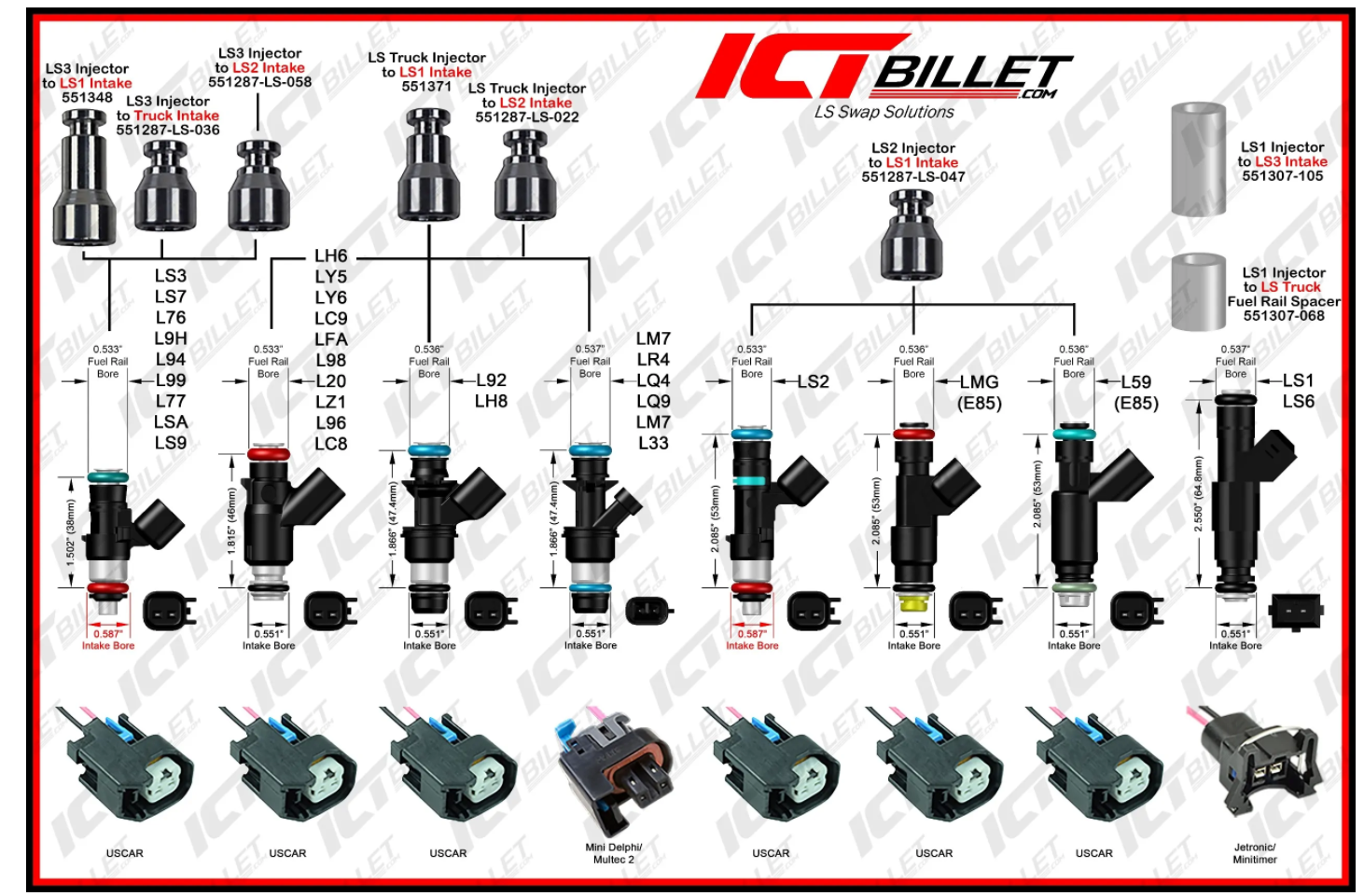

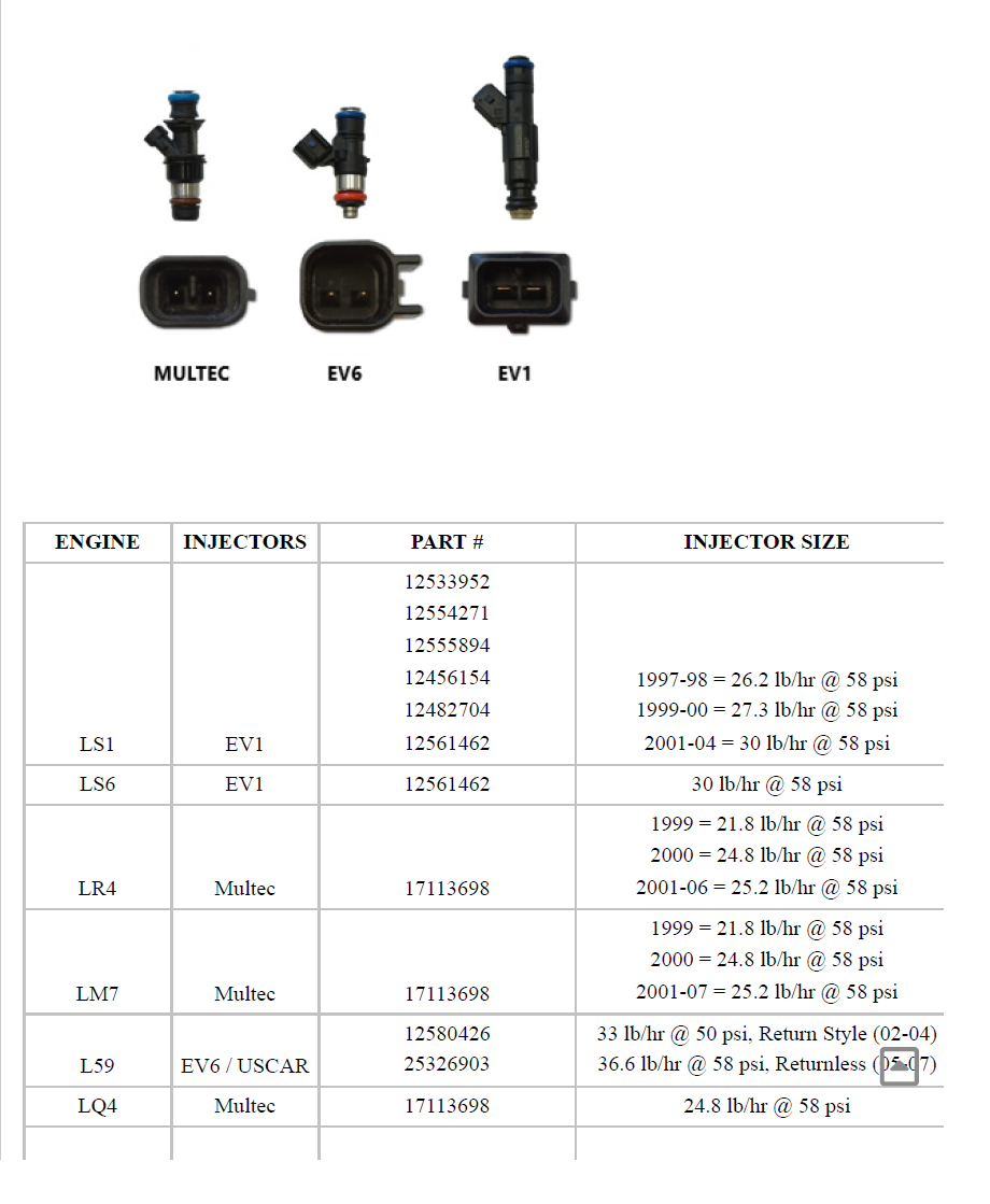

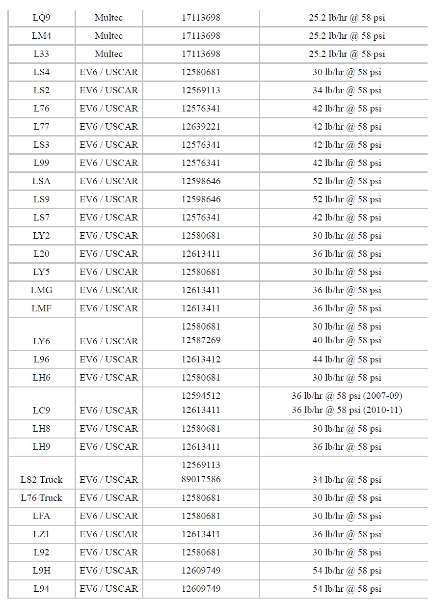

adriver
Aug 18, 2018
787
477
Here are the adapters to make whichever injectors fit properly with whichever rail.
You can find the adapter harnesses for about $50 from all over.

mattt
Mar 27, 2014
755
320
Good info there from adriver. Likely the same info in the attachment, but here is a website that has all the same info that I have found useful when looking up injectors.
