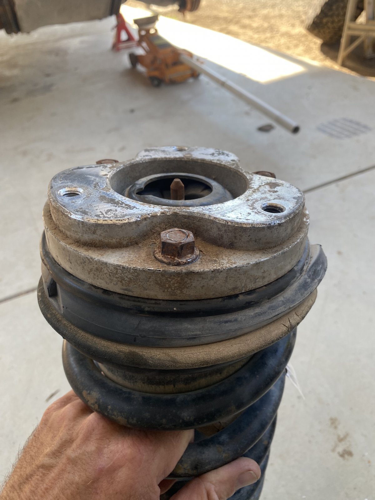

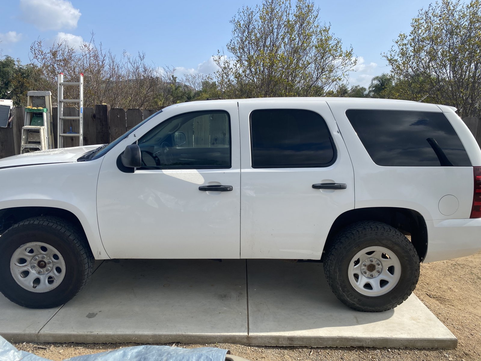

I also have a 2011 CBP Border Patrol Vehicle and it came with GM shocks. The front struts had a 2" shim on them for a 2" front lift I presume. My underside is also "Armored" up with CBP manufactured rock guards plus two hood vents. I too have a 2" hole in the roof were the lightbar was. I purchased a plastic stick on cover temporarily but I plan on having a body shop repair it soon.
This is the company I used to get an aftermarket center console and the Hole Patch Plug ( https://nenno-products.com/products)

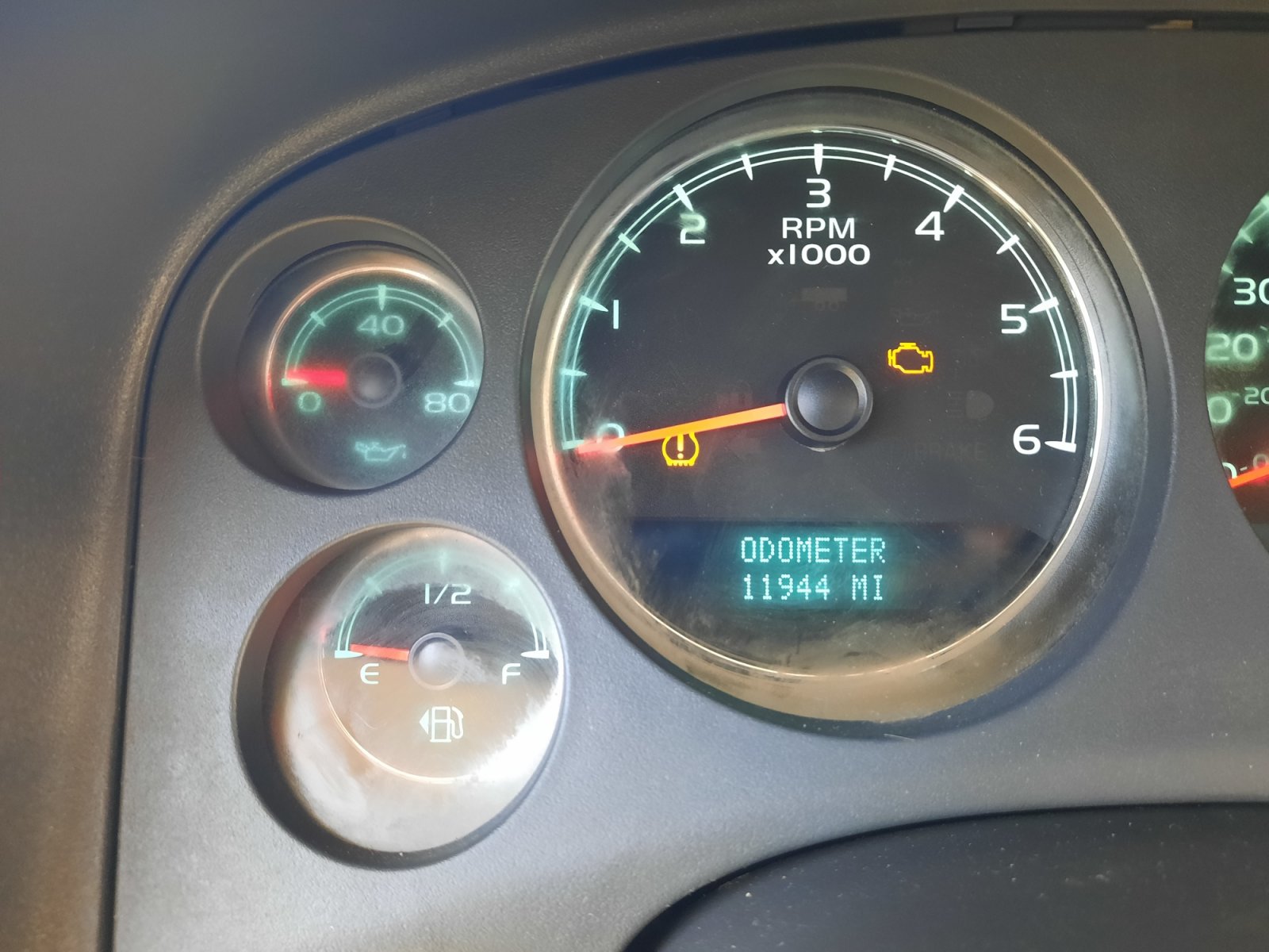

Thanks for the welcome! Here's some shots of it. No skid plates so now I am wondering what agency had it? In one of the pics of the CV, you can see almost out of frame, the 5100; I'm hoping it has a shim or the 5100 is set higher.

don't mean to be a downer, but the cluster was probably replaced and the truck itself probably has more than 12k miles.
If you don't see a spacer above or below front strut, then the bilsteins are up a notch or two..
And the fact that you can read the DIC it looks like it was replaced or fixed. I think the millage / Eng hours information is maintained in the ECM right?

From the looks of your dash, the TPS sensors are either not programmed or non-existent in your wheels. Any shop should be able to program or get yourself a tool from AMZ. I got mine specifically because I do winter tire swaps on my wife's Equinox.

all the hours, miles, gallons, trip, etc are stored in the cluster, the only way to get a idea of actual mileage is carfax or call any gm dealer service department and provide the vin, they can tell you what work was done to it at what mileage if it was taken to a gm dealer.

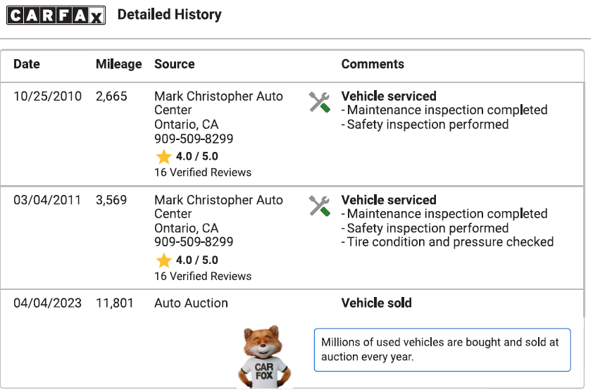

I pulled a Carfax on it before I bought it. It showed 11800 but only at the time of when it was auctioned. There were only 2 other entries in there from 2010/2011 for a service check at some shop. The mileage at those 2 points were around 2600 and 3500 miles. I tried to hook my Autel to it to see if I could pull up the mileage, but it seems that maybe the Autel I have is not compatible? It will read the VIN, but that's about it.

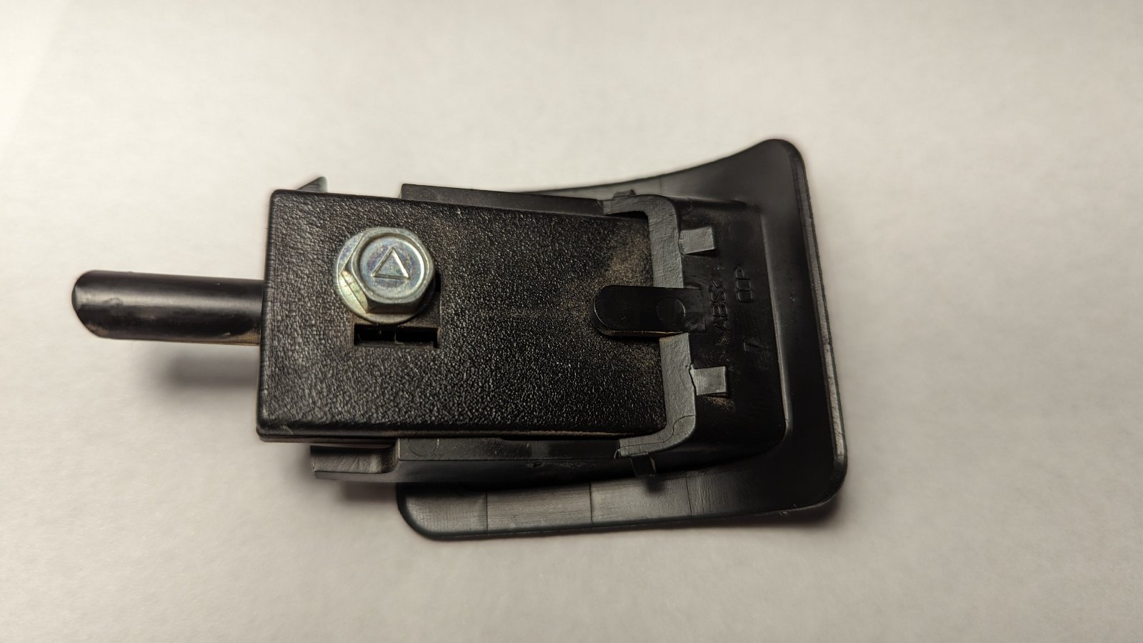

One of the few things I am working on is trying to get those rear doors unlocked :mad:. I can't open the doors from the inside or outside. I managed to pull the lock knobs out and found this:
But removing that bolt, I don't think will fix the door issue. I wouldn't want to but I feel like I might have to "gorilla" the door panel off to get to the linkage. Any thoughts?

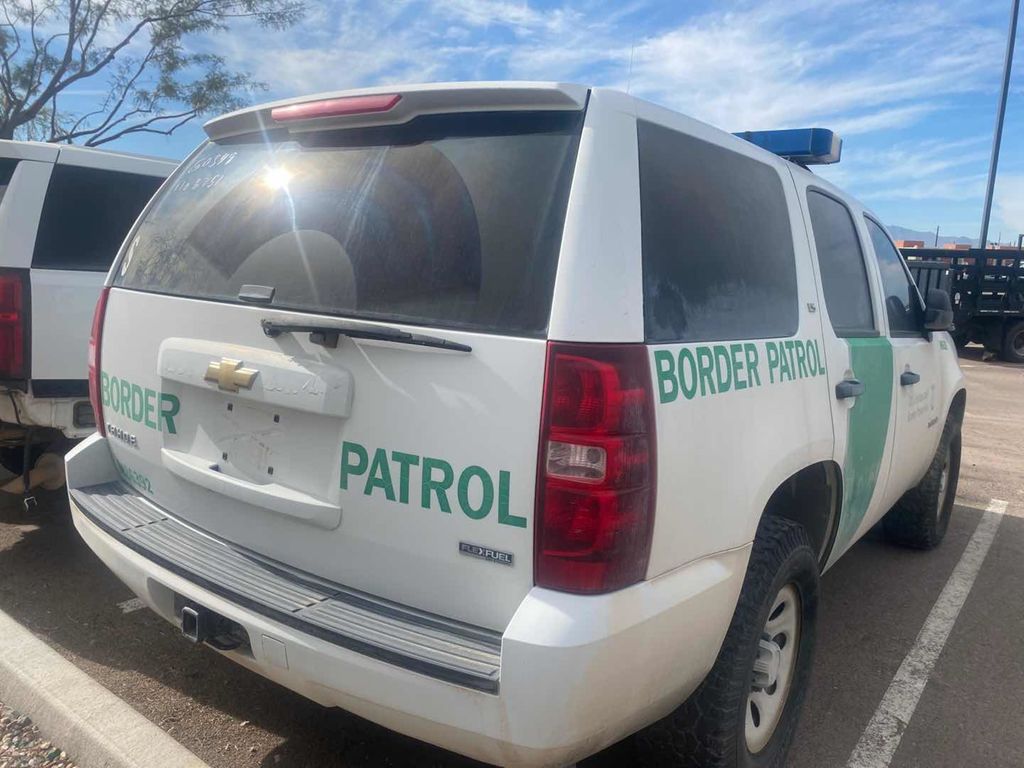

I also managed to find a "before auction" pic of my Tahoe in its former glory:

Wow, well either the cluster was changed around 2010 or you really do only have 12k miles!
The other reason I thought your cluster may have been swapped is the gap at the top of your cluster, looks like the trim might not be snapped in all the way or something.

check where the front doors latch for a choke cable pull knob.. thats what mine had to lock both rear doors..
