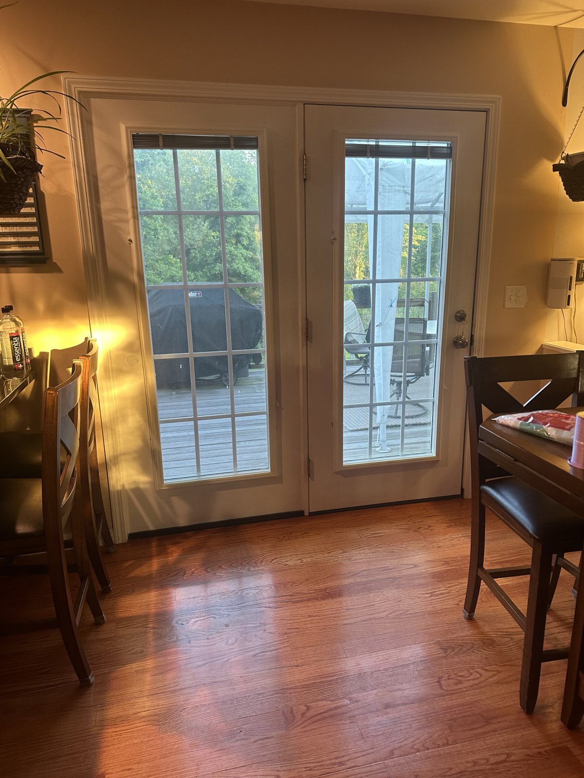

How big is the door? My 6 ft door slider with fixed glass has like a 26” or 27” opening, iirc. Not really noticeable until you try to bring something through it though.

Hows the bugs in your area? Does 4 panel have some sort of screen? If so, 4 panel,
if i had to it again definitely 4. Actually pulling the fake french door i have now out and putting in a slider… i hate this door fixed panel in swing takes up so much room…
