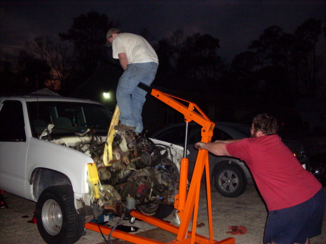

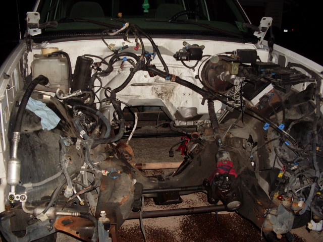

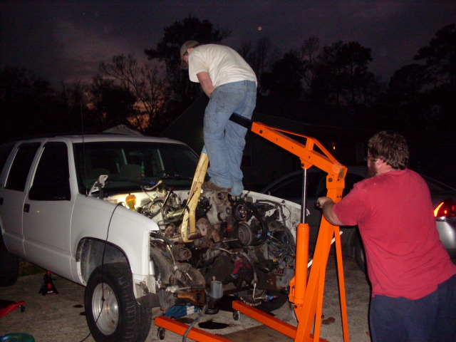

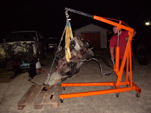

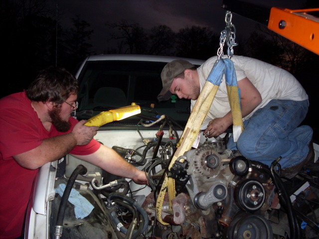

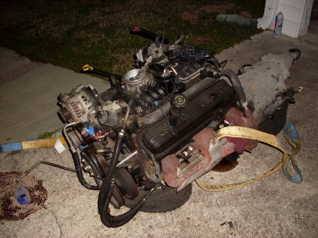

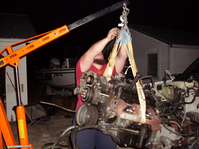

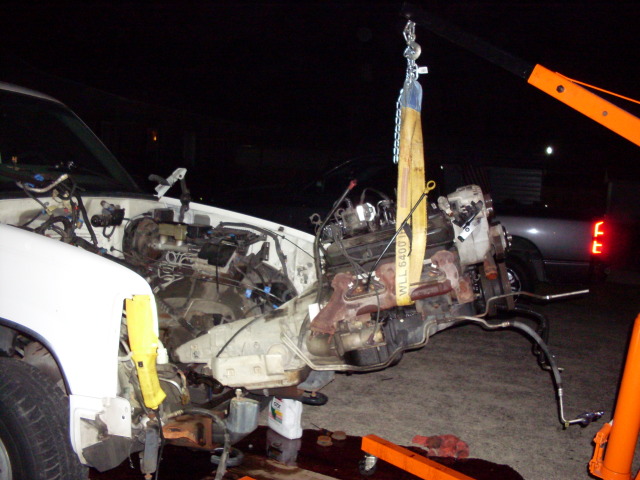

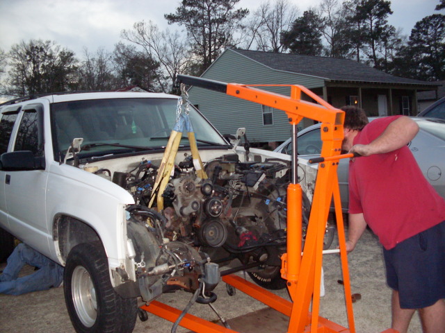

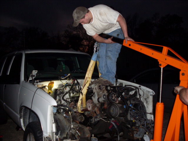

got the motor and tranny out last night, pics to follow. good times. wasn't too bad, just made a little mess here and there with the fluids, been cleaning up the floor-dri from last night and scrubbing the driveway down with some superclean this morning. piddling with my motor mounts right now, need to tarp my old motor in case it rains. even though i don't have much use for my old 350 now, there's still a lot of good parts on it for when i either sell it or part it out. stay tuned

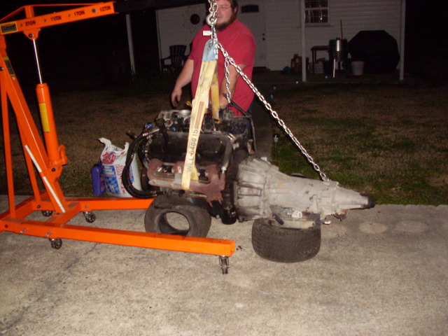

action shots of said lift riding
pretty much as it sits right now. gonna start figuring out the wiring and hopefully have something worth reading once it's all done. thanks for all the followers, feel free to ask any questions that i may or may not be able to answer.

Pulling the 350 and 4l60E was very smooth, but then again Branndon made it easy on us and pulled the entire front clip aside from fenders. So it was basically pick up, pull forward, and you're done. No worries about those Spintech's man, they will still scream. I'd expect yours to not be quite as deep down low and little bit more raspy up top though. If I get that industril pipeline water temp housing hooked up today I'll swing by and we can take a little ride.
