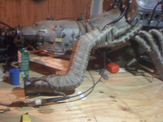

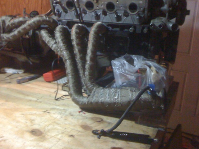

nice. i can only hope mine sounds as good as some of the goats i've heard on youtube with spintechs. sorry it's been a few days gents, been working and the rain hasn't been cooperating, sooo... it's been slow on my end. have a couple pics from my phone, so excuse the quality. the poorly dressed people i have pics of are from my last trip to harbor freight. saw them both at the same store at the same time. though that was illegal to have so much awesomeness in one place at the same time. interrupt the space time continuum. also a couple crappy shots of my wrapped headers. yeah yeah, i know, rust and corrosion and fail, i know. but it's cheaper for me to get another set of headers from schoenfeld and repeat the process than it is for me to have gotten them coated. and my local (hour drive away) shop is retooling and stuff so they're not ceramic coating for like 4 months yet. i just have a hard time spending twice what i paid for the damn things in coating. so we'll see how long they last. maybe by the time it comes to replace them they'll have a "nicer" set of headers available for the swap in stainless or something, or maybe i'll just have schoenfeld coat them there for another 200 bucks. so all you naysayers, save your breath, i've weighed the options on both sides of coating/wrapping/uncoated/etc., and wrapping was the one i decided to go with. not trying to be a douche about it, but i've heard all the possible cons about the wrap, so i'm just gonna roll the dice on it. anyhow, specs are DEI titanium exhaust wrap,
http://www.designengineering.com/ca...wrap-kits/titanium-exhaust-wrap-lr-technology
and it took all but like 2 or 3 feet of 2@2"x50' rolls. takes a damn lot. for attaching and securing the wrap i got some stainless steel safety wire and some safety wire pliers. lot cheaper than stainless tie wraps or stainless hose clamps, and think it makes for a cleaner install, plus you can add as much as you feel necessary without it being too too obvious. again, sorry for the crappy pics, old school iphone 3g doesn't take the best pics, especially in low light, but i'll have some better pics soon as soon as i get some days off.

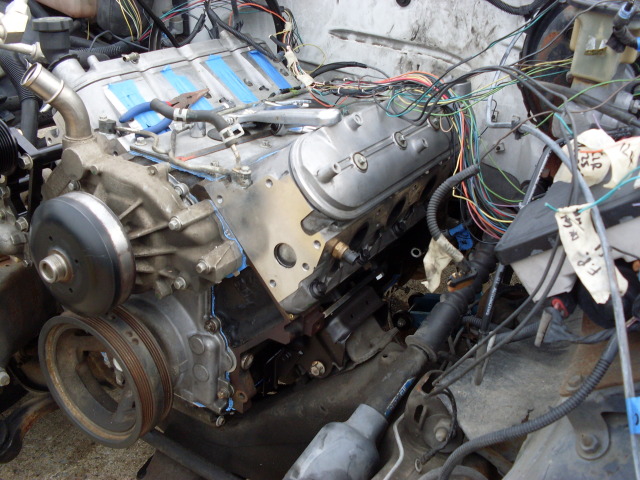

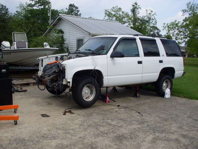

sorry for the long wait. here's some pics.
new motor stuffed in the engine bay. went in surprisingly easily. almost like something was wrong. lol
various pics of motor in the hole.
various wires i'll have to find homes for.
poor truck. hope to have you down shortly.
