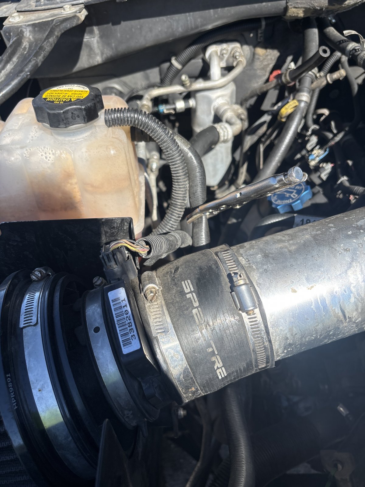

The vice grips make it run 190F on the freeway and 200F in town
You can use a worm gear hose clamp.
Or, more than one. Now you can regulate flow through that hose.
In winter, go ahead and squeeze it tight - NOT shut.
In the summer, or whenever you tow / haul heavy, or play hard, open it up all the way.
By the way, forgot to say that you may need to burp air out of the system, but I doubt it since you're running cold.

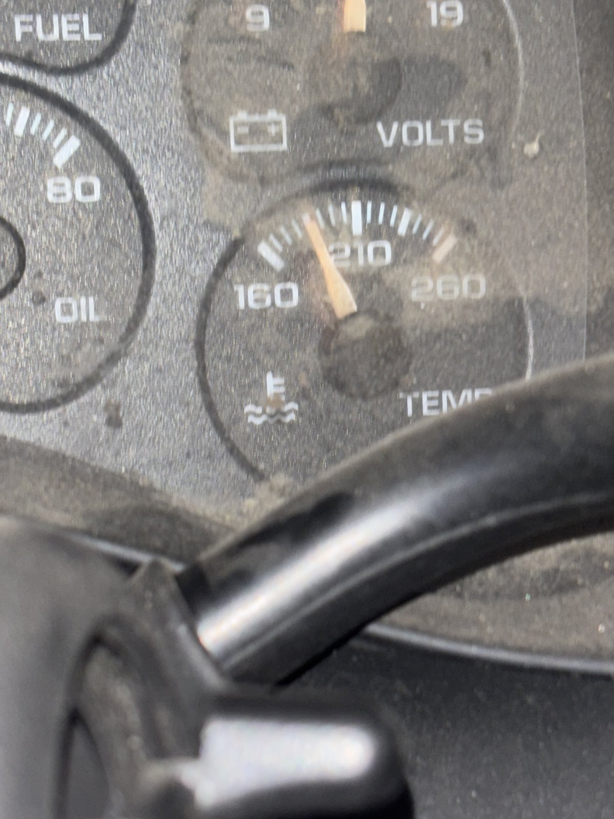

Now that winter time has come I’m needing to defrost the windows in the morning. and the truck barely wants to warm up at all with the radiator upgrade I changed the thermostat for a 187* factory spec and it’s barely warm at all. I’m thinking I need electric fans to keep the truck at temp at idle if I sit a really long time without the heater on it starts climbing to the desired temperature but it’s only 55* outside when picture was taken and I took it on atleast 10 minutes of highway is this just how it is with the aftermarket radiator? It’s making me late for work when I would normally have plenty of time I’ll update tomorrow if it warms up in time it’s gonna be high 30’s at 6 am tomorrow and it’s struggling now.

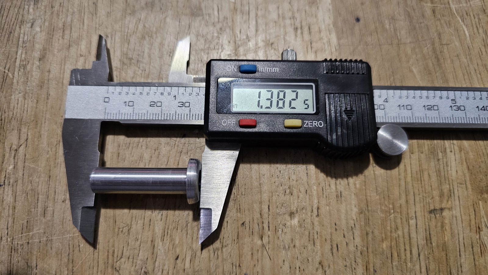

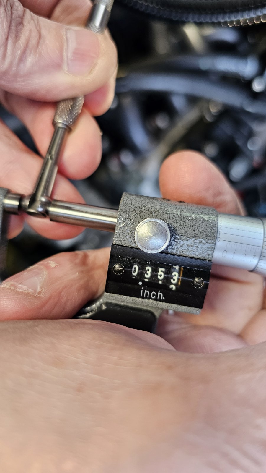

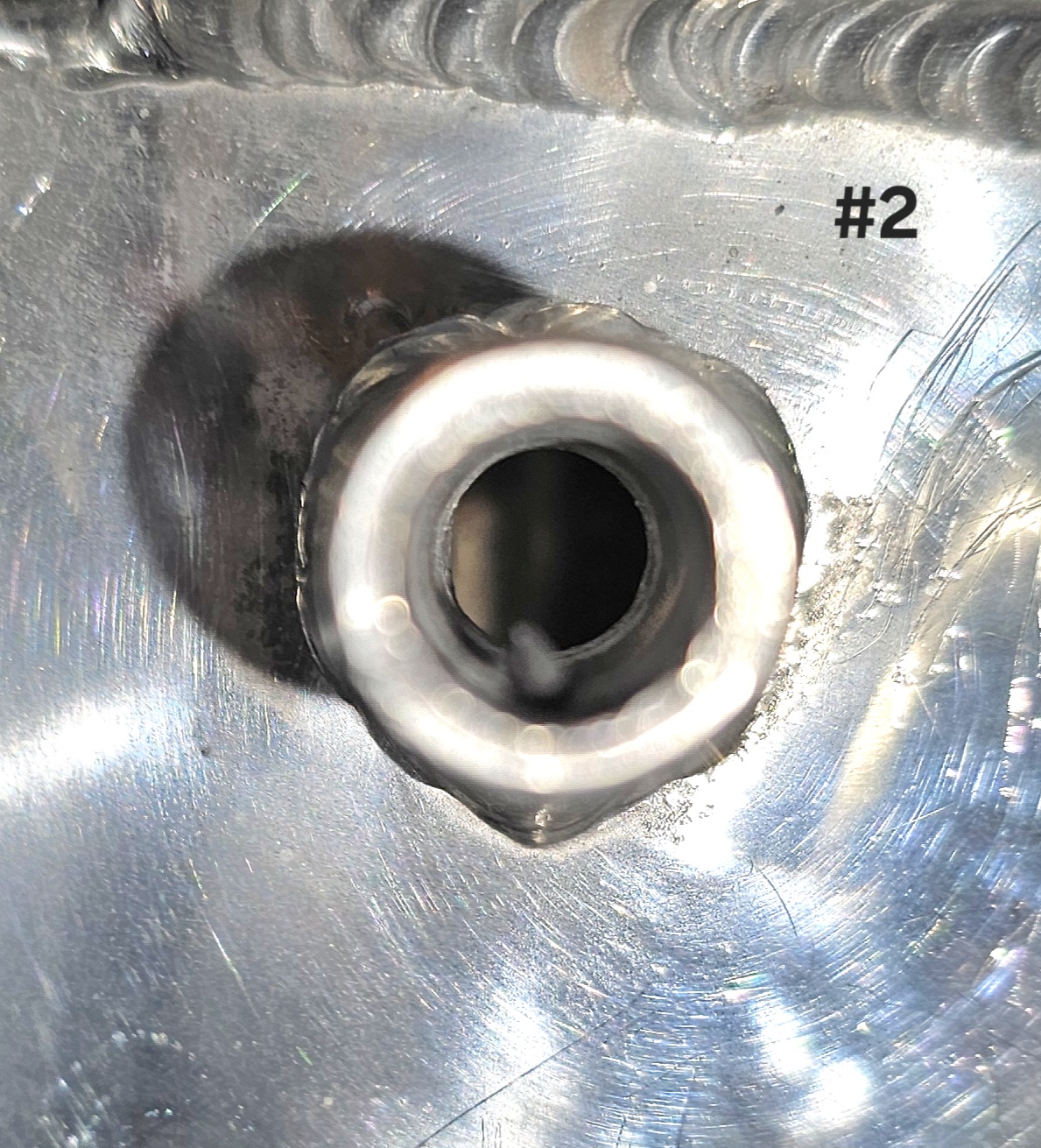

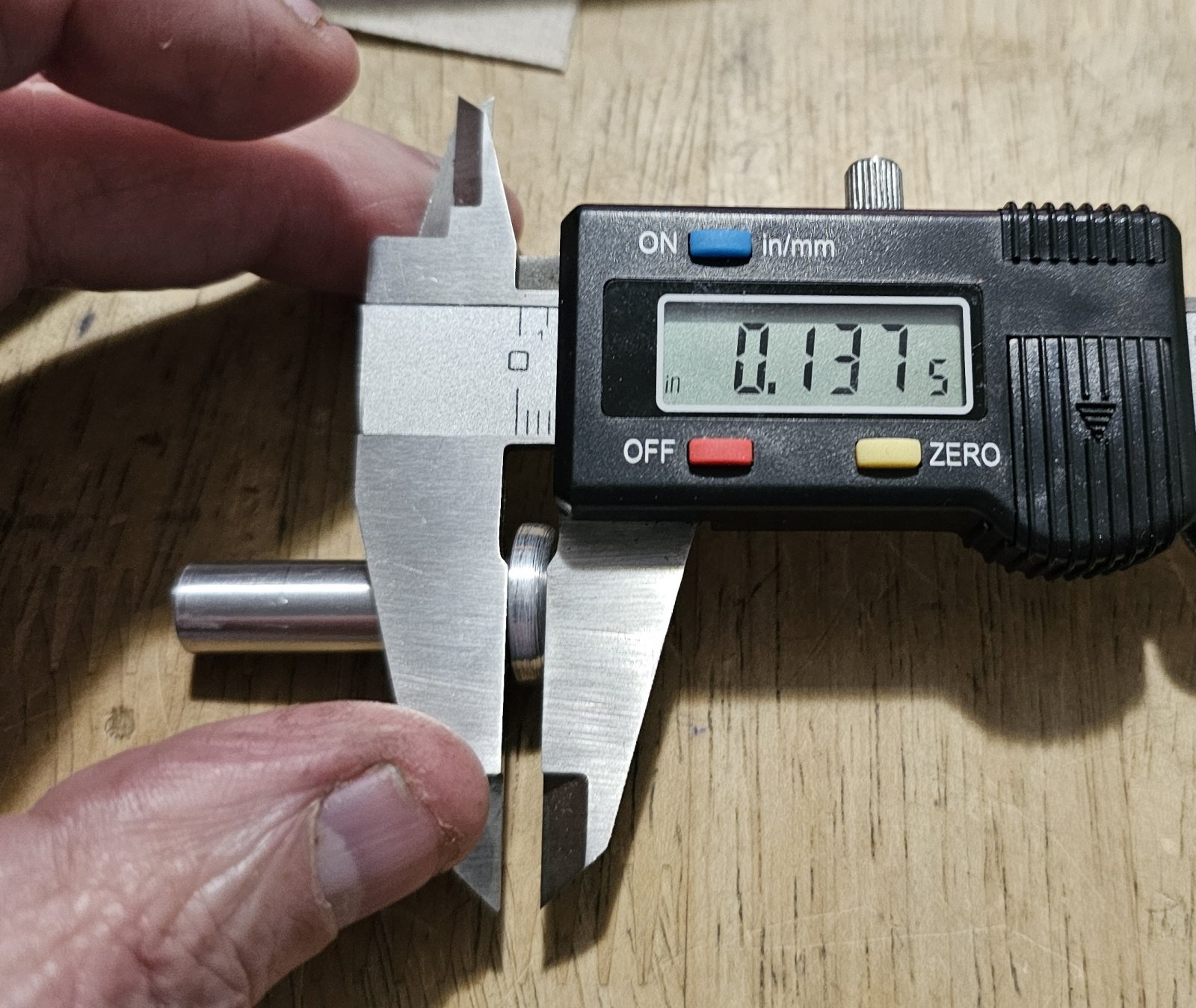

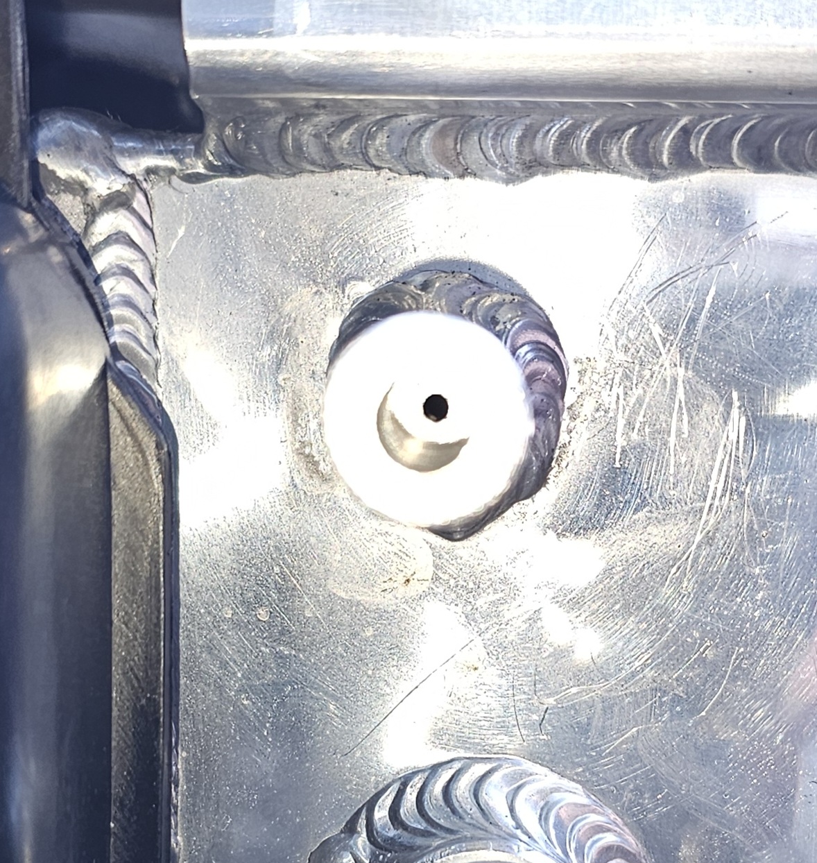

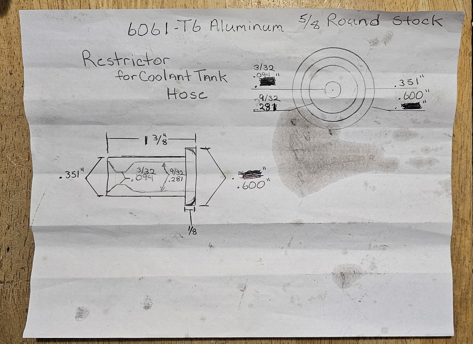

There is a technical service bulletin out that explains what happens. If you look at the old factory radiator the smaller hose where it goes from the radiator to the coolant reservoir. The nipple on the radiator that the hose attaches to is restricted. When I put in my aftermarket 3 core aluminum radiator that nipple did not have a restrictor I actually made one out of a piece of aluminum bar stock. I have attached some photos below of the restrictor that I made. So far I haven't had any problems with it

When I put in my aftermarket 3 core aluminum radiator that nipple did not have a restrictor,
So far I haven't had any problems with it.

That small hose is the steam vent, it's not causing your issue
Your blend door could be failing to move completely to the heat position, your heater core could be restricted or your thermostat could be stuck open
I doubt it's your thermostat because even 140 degree water will blow pretty warm air if the heater core is flowing well & the blend door is all the way to the heat position
Remove the blend door actuator and see if the door moves freely, if it does observe the actuator as adjust from cool to heat & see if it's rotating freely; my guess is that actuator has failed
Moderator
16,623
34,409
People's Republic of Colorado
The small hose between the radiator and the surge tank is not a steam vent. If the radiator orifice is too large the coolant temp will not rise to the desired temp. Hence the necessary restriction, whether that's inline or integrated into the radiator port.

These cooling systems will warm up fine if everything is in operating condition. However, it's been well documented over and over here if that restriction in the surge tank line is too large, the engine temps will not come up all the way, which may be happening here.
Before condemning any particular part or taking action to change ECM settings, I think we need a little more specific info:
1. When the engine is fully warmed up (as much as it will) what is the engine coolant temp (ECT) sender reporting with a scan tool?
2. Does pinching off the surge tank hose have any effect on the engine temp?
3. Has an infrared temp gun been used to determine if the ECT sender is close to accurate?
