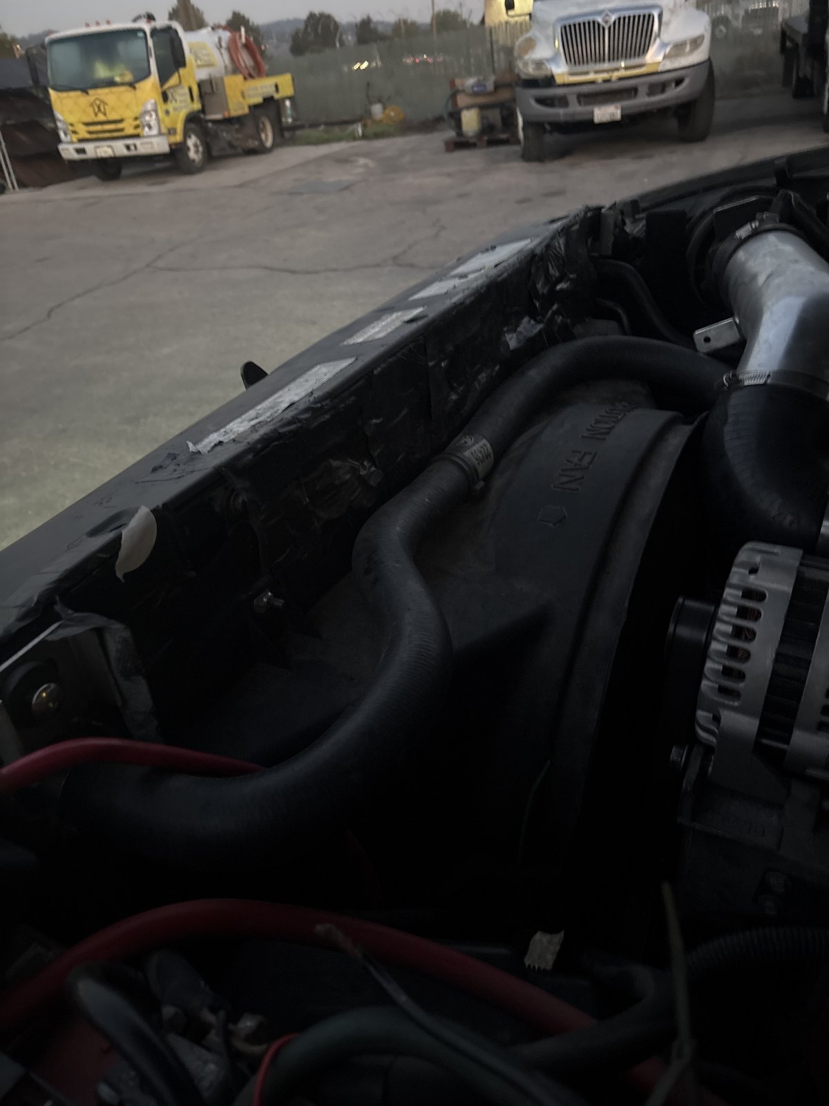

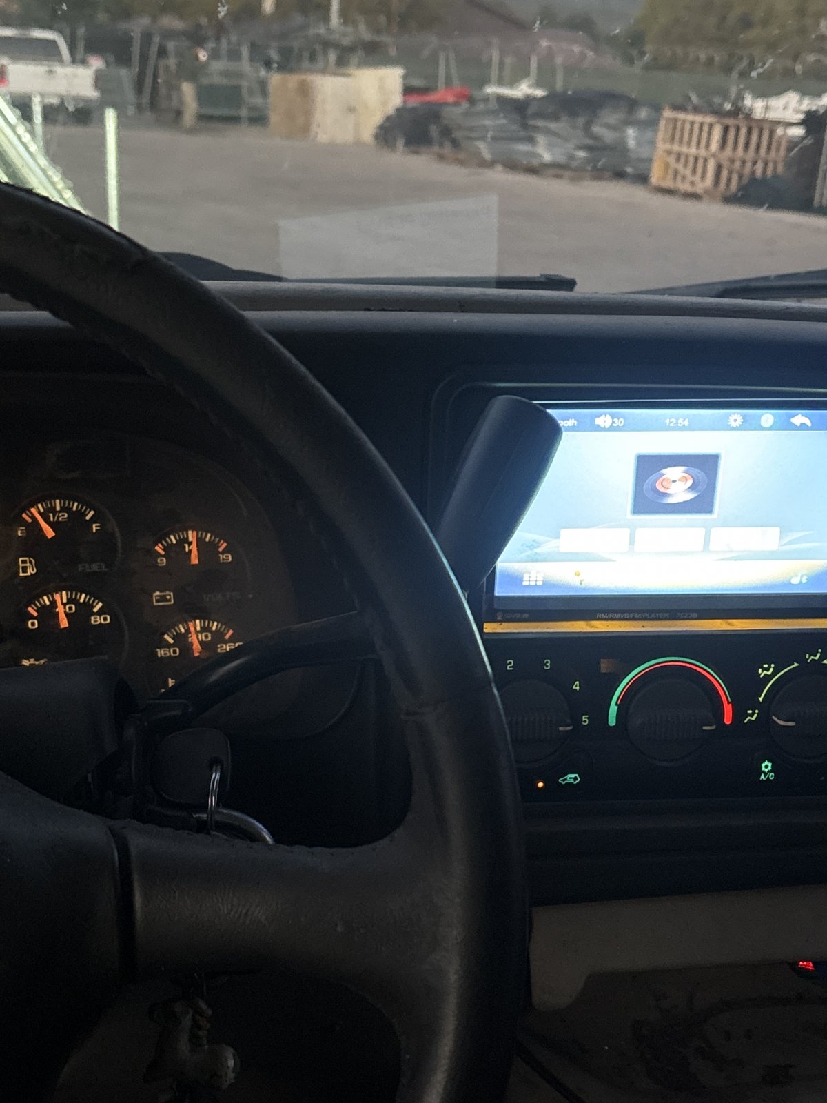

Now that winter time has come I’m needing to defrost the windows in the morning. and the truck barely wants to warm up at all with the radiator upgrade I changed the thermostat for a 187* factory spec and it’s barely warm at all. I’m thinking I need electric fans to keep the truck at temp at idle if I sit a really long time without the heater on it starts climbing to the desired temperature but it’s only 55* outside when picture was taken and I took it on atleast 10 minutes of highway is this just how it is with the aftermarket radiator? It’s making me late for work when I would normally have plenty of time I’ll update tomorrow if it warms up in time it’s gonna be high 30’s at 6 am tomorrow and it’s struggling now.

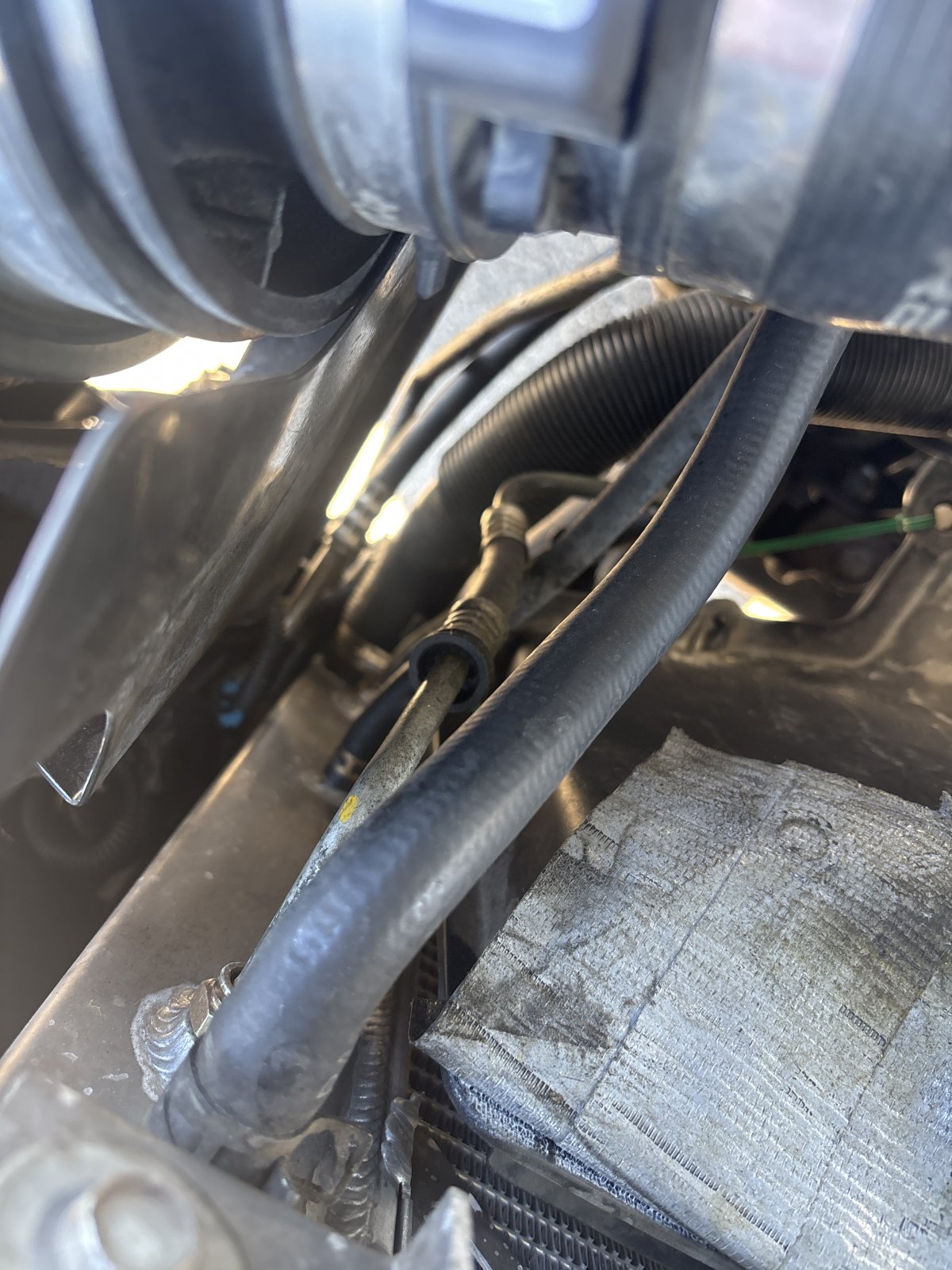

Which one of the 3?

Which one of the 3?
The lil finger-sized rubber hose you're staring at in the foreground of the pic with the squeeze clamp.
PARTIALLY pinch it, preferably in a way that can be easily undone. (Ziptie? Bet someone else will come up with a better way.)
As @Joseph Garcia stated, someone manged to wedge a spent shell casing into the tube that connects to that hose which fixed the issue.
I imagine there must be some way to adjust/control the flow through that hose ...
I mean it’s getting up to temp still but really slow even 80* out
LordWayback
LordWayback
Jun 23, 2022
573
456
The vice grips make it run 190 on the freeway and 200~ in town
@Tozan did the .45 shell casing, shown here:
