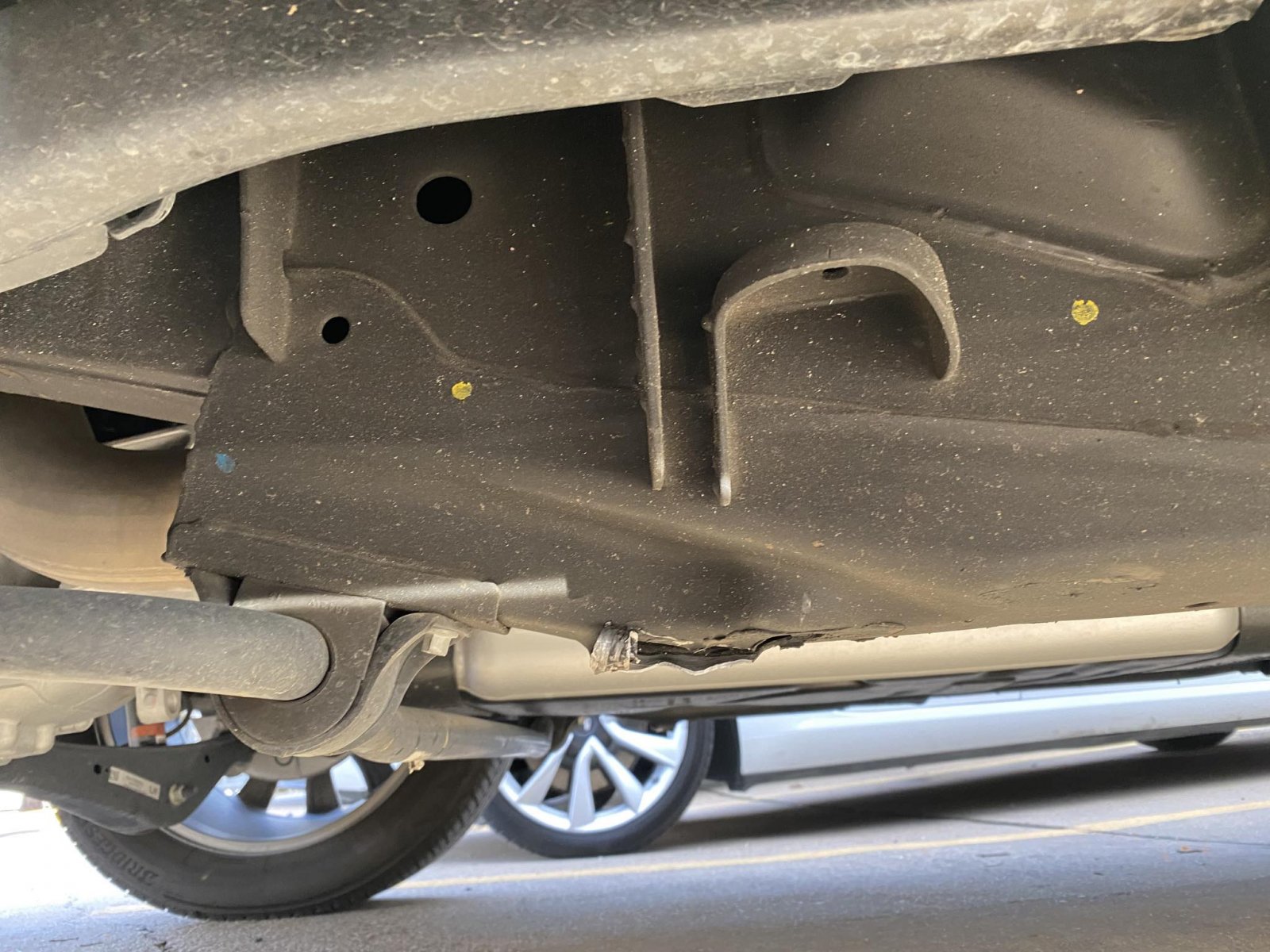

The saga continues…
I had the car towed in on the 26th and confirmed the issue was a collapse lifter on number 4. Fairly straight forward process at the dealership and it was returned today with all 16 lifters replaced.
The problem is that the tow truck GM roadside sent ripped the fame. The tow driver winched the truck on the flatbed, hooked up rear hooks and then re-tightened the winch, resulting in both sides of the frame ripping. One body shop said the entire frame needs to be replaced with another saying a patch would do as they were not concerned about structural integrity. Couple this with GM roadside not actually being run by GM so the dealership is throwing up their hands saying not their problem and to take it up with the roadside carrier. It should be a fun new year getting this sorted out!
They said, any current or former bodyshop workers that has any idea of what the proper repair is?

You called dealer about problem and dealer sent the flatbed to pick up for them to repair. This is their problem and looks to me it's time for a buy back from GM that is not acceptable. Dealer picked company to retrieve vehicle you don't have anything involved in pickup service this is there fight you need them to buy back vehicle that's crazy makes me sick can't imagine how you feel.

Take a deep breath and relax. This would go on the tow truck company's insurance. Not everything is the dealer's fault. Lmao.

Sorry about the bad luck. The tow truck company is responsible. Their insurance should handle it. A frame swap would be ideal as a patch would negatively affect resale value. I don't think structural damage was done but regardless needs to be made to how it was not what they can do.
Just tell them it was oem new when they took it and thats what you expect. No different then if you got in an accident.
Good luck. Sorry about the bad luck.

Exactly dealer will have to deal with tow truck company they pay the bill not OP.
