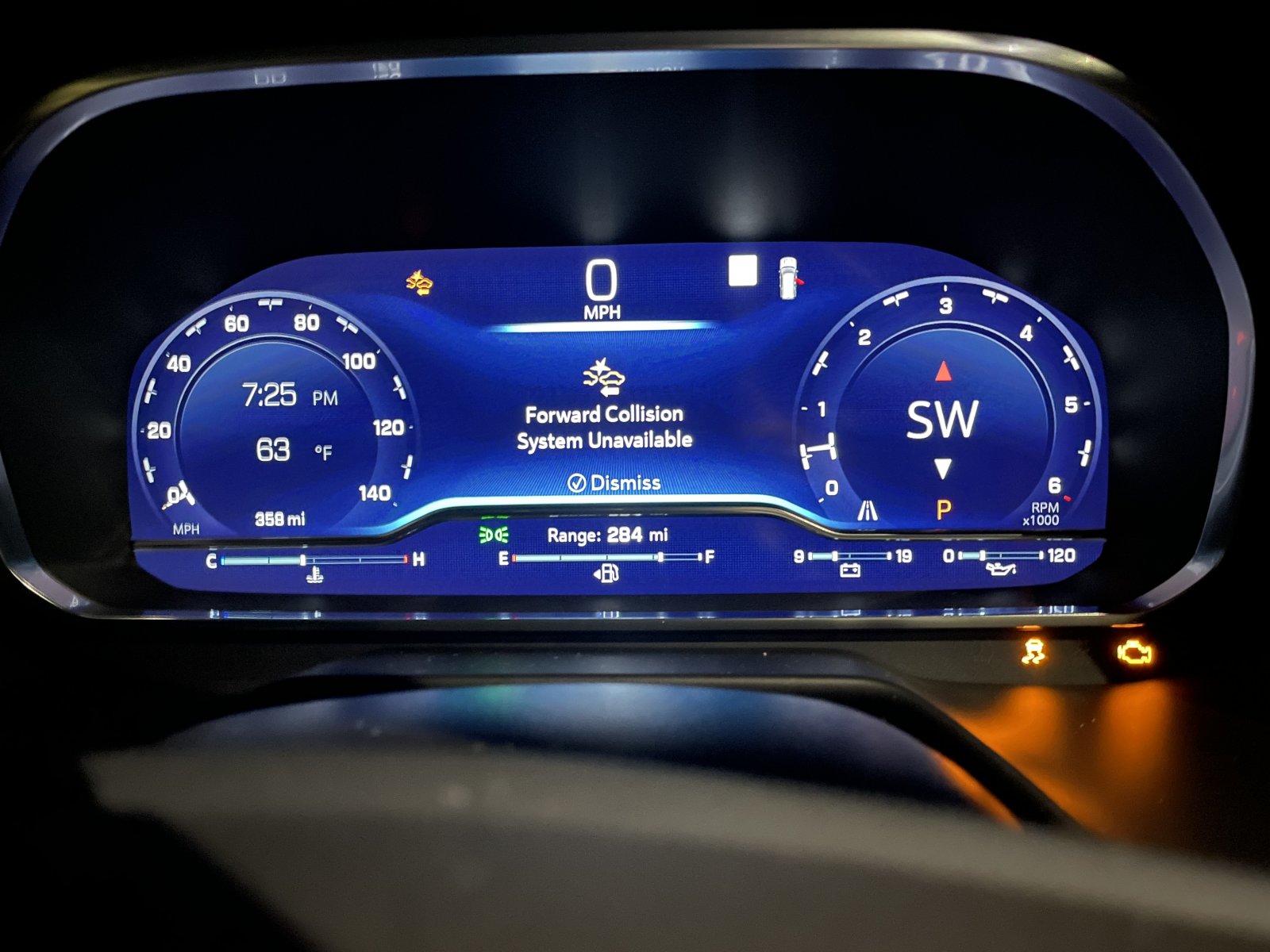

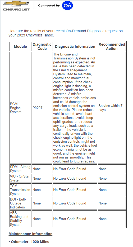

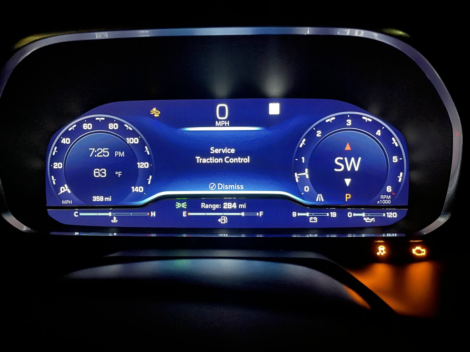

First time Tahoe owner (GM for that matter) and recently purchased a 2023 Tahoe LT brand new (first new car purchase). At about 300 miles I randomly got multiple errors and flashing check engine light with engine running rough(photos and error codes from OnStar diagnostic). Traction control error, forward collision disabled, service ESC, etc. I was almost certain it was the dreaded lifter issue but couldn't believe so early at 300 miles. I was able to make it back home and OnStar required I get it towed into the dealership. After sitting in the lot for a few days, the dealership reset the check engine light and everything was fine. Service attributed as a software anomaly. Brought it back home and fast forward 700 miles and the issue occurred with the exact same thing. 3 days before we are supposed to take it on the first long road trip for the holiday.
Anybody experienced this issue? Have a suggestion on what to do? Wondering what my options are because I'm getting to the point of demanding to trade it in and see what the dealer can do for me because two events where the truck is inoperable and had to be towed in less than 1000 miles for $65k+ is unacceptable. Appreciate the advice. Merry Christmas!

You need to find a different dealer. So many here try and blame the vehicle when in reality it's your crappy service department. This isn't practicing medicine, this is diagnosing problems correctly the first time. I used to be a GM transmission tech/heavy line and we had to fix things correctly the first time.
Resetting a battery is not fixing a problem. Resetting codes is not fixing a problem. Calling it an anomaly is not a fix.
Flashing check engine light is a misfire. I'm betting you have a fuel or fuel delivery problems. The rest of the lights sometimes go along with the check engine light. Id concentrate on the code first.
P0207 from my experience on the older stuff is usually an injector issue. Either with the actual affected injector 7, or wiring to it.
I have no idea why they would just reset it and send you home. When it could vary well be intermittent as most of these faults generally are.
Please, just go somewhere competent. You will have a much better experience.

I would look for another authorized service shop. Someone with a brand new vehicle having their truck sit in the lot for a few days before they got around to checking what was wrong?! Doesn't seem right. They should have put someone on this right away (if not the next morning)! Clearing the code and saying it was a software glitch explains the problem away, too.
Mine is almost 20 years older than yours, so I am not up on what software can do to these things. I am aware, that the computers do almost everything now days.
But questions I would be asking:
The P0207 was a code specific to cylinder #7. If the software or computer says the readings were out of programmed parameters, then what could be triggering that condition?
The fact that you also saw traction control and front collision messages does point to possible computer or ECM problem, but I am wondering if there is any possibility there is a damaged or loose connector on the ECM or one of the main harnesses?
Maybe workers in the factory weren't all that careful during assembly and something got nicked or damaged in the process, leading to an intermittent problem.
Good luck! I hope they can get your problem resolved.

Traction and collision can turn on when other codes are present. Doesn't mean the ecm is faulty. Sheesh. Its is incredibly rare for a ecm to fail these days. You would have tons of body codes present and communication codes.
From the code he presented seems pretty easy to figure out. It's misfiring and has a injector 7 code. It's not rocket science.

That code is a injector 7 circuit performance code. Either the injector is failing (likely) or the wiring to it/connector. If it's one of the v8s it is very simple and straightforward.
Stuff happens. I wouldn't put your 2 cents into it. Let them do their jobs or better yet go to another dealer. Don't try and influence the outcome they 'should' be professionals. If we had too many comebacks we could get terminated. Same with bad CSI score. Im sure the same still holds true.

If it’s injector 7, it could be as simple as the plug not seated well on it, could be a failing injector; still super easy fix, or could be a bad wire/wiring harness; also an easy fix.
Agree w/ what was said here: get it to a reputable service shop; let them do their thing; move on.
Remember, it’s a machine, made by man, it can fail. That said; if it is fixed and they can explain the fix; recognize that is what your warranty is for.
