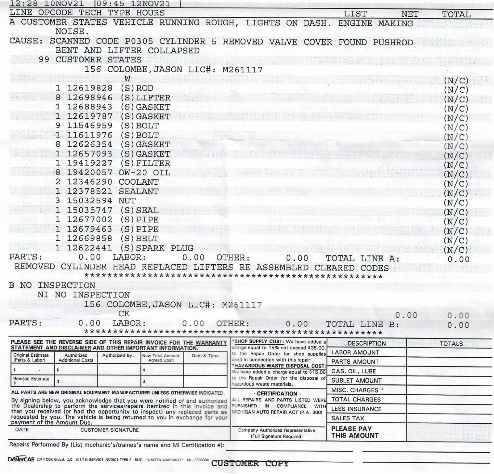

Happened to me on my 6.2L Sierra Denali 3 wks ago at 11.400 miles. Same thing, driving down the road and engine started making noise and warning lights came on. Lucky i was about 1 mile from my dealer so I drove it into their service area. Tech who came to look knew what it was right away when he started it, yep collapsed lifter for sure. In 1 hr they had a scanned code of P0305 and had removed valve cover and found bent push rod/collapsed lifter #5 cyl. He also informed me new rental cars are n/a so they have a 2014 Equinox for me. It was a low miles AWD in very good condition (local trade-in). Anyhow, 1.5 days later I had the truck back. I was shocked they had all parts in stock and tore into right away. Have to give the dealer credit for great customer service.

the lifter debacle continues......
gm just released a notice that lifters are to be replaced on both banks on current vehicles on the lot and those en-route to the dealer before they are sold/delivered.
as of today dec 2 2021
I just checked with a good friend who is parts mngr for Chevy/GMC dealer and he says they got no such notice as of today! He searched everything the got recently and nothing. They have about 10 V8 trucks on the lot and nothing stopping they from selling them. Someone was even picking up their new Trail Boss when I was there 1 hr ago. I trust he would tell me the truth as he has no loyalty to the dealer. Any chance you can provide a copy?

30,775
48,481
looks like they only did one bank, good luck!

Michigan ,USA
Showed him that link and said he look into it next week. But they only have parts to do one vehicle, GM won't send them more parts than that.
