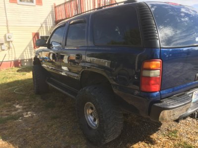

Looking to grab a set of MM 18x10 -24 offset with Toyo RC 33x12.5
Wanted to get an idea what this setup would look like and if I'm going to get any poke, flush or inside the fender.

Well.... crap. I was told by multiple tire shops that that would not work for me. Wish I would have known... they all told me negative offsets were going to be a no-no, they would cause rubbing without a major (6"+) lift.
I've got 20x9 with 285/50r20s, looking to do a modest 2.5-3" level (1" in the back) and trying to figure out what tires I can get for a more aggressive look. Considering some 33", like a Toyo Open Country A/T II in 275/60r20.

Tires shops tell you what their little computer at their desk says will fit and what won't. But they are wrong all the time. 20x12 -44offsets fit with lvl kit on some 285/50/20s and give it a mean stance. Might have alittle rub, might have to trim plastic but it's not hard to do. As long as your just doing normal everyday driving you will be fine, but if your going off-road trail riding then you will prly rub.
20x10 -24offset will fit with 285/50/20,275/55/20 and will be fine for daily driving

My 03 with a 6 inch running 36 15.50s. Monday it will be getting 20x10 with -25 offset and some 35 12.50s

Here's my final setup.
Wheels are Helo 20x9 with +18 offset, Goodyear Duratracs 275/60r20s.
LF 39 1/8"
LR 38 1/4"
RF 38 7/8"
RR 38 7/8"
Thinking of either lowering the front a bit, or putting a 1" or so spacer in the rear. Not sure yet. You really can't tell from eyeballing it that there is a difference, and it drives well, so I'm pretty happy overall.

Ever so slightly rubs the inner wheel well liner. Nothing to worry about and I can prob zip tie it totally out of the way but I just haven't done it yet.
