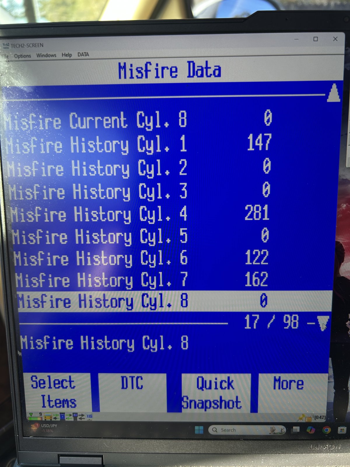

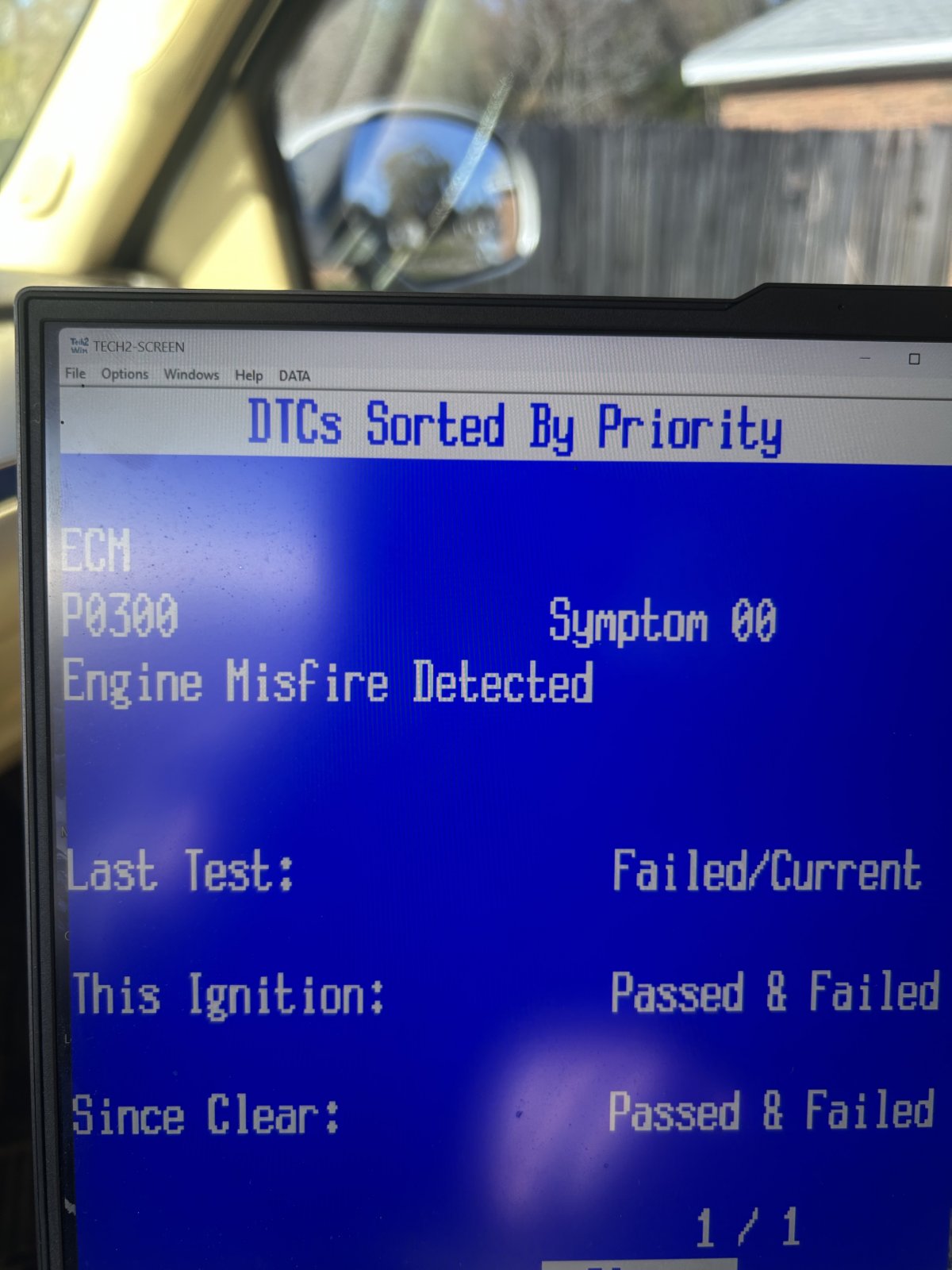

Back with a new to me truck. Just got a 2010 Escalade with the 6.2 awd. 180k miles. Been about 8 years since ive owned a gm and little rusty in the troubleshooting.

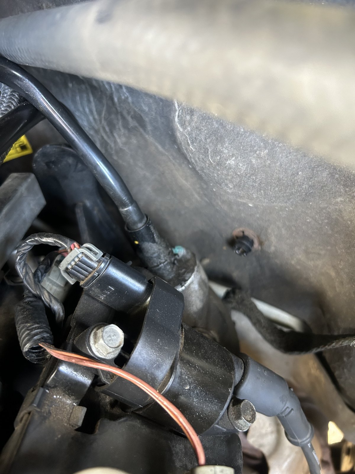

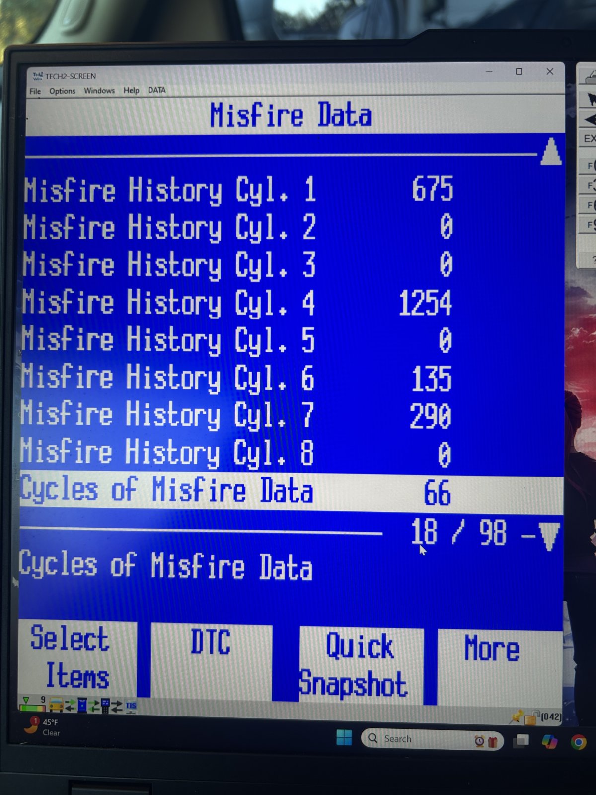

Truck idles decent in park. A little miss, But when in gear at let's say a stop for a min or 2 it starts misfiring bad and the stablitrack lights up and flashing cel. But as soon as I go within a few seconds it clears. Doesn't feel low on power. And the lights clear. Ran the misfire log on my tech 2, cylinder 4 is the worst followed by 7, 1, and 6. I believe those are all dod cylinders. I bought it used and they did plugs, oil and a few other things and it has the dod obd dongle but the dod delete doesn't appear to be done.
I did check the gap on #4 spark plug and it's good and looks new, they are ac delco plugs. Swapped #2 and #4 coil pack and wire and the problem didn't follow. I don't hear a lifter tap at all. I haven't pulled the valve cover to check yet as it's a little sketchy to do it in gear as that's the only time I really get it. The dod delete with a cam and a few other goodies are going to happen in the future but wanted to get a decent baseline. Any suggestions?

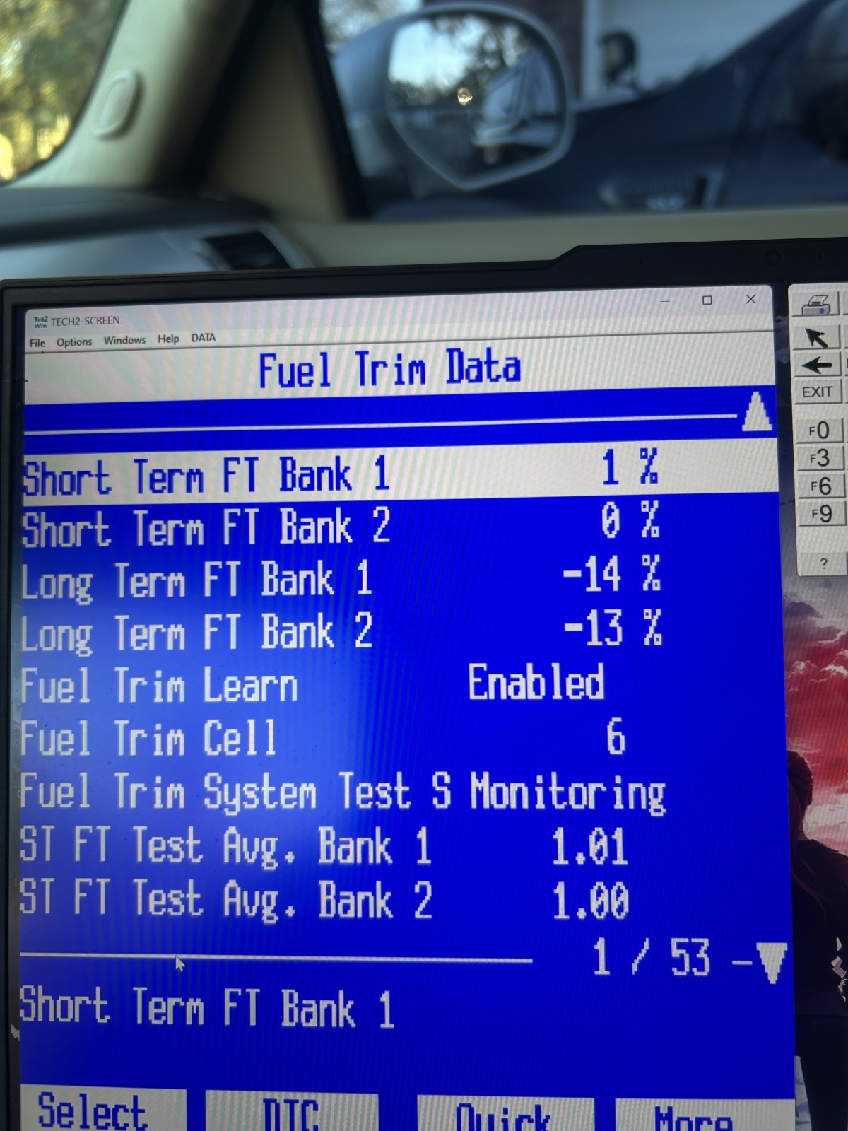

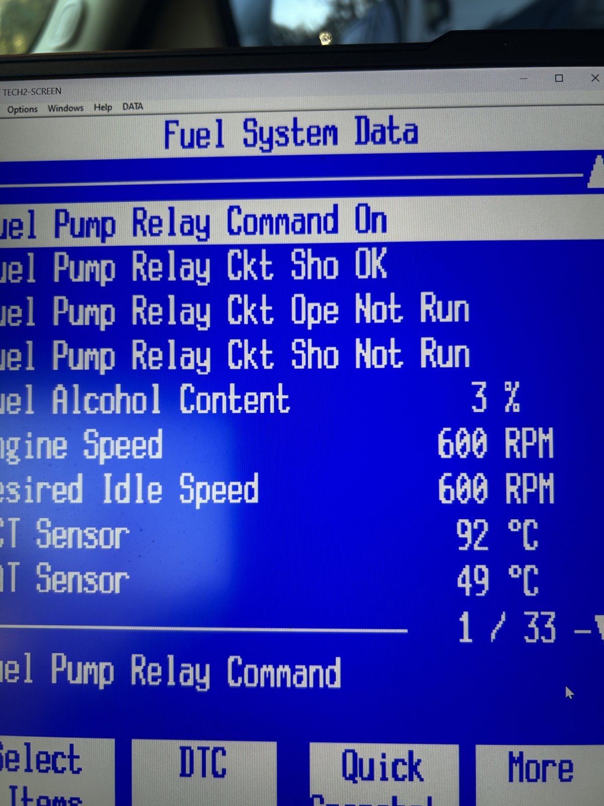

@swathdiver went and put some chevron 93 in it, 27 gallons to be exact. So good gas. Only about a 5 mile run. Checked the alcohol content and it was sitting at 25%. Did a reset and it's reading more like 3% now. Ran decent with actual fuel trims and then it didn't and everything zeroed out.
So she's good now? Tell me about those oxygen sensors. Are they GM OE and have they been changed before?
I learned on these forums that aftermarket sensors don't play nice with the computer system, even Denso not in GM wrapper.
Also learned that factory sensors get lazy after about 100K miles and quit calculating the alcohol content correctly while otherwise working ok to keep trims in check.
If she is good now, check the alcohol content again in 20-50 miles and see if it stays between E0 and E10, trusting that the fuel is good. I got some Shell 93 that calculated to 11% in my tank right now.

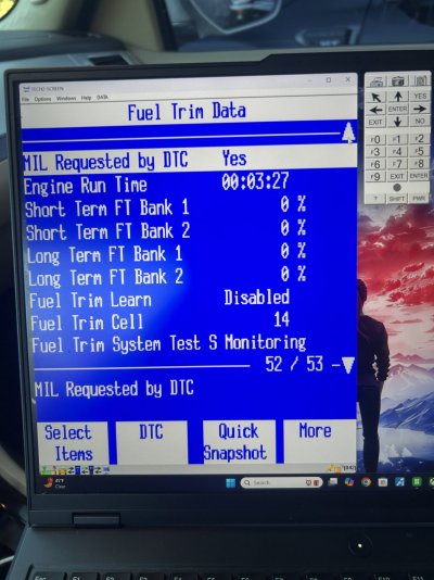

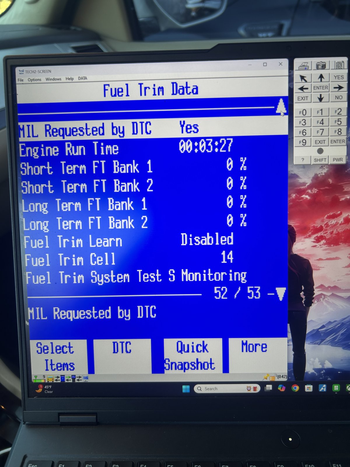

Nope she's not good at all. Misfires are still hitting and feel even worse. It's doing it even in neutral now. When it starts missing really hard the fuel trims all go to zero. Cylinder 4 is still the worst. I haven't looked at the O2 sensors yet but they seem to be reading around .700-.800.
21,278
30,213
So the high alcohol content, even though wrong, was adding fuel. Trims at 0% is good. The upstream sensors ought to be moving up and down through their full range, those are the B1S1 and B2S1 sensors. The downstream sensors ought to remain pretty steady. If they are moving like the upstream sensors, you have a bad cat on that side. Don't think that's your issue.

if the trims lock to zero when it starts missing badly. it might be dropping out of closed loop.
I figured that out shortly after posting. So right now I only get 2mins to look at stuff before it zeros out.
@swathdiver so next steps I was going to do was pull the injectors, do a bench test of #4. Then put it in the #2 hole and vise versa. Also make sure all the connectors are correct and plugged in. If that doesn't seem to rectify it or if it doesn't follow, I'll pull the pass side valve cover and see if the lifters are working as they are supposed to.

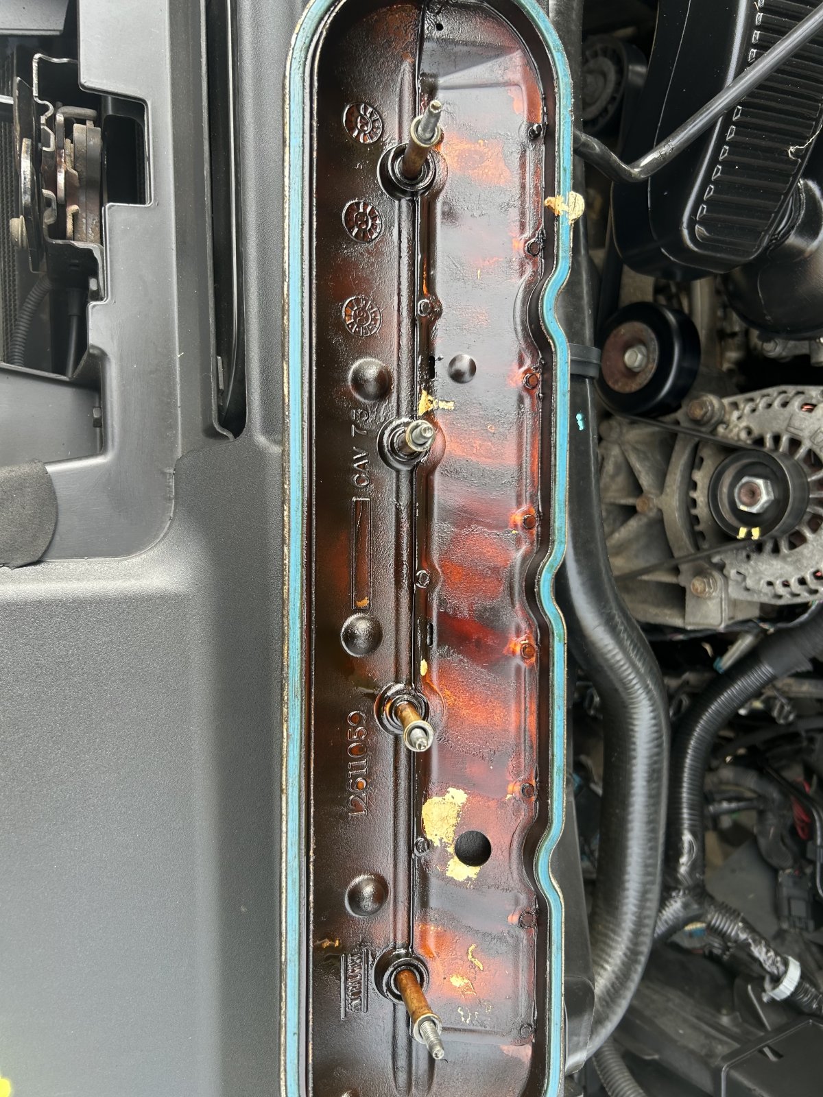

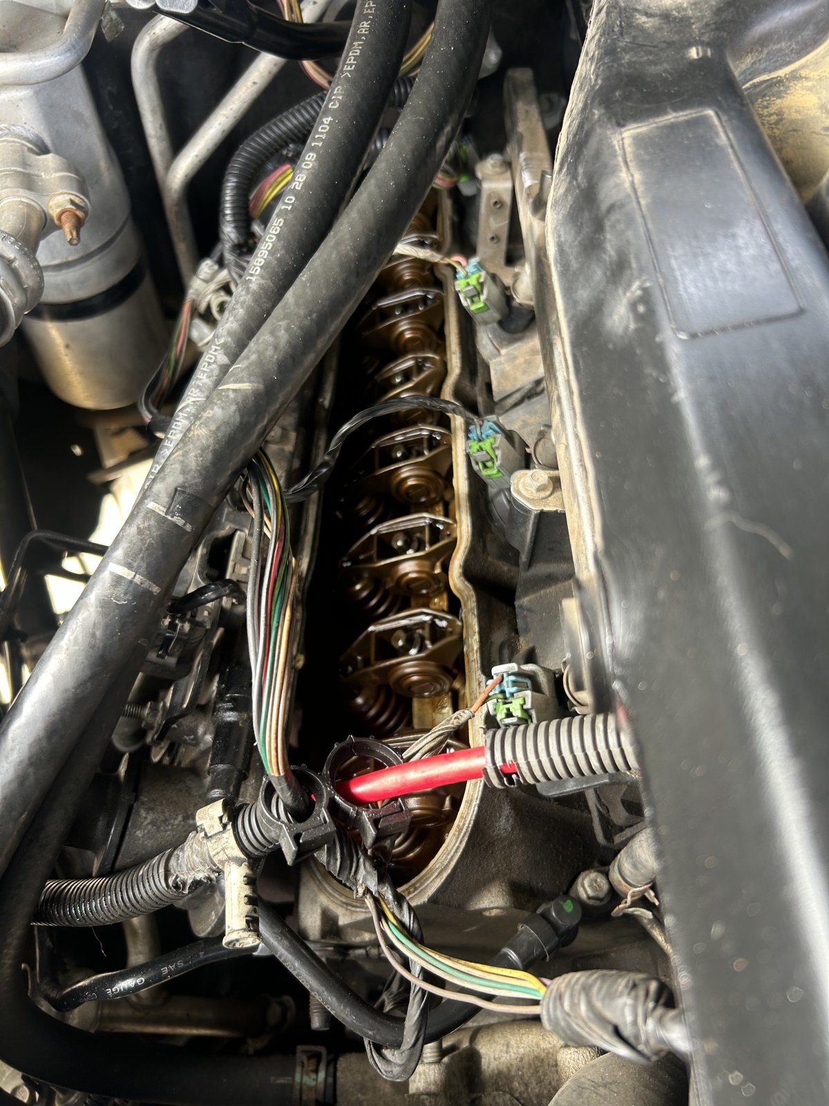

So did some more troubleshooting I guess you would say. Ran a compression test, probably should have started there. All the afm cylinders were low like 125-140 low while the other 4 were about 180-185. Pulled the valve covers and rocker arms were not sloppy and moved as they should while running. Plus side I have the pre tsb driver valve cover and will address that once the engine comes apart.
I'm thinking the afm switch or sensor what ever it is that controls that system, is failing or the valves have some serious build up. None the less ran some seafoam in the vacuum line and now letting it sit for a bit. Doubt that will clear anything up but you never know.
