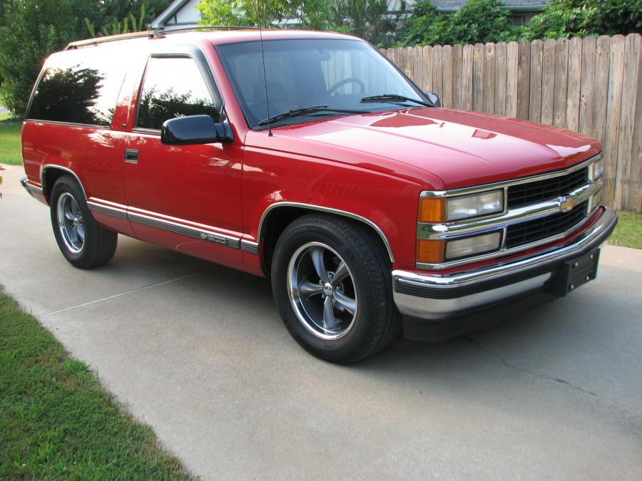

Please help Identify this Lowering Kit
navi243
Jun 18, 2011
122
San Antonio, TX
I just got this Tahoe, and the owner did not know what kit was used to lower it.
On the front it has some blue springs, and the rear, I have not looked into yet. Anyone have an idea based on the front springs and the ride height?

i have not looked at the rear YET so your right i dont know, but I will post that info up when I do.
Regardless, you replied though...do you know what the front springs would be? or are you just nit picking my post?
AtomicHoe094
Atomichoe094
Apr 30, 2009
8,179
cleveland, OH
rear looks like a 4inch.. meaning drop hangers and shackles.
front coils can be either Summit brand which is dark blue paint, or ground force has a baby blue paint...
front also looks like Spindles to lower it.. brand is unsure of since i dont see any pictures.. :)
N
navi243
Jun 18, 2011
122
San Antonio, TX
Thank you for the helpfull reply. I will get some pictures up soon and post them up.
The ride is very bouncy when I go over bumps and dips in the highway. So I am trying to see what shocks will remedy my issue.

All white shocks are either DJM or doetsch shocks or summit shocks as well. Blue/yellow are bilstein. Black and red are Belltech, Silver is belltech street shocks etc etc
Never used summit drop coils, but ive used the doetsch/summit shocks. Ride nice a little stiffer but good for drop applications.

I have ground force springs in the front, and the spindles looked factory.
I am not sure what is in the rear, but I have an excessive amount of travel in my suspension.
Do you have any suggestions on shocks/struts for my ride height?

yea youl either have springs or spindles not both for that low..
shocks dont change the ride height. are you looking to go lower or higher??

I dont want to drop it anymore or raise it any to be honest. Thats why I said which shocks/struts for my current ride height, I like the ride height where it is, but I need to replace the tired factory shocks/struts
I appreciate any advice or suggestions

thanks, so you think its a 2 inch drop in the front? what about the rear? or do I just look for 2 inch drop shocks all the way around?
have you sued the summit brand ones, if so how satisfied are you with them?

yea looks to just be a 2inch all the way around.
i actually just bought a set for my truck but there not small enough for the huge drop i have. If you want em im trying to get 50shipped instead of the 64 plus dollars summit sells em for.

Just my $.02...
1. If your front suspension change is from a spindle drop, you can use factory height shocks - nothing has changed geometrically in that situation.
2. If your front suspension change is from a spring drop, you'll need to match the shocks to the drop height (difference in suspension travel).

I went with the Belltech Nitro Drop Shocks
I am very satisfied with them for the price. They could be a bit more firm imho, but not a bad shock for the money.
